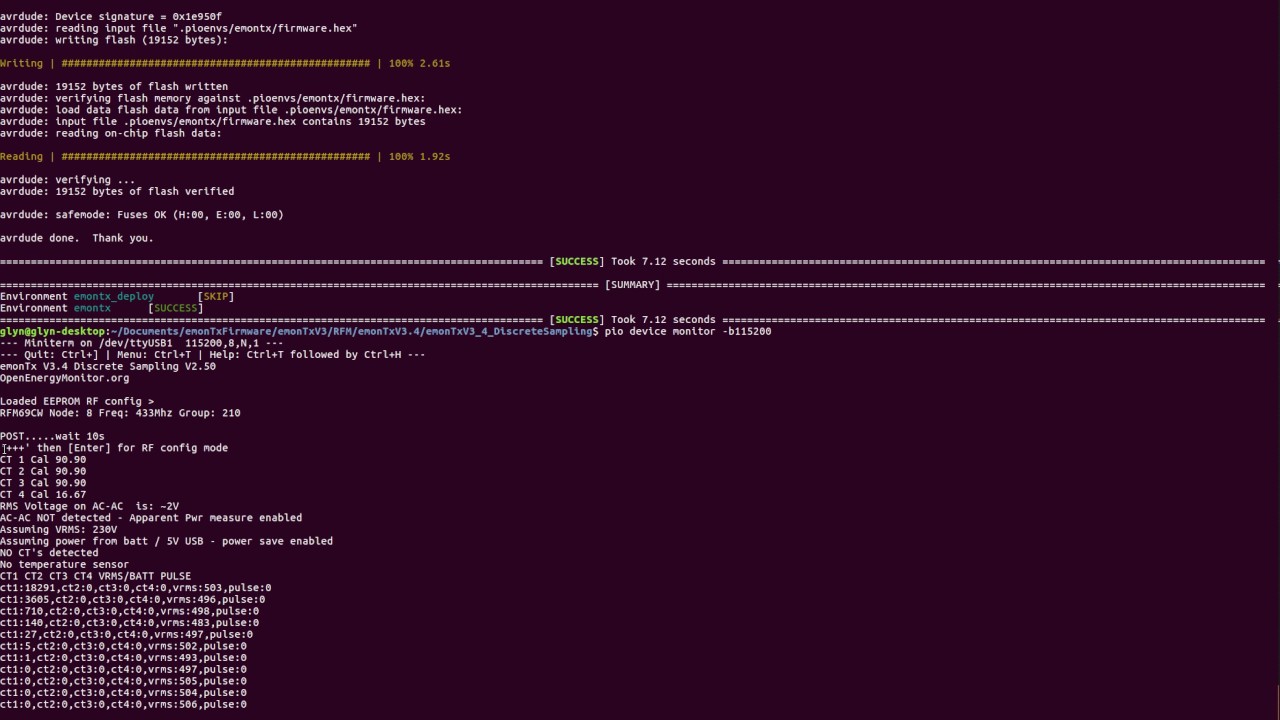

emonTx V3 firmware now allows the RF settings (nodeID, freq, group) to be configured via serial. Settings are saved to EEPROM and persistent between power cycles.
Update: these changes have now been released FW V:2.6+
Enter ‘+++’ then [Enter] during the POST (Power-On Self-Test) 10s delay during startup to enter config:
Note: Ensure serial monitor is set to NL/CR and the Baud Rate set to 115200*. Arduino IDE serial monitor may need to be restarted after changing the line ending selection.
*115200 is the baud rate used most often by current OpenEnergyMonitor units: emonTH, emonTx, etc. If you see strange characters appear on the serial monitor, the first thing to try is to use a different baud rate.
emonTx V3.4 Discrete Sampling V2.60
OpenEnergyMonitor.org
No EEPROM config
RFM69CW Node: 8 Freq: 433Mhz Group: 210
POST.....wait 10s
'+++' then [Enter] for RF config mode

Screen cast demo:
See emonTx V3 repo: GitHub - openenergymonitor/emontx3: EmonTx V3.4.x Hardware and older discreet firmware, see EmonTxV3CM repo for latest

I have now received my serial programmer from the shop and found this thread to add an additional emonTX unit to the emonbase. I have downloaded the Arduino IDE and FTDI drivers etc.
How do I enter serial mode as in the video above. Really new to the arduino stuff and cant work it out as scared to wreak havoc on my EmoNTX.

Plug the programmer into the emonTx (See the new pages in ‘Learn’ and get it the right way up) and into your computer. As you plug it in, it will power up (there’s no need for the a.c adapter or the c.t’s, but don’t unplug the c.t.'s if they’re on a live current-carrying circuit).
If you select “Serial Monitor” view in the IDE (the magnifying glass top right in the dark blue banner), you should see this:

You have 10 s to type +++ in the white box across the top, and hit the Enter key. If you miss or aren’t quick enough, close the serial monitor and open it again - that restarts your emonTx.
When you do that, you’ll get a menu. Note there’s an escape route: r will reset it to the factory (the sketch’s) default.
If you x exit config mode but don’t s save the changes, it will use the new settings until you restart it, when it will revert to what you had before.
