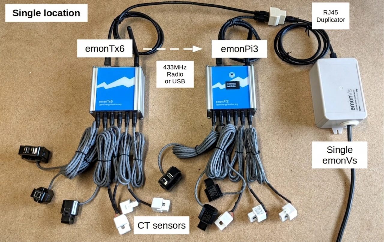

## emonTx6
- Wireless expander node
- Expand an emonPi3 system with an additional 6-channels of AC electricity monitoring (single & 3-phase)

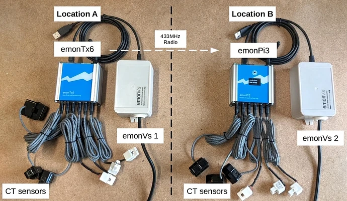

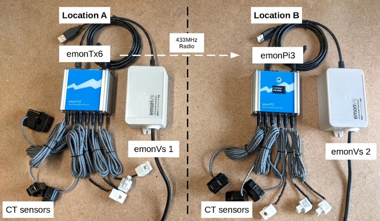

- Either share a single emonVS voltage sensing power supply with an emonPi3 using a [splitter](https://shop.openenergymonitor.com/emonvs-rj45-duplicator/?searchid=54557&search_query=RJ45) or use a 2nd emonVS if emonTx is in different location
- Transmit data to emonPi3 via 433.92 MHz wireless or direct USB connection
- Support for multiple [wired DS18B20 sensors](https://shop.openenergymonitor.com/encapsulated-ds18b20-temperature-sensor-3m/)
- [ESP Home Integration](https://esphome.io/components/sensor/emontx/) with Home Assistant\*\* thanks to @FredM67
\*\* emonWiFi hardware coming soon to support easy ESP Home HA Integration.
 ![emonTx6emonPi3_67609](https://community.openenergymonitor.org/uploads/default/original/3X/1/7/1718e2203c708174a8f892afe9b35cba83d6b408.webp)
 ![emonTx6emonPi3-setup2_10428](https://community.openenergymonitor.org/uploads/default/original/3X/6/a/6aa8d882fedc7223fcce30b53937a5c423f109a3.webp)

To note, the emonTx6 will work as a standalone device with the emonWiFi board or even directly connected to a suitable device by USB to read the serial data (e.g. using `emonhub`).
Whilst the emonWiFi will utilise ESPHome for its firmware, there is no requirement to have or use Home Assistant. The emonTx6/emonWiFi combo can communicate with any suitable HTTP or MQTT endpoint as well as Home Assistant. These endpoints can all be used simultaneously in any combination.
