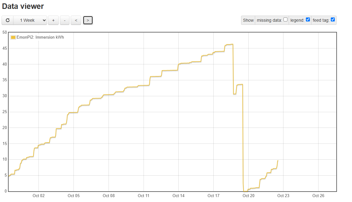

On my new EmonPi2, I was under the impression that the E1 to E6 input values contain the total energy (Watt-Hours) read from the 6 CT inputs, and that the firmware contained logic to preserve these in non-volatile storage?

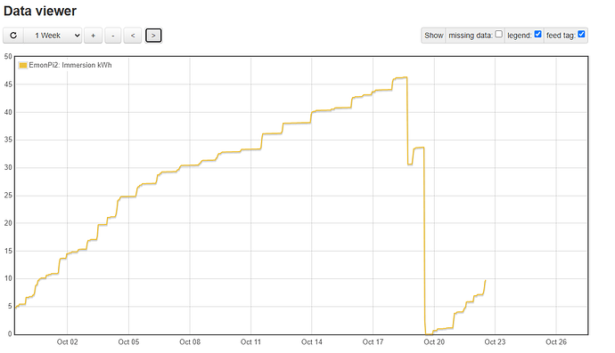

If that is the case, then how come my feeds based on these inputs suddenly dropped? Here is the total kWh reading for my immersion heater for example:

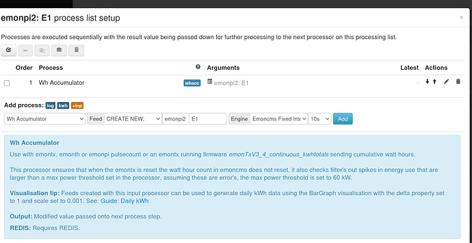

The input processing from the E3 input is a simple multiple by 0.001 and log to feed:
I did reboot the Pi a few times, including pulling the power. Could that explain it?

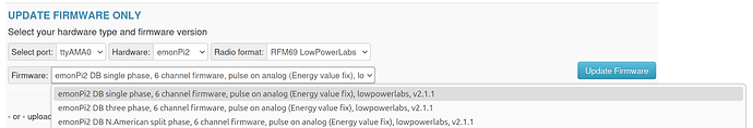

Hello @Martin_Robinson apologies, I had not appreciated that this was an issue. I have now tracked it down to an error in the emon_DB_6CT sketch itself and have pushed a fix to the firmware repository.
Next I will issue new pre-compiled firmwares and will update this thread again once I’ve done that.
