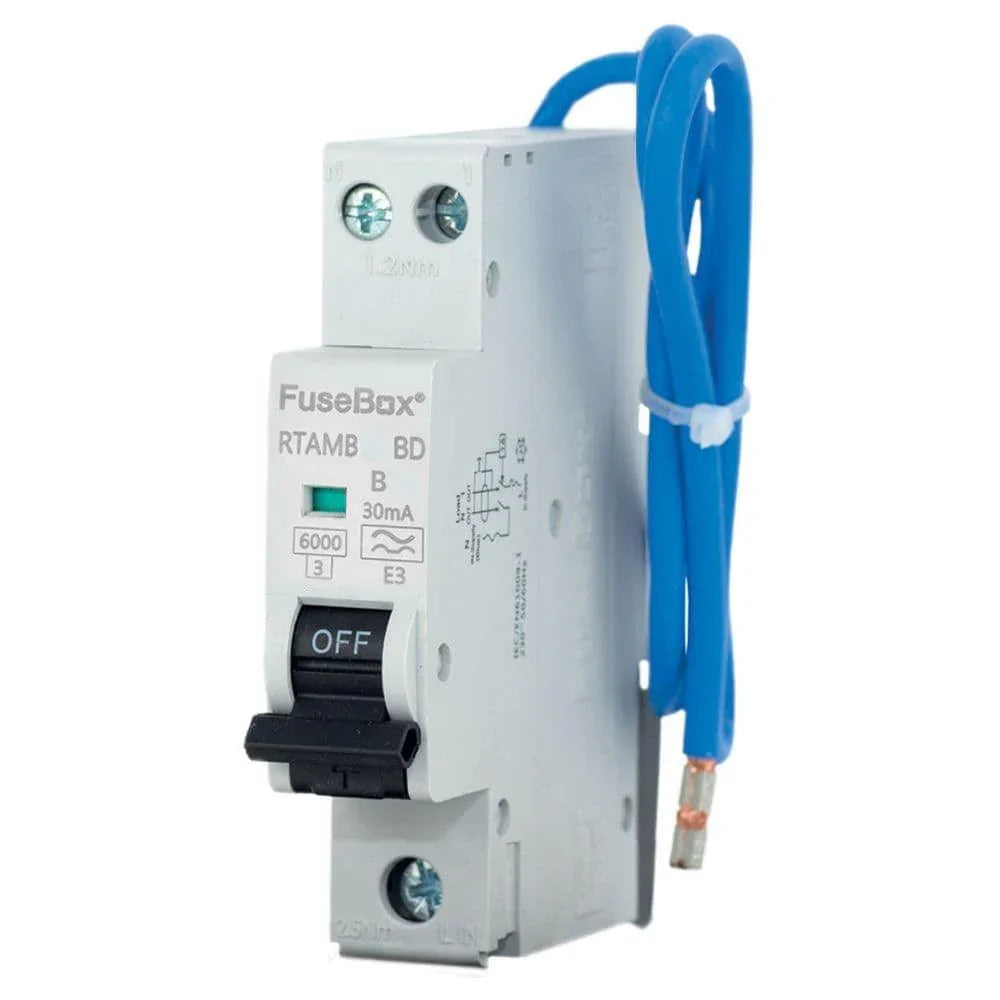

> [@glyn.hudson](#):
> All the breakers in my new box are RCBOs, note the little ‘T’ test button at the bottom of each breaker.
Well, that’d be very expensive. Plus I’d need at least twice the size of my board!
I’ve to take a look, never seen such element in France… And they are taking only one unit!
Is that not overkill?
As you can see, I’ve a main 30mA, and for each group another one. From time to time, it can happen that both a sub-30mA and the main trigger.
I’ve already tested, they trigger mostly around 20-25mA.
**Post date:** [28 May 2026 15:35 UTC](https://community.openenergymonitor.org/t/emonpi-installation-showcase/30019/22 "2026-05-28T15:35:00Z")
> [@FredM67](#):
A Type-A RCBO are only about £10-£20 (17 - 23 EUR), they take up a single module so you would actually gain space in your board since you wouldn’t need to the double module RCDs. They used to be expensive, but they have come down in price a lot.
> **[FuseBox RTAMB06 Mini RCBO 6amp Type A - B Curve 2 Pole](https://www.consumerunitworld.co.uk/products/fusebox-rtamb06bd-6a-bi-directional-rcbo-b-curve-30ma-6ka-type-a)**
> Shop for the FuseBox RTAMB06 Mini RCBO 6amp Type A - B Curve 2 Pole. Order online from Consumer Unit World.
> [@FredM67](#):
The main advantage of RCBOs is if there is a residual current fault on a particular circuit only that circuit will trip, it make it easy to identify the circuit with the fault and avoids power loss to other circuits. It’s also an advantage to avoid nuisance tripping due to accumulative leakage from DC-DC converters etc since each circuit has 30mA to play with rather than 30mA split between several circuits.
**Author:** ![FredM67](https://community.openenergymonitor.org/user_avatar/community.openenergymonitor.org/fredm67/32/10706_2.png) [@FredM67](https://community.openenergymonitor.org/u/FredM67)\
**Post date:** [28 May 2026 17:04 UTC](https://community.openenergymonitor.org/t/emonpi-installation-showcase/30019/23 "2026-05-28T17:04:25Z")
I’ll have to search for that if it’s available in France…

> [@glyn.hudson](#):
What do people do to notice when a single RCBO trips? When a “whole board” RCD trips it’s easy to notice because everything goes dark. But if only the RCBO on the Freezer trips…
**Post date:** [28 May 2026 23:25 UTC](https://community.openenergymonitor.org/t/emonpi-installation-showcase/30019/26 "2026-05-28T23:25:39Z")
> [@dmajwool](#):
Sure, that’s a drawback too!
There’s no perfect solution, except you’ve unlimited budget to wire the installation like in the industry.
**Post date:** [28 May 2026 23:41 UTC](https://community.openenergymonitor.org/t/emonpi-installation-showcase/30019/27 "2026-05-28T23:41:08Z")
Auxiliary alarm contacts to fit an RCBO exist, e.g. [https://www.se.com/au/en/product/A9A19802/acti9-ic60-rcbo-auxiliary-contact-1sd-ac-dc/](https://www.se.com/au/en/product/A9A19802/acti9-ic60-rcbo-auxiliary-contact-1sd-ac-dc/)
This could be used singly or together with others to sound an alarm when one or more RCBO in the installation has tripped.
**Post date:** [29 May 2026 13:58 UTC](https://community.openenergymonitor.org/t/emonpi-installation-showcase/30019/28 "2026-05-29T13:58:41Z")
> [@dmajwool](#):
I guess it would be unusual for a freezer to have its own circuit, there would usually be other things plugged into the same radial that would make it obvious that it’s tripped. There is definitely an argument not to put smoke alarms on their own circuit for this reason, putting smoke alarms on the bedroom light circuit makes sense to me.

> [@Robert.Wall](#):
Thanks @Robert.Wall I haven’t understood the product information on that link. Does this device have some simple relay contacts that change state when the RCBO trips, or is it more complicated with some serial data output that needs to be decoded?
**Post date:** [5 June 2026 14:19 UTC](https://community.openenergymonitor.org/t/emonpi-installation-showcase/30019/36 "2026-06-05T14:19:57Z")
The link was an example - you need to go to the manufacturer of the RCBO that you have, and see if they have auxiliary alarm contacts for your RCBO, and see how they fit. If it takes up 1 position, you could be looking at replacing your consumer unit, which would be expensive.
I think you can be reasonably certain that one make of aux contacts won’t fit another make of RCBO.
The Schneider one has changeover contacts (if you look carefully at the image - on the side is a diagram - also in the instructions), and the moving contact will be mechanically connected to the actuating lever of the RCBO, so you can have the contacts open when the RCBO is normal, and closed when the RCBO is tripped, or vice versa. They are without doubt real metallic contacts, though looking at the installation instructions, there is a version that does send data (and without doubt it will be in a proprietary format 😭 ).
**Author:** ![dmajwool](https://community.openenergymonitor.org/letter_avatar_proxy/v4/letter/d/7ba0ec/32.png) [@dmajwool](https://community.openenergymonitor.org/u/dmajwool)\
**Post date:** [5 June 2026 15:05 UTC](https://community.openenergymonitor.org/t/emonpi-installation-showcase/30019/37 "2026-06-05T15:05:28Z")
Thanks @Robert.Wall : A dry “relay” sounds good news and potentially easy ish to integrate into my existing Victron kit which has some alarm signalling capability 🙂
**Post date:** [5 June 2026 15:33 UTC](https://community.openenergymonitor.org/t/emonpi-installation-showcase/30019/38 "2026-06-05T15:33:08Z")
The simplest would be a 6 V battery and a bell or buzzer!
But make sure whatever you get is compatible with your existing kit, unless of course you are replacing it.
