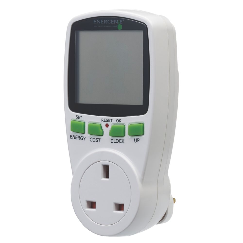

I have one of these plug in energy monitors.
> **[Energenie ENER007 Energy Saving Power Meter Socket - Screwfix](https://www.screwfix.com/p/energenie-ener007-energy-saving-power-meter-socket/3477H?kpid=3477H&ds_kid=92700024377676994&ds_rl=1249401&ds_rl=1241687&ds_rl=1245250&ds_rl=1248181&ds_rl=1245250&ds_rl=1249484&gclid=Cj0KCQjw08XeBRC0ARIsAP_gaQDNGcpFxTt8RKxVG8A4dUoK2Fy223YVtGeLPCWkqsAVE6Qhy_ZeOy4aArGBEALw_wcB&gclsrc=aw.ds)**
> Order online at Screwfix.com. Monitor and measure the energy use and costs of running household appliances. Simply plug into a powered mains socket and then plug any 13A rated appliance in. Discover which appliances use most energy, helping you lower...
I can’t vouch for its pure accuracy but maybe it could help? That webpage suggests +/- 2%?

Being honest, creating test rigs from wires seems beyond what i’d consider safe for me to try as i’m no electrician. So I think that could be out of the window.
I’d be happy to try a straightforward kitchen table test with a heater/kettle plugged into the socket power meter connected to the CT. I suppose i’m looking to see if the socket power meter matches/get close to emonPi reading through the CT? Then adjust item 1?
Although i’m not sure how I can check voltage? The socket power meter thing only shows watts currently used, nothing about voltage. The only voltage figure i’d see is from the emonPi, so not sure what i’d be checking that against? Is that where the multimeter would come in?

Not really. You could “cannibalise” an existing extension lead, but that’s probably **less** safe as you might cut into the insulation of one of the cores while removing the outer sheath.
Most energy monitors do show the voltage if asked, check your instruction leaflet.
I assume Alexander means “current” when he writes “intensity”. That does not apply to you because you are adjusting the power calibration long after Ical (which he mentions) has been applied. Ical is not available to you as that is inside the sketch in the Atmel328 part of the emonPi, and it is easy to lose that sketch for the reasons I gave in post no.2. What he writes is mainly applicable only to the emonTx and Arduino.
> [@Zarch](#):
You don’t _need_ the voltage to read power accurately. It’s not normally used in the calculations inside emonhub or in emonCMS. So if you can’t get the voltage out of your power meter, forget it.
_[Edit edited] ~~I’ve looked at the instructions and indeed, there’s no mention of a voltage display, so either wait until it’s installed and use your PV instrumentation, or just forget about calibrating the voltage.~~
I lied. I didn’t spot this:_
• ENERGY: Pressing the energy button will cause the display row to cycle through
instantaneous values of overload power » power » **voltage** » frequency » current »
power factor » max power » min power
> [@Zarch](#):
Exactly. And you can do both c.t’s at the same time. The test rig is needed to get access to a single wire to put the c.t. on. You can’t put it over a 3-core mains lead, it will read zero (or very nearly), always. The only way out of that, and it’s not really practical, is to put the c.t. on the cable out of your meter, and switch off everything else in the house while you do it.

 ![IMG_1595](https://community.openenergymonitor.org/uploads/default/original/2X/7/7b799c3a0483e69f61a30a12ff1f6c5a361376df.jpeg)
I was only able to test 1 clamp as the other is attached where I didn’t want to disturb, but test worked out ok.
If you remember, the other clamp (Solar) was always showing around 7% down on my Generation Meter at the end of each day.
So i’m not sure if I was surprised or not, but the energy display meter instantly showed around 6/7% higher than what was being shown from the emonPi on the first test.
In a way I was happy that two independent sources show a 7% difference.
I updated the values in the config file for both power1 and power2 to 1.06
Re ran the test by putting the toaster on and the figures were there or thereabouts.
So i’m happier now. I just need to monitor the results out of emonPi against the generation meter and the electricity export meter. After all, these are the two things that money is earned and charged against. I can always tweak slightly based on future results.
