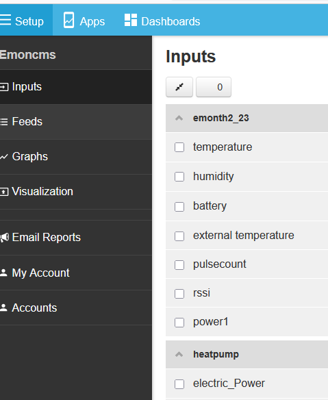

i set things up about a year ago, got some readings from linking in through qr code. i’m trying to set up wi-fi as i now have wi-fi close enough to get a signal. there is no data logged from jun 24. there is no admin section either.
help please, but try to keep it simple!

If you are trying to set up Wi-Fi, how did you get that screenshot?
What equipment do you have?
Is your emonCMS running on an emonPi or something else? and is that emonPi actually a Heatpump Monitor?
Before June 24th, you imply you were getting data? Where from? And how? What has stopped? What did you change to stop it?
Is there any movement on the emonCMS Inputs page?
If you can provide us with more information, it will make it a lot easier for someone to help you.
thanks for the reply Robert, it’s a heat pump monitor, i fitted and set it up about a year ago but with no wi-fi just left it to run. i got the screenshot by logging into emoncms.org which i had done previously, can’t remember how i got the stats online now though it may have been a remote access and upload . nothing has changed since initial set up. i do remember looking at the parameters for putting all the details as public regarding the make, type and all the other requirements and thought i would come back to that part!
Do you really mean the on-line version of emonCMS, and not your local emonCMS? If that is the case, you must be using either Wi-Fi or a fixed Ethernet connection into your router. Can you confirm please.

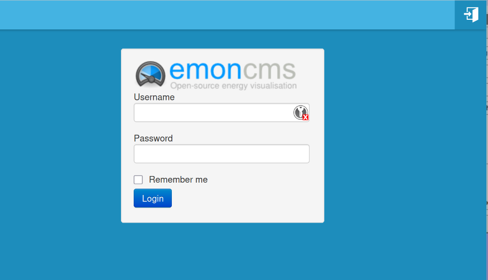

You need to know its IP address - your router should be able to tell you. If you log in to your router’s Admin page, you should have a page that lists the devices that are connected, they might have addresses like 192.168.1.65 If there is one, try to log in to it using a laptop or phone. You should see a login screen like this
The bad news is, it will need the username and password you set a year ago. Report how far you get with this, and we’ll take it from there. Those might be on the printed sheet that came with your Heatpump Monitor.
nothing showing up on router, have logged into webpage and there is no way to sign wi-fi in as per previous screenshot
