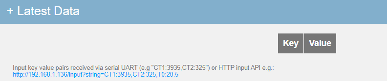

I’d appreciate some troubleshooting help please!
I have successfully flashed a Huzza ESP8266
It is connected to the EmonTX as per the guidelines (RX on Huzza to RX on EmonTX)
It is powered, and connected to my wifi
2 Problems:
  1. It will not show any values under latest data in EmonESP
  2. it will not connect to emoncms (local) (
EmonTX info:
The EmonTX is a V3.4
Firmware is RF12demo.12

Are you sure you’ve got the correct pads on the Huzzah module? I can’t see properly for the plastic (strain relief?) moulding, but it looks to me as if the green wire - data out of the emonTx on the (wrongly labelled) Rx pin is actually going to V+, and the Brown (+5 V from the emonTx) is going to the unlabelled pin between GND & V+.
I have double checked this morning - and taken some better pictures for my own benefit.
Back - definitely going to GND
Orange - definitely going to V+
Green - definitely going to RX
Sorry about the moulding - that is just my way of avoiding soldering as I have a 3d printer :slight_smile:
Do you have a programmer - can you connect that instead of the Huzzah? You should see output on the Arduino IDE.

I only connected RX and TX from my usb to serial thingy and via putty (windows) I get nothing from the EmonTX.
If I connect to serial via rfm over my pi, I can type commands. Note it says it is on firmware “RF12demo.12” which would seem to be out of date? as per here: GitHub - openenergymonitor/EmonTxV3CM: EmonTxV3 Continuous Monitoring Firmware (Default shipped EmonTxV3 firmware)
Is the note in there where it says I need to type w0 to user serial still valid? Apologies if that is a dumb question, but I am/was reluctant to type a command like w0 without knowing whether I can get it back.
The picture below is the result of connecting to the EmonTX via serial (usb to serial connector) PUTTY at 38400 baud which is the same as the emonhub log file and serial reports.
emonhub-editconfig-2022.txt (8.2 KB)
In case it matters, I have also attached the emoncms ‘config’
Doing things the way I think you are trying to do them, emonHub does not come into the picture. The data from the ESP8266 goes straight into emonCMS via Wi-Fi, your router and your LAN.
That is very clearly the wrong baud rate. Serial comms between the EmonTx and ESP8266 will be at 115200 baud. If you have not reloaded the sketch in the emonTx, and it is a recent acquisition, then the default sketch should indeed be the one it is running. You can read the source code to see the messages you should see when you power up (or reser) the emonTx. Do you see those when you use the correct baud rate?
When you do, you see messages that will help you interrogate the emonTx further.

Despite my best efforts I cannot get the EmonTX to communicate via the uart into Windows or EmonESP
Looking at the link to identify the radio I am 100% sure I have the The RFM12B - 433 MHz Option, this is my closeup photo:
I’d love to say I have this working, but despite double and triple checking I am not seeing anything on the serial monitor
I have tried putty
I have installed the Arduino IDE and used serial monitor (with the correct drivers installed)
Note: I am 100% sure the USB/serial converter works, because I programmed the Huzza with EmonESP that way.
A reminder that Rx and Tx on the emonTx are labelled “unconventionally” - the changeover is on the PCB, so Tx is looking for transmitted data and Rx is looking for something to receive the data.
What’s been puzzling me is the output that your emonPi appears to have received is consistent with the emonTx being a V3.2, yet you say - and this photo looks very much like - it’s a V3.4. If that is the sketch you have, there’s no means of setting or configuring it via the serial input. It predates that development.
Also, the serial output is at 9600 baud. Try that. If you get nothing or rubbish, try all the baud rates you have between 9600 and 115200 (I don’t think we’ve ever used anything outside that range). If you get something, sensible or otherwise, on any one, you have Tx and Rx the right way round. If you get nothing on every baud rate you can try swapping Rx and Tx.
Also, the sketch for the V3.2 doesn’t have the correct output for the Huzzah software to interpret, so this could explain why you have nothing via that route. I can find or convert a sketch that will send the right output if needs be.

Success when configured at 9600 baud:
emonTx V3 DS V1.4 RFM12B
13:39:30.206 -> OpenEnergyMonitor.org
13:39:30.254 -> POST.....wait 10s
13:39:43.534 -> CT 1 Calibration: 90.90
13:39:43.581 -> CT 2 Calibration: 90.90
13:39:43.581 -> CT 3 Calibration: 90.90
13:39:43.626 -> CT 4 Calibration: 16.67
13:39:44.575 -> RMS Voltage on AC-AC Adapter input is: ~3V
13:39:44.623 -> AC-AC adapter NOT detected - Apparent Power measurements enabled
13:39:44.717 -> Assuming VRMS to be 230V
13:39:44.717 -> Assuming powering from batteries / 5V USB - power saving mode enabled
13:39:44.812 -> CT 1 detected
13:39:44.812 -> Unable to detect DS18B20 temperature sensor
13:39:44.859 -> RFM12B Initiated:
13:39:44.907 -> Node: 10 Freq: 433Mhz Network: 210
13:39:46.652 -> 0
typing +++ then hitting SEND does not enter any config mode, but pressing anything immediately returns a value - so I guess that means RX/TX works
