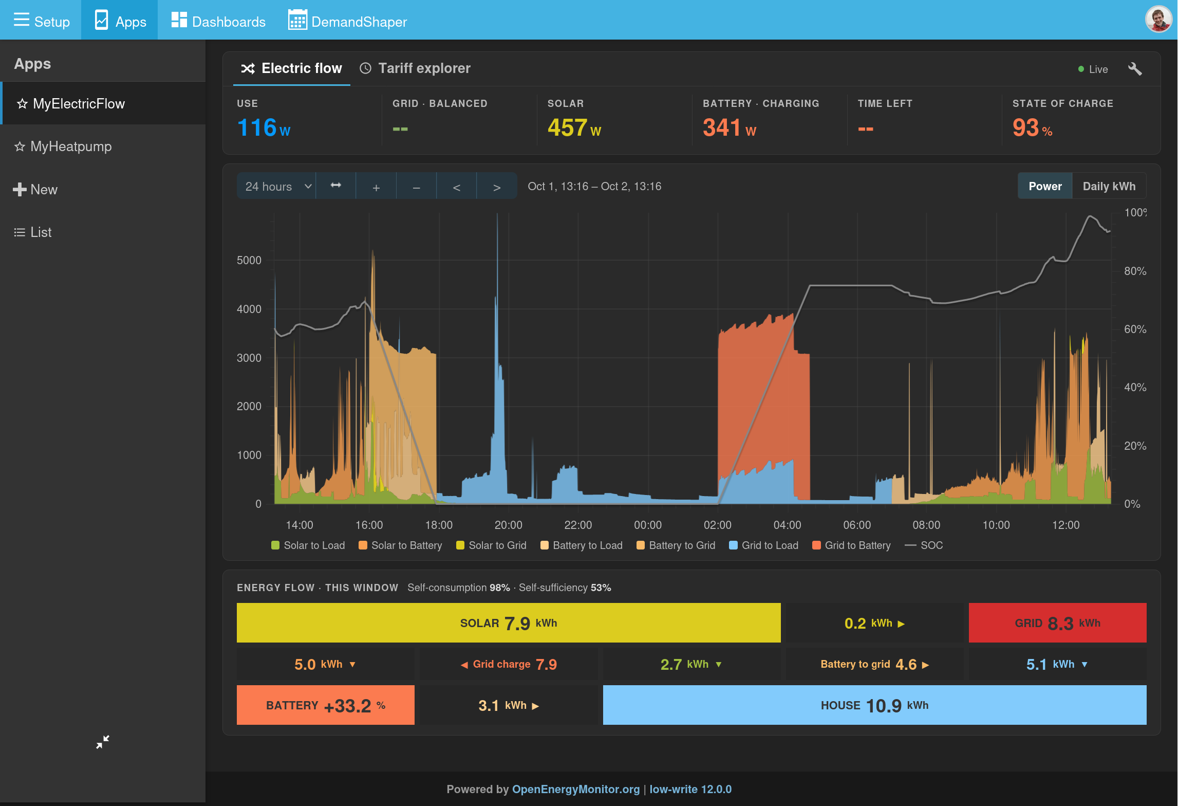

As part of this update we now have a refined MyElectricFlow app look:
 ![image](https://community.openenergymonitor.org/uploads/default/original/3X/5/8/58d49725007bd333fa4c5b8742b2145d645db3ff.png)

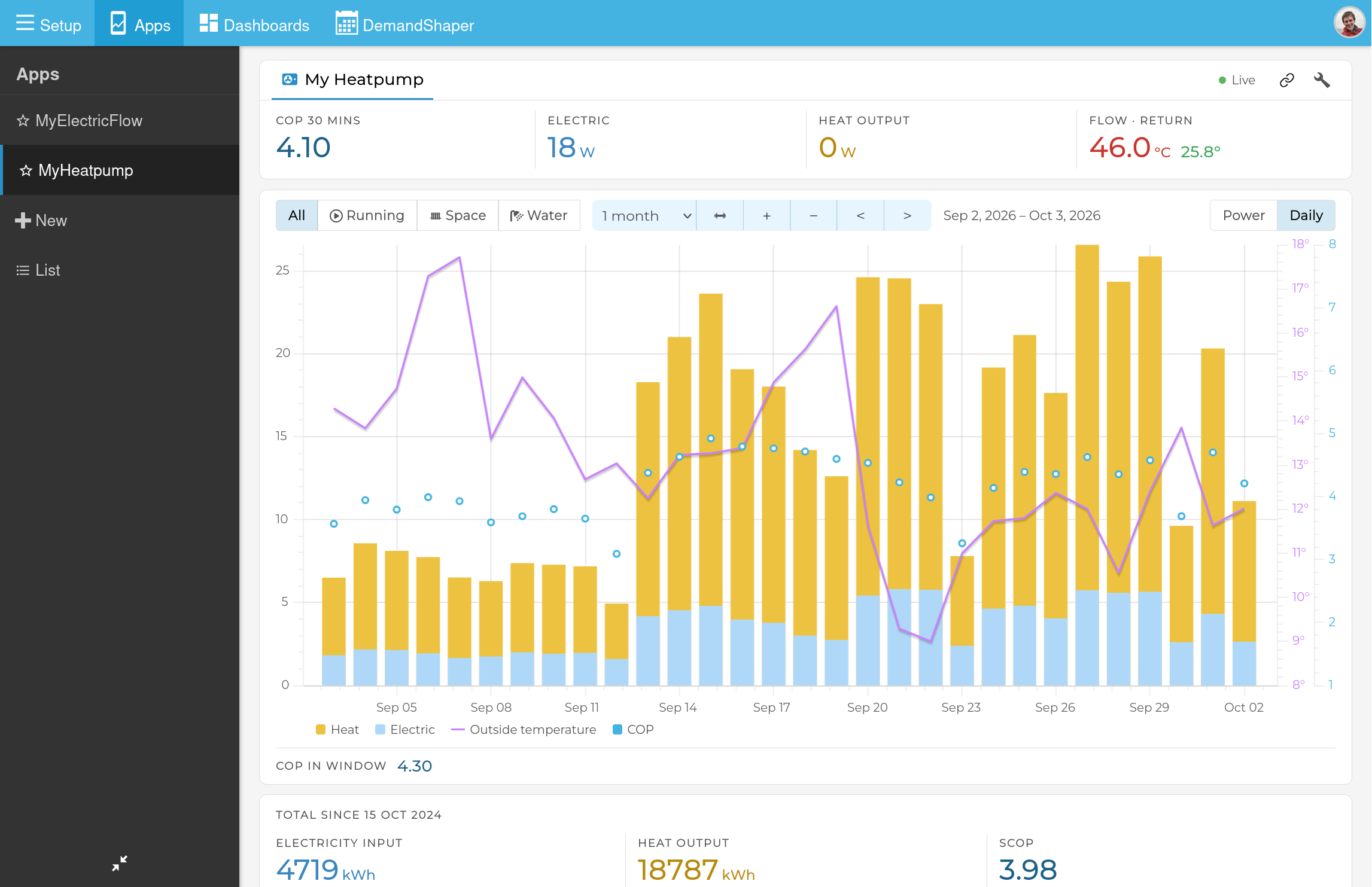

and a refreshed MyHeatpump app (both share a lot of the same layout and css now, MyElectricFlow is just the dark themed version and MyHeatpump is the light themed version of the same css):
 ![image](https://community.openenergymonitor.org/uploads/default/original/3X/6/a/6af68e5bad8c72d5ced8183f0f54a6adcb7464bb.png)

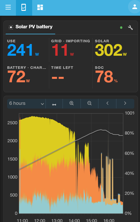

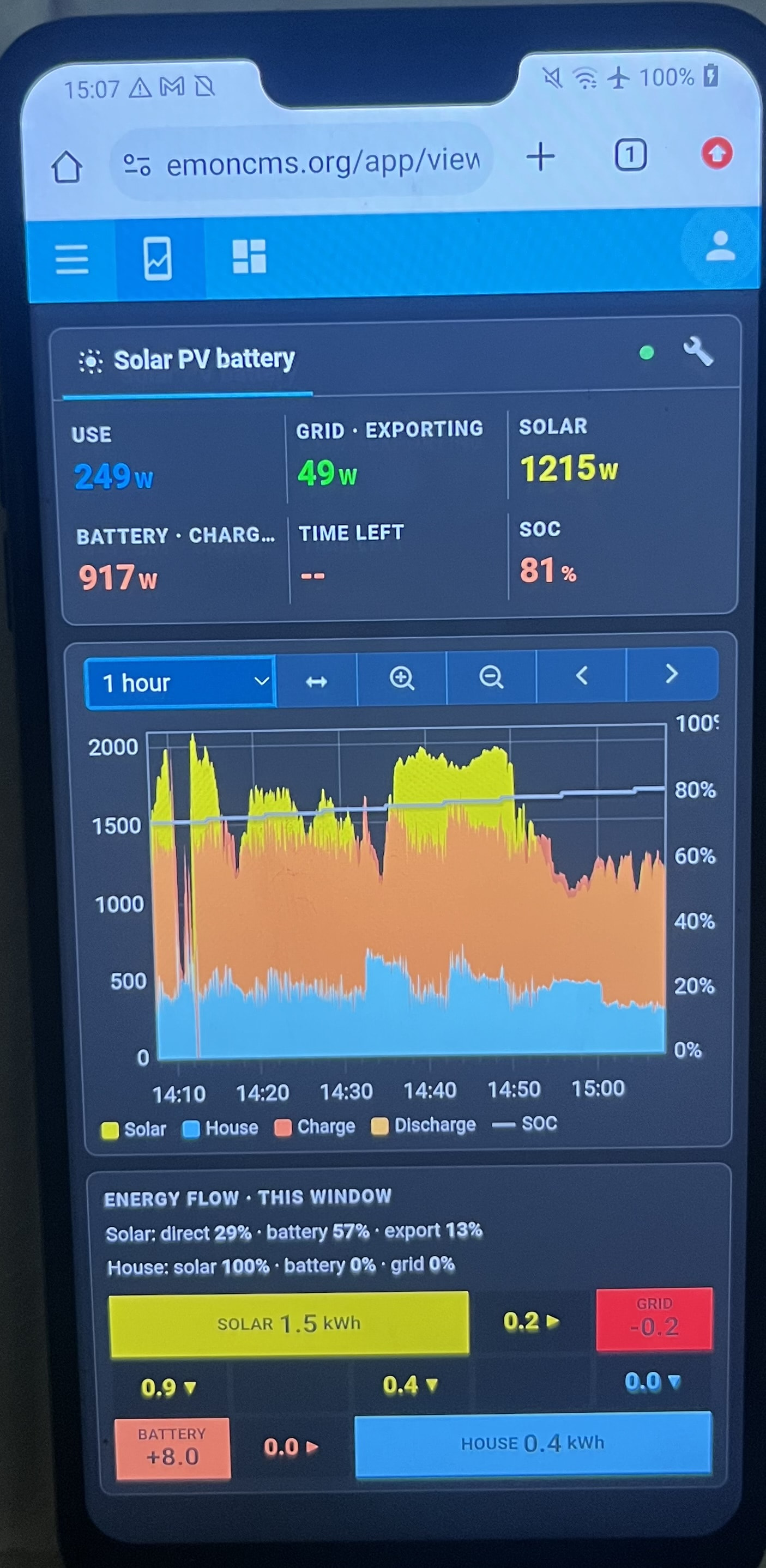

**Author:** ![Umski](https://community.openenergymonitor.org/letter_avatar_proxy/v4/letter/u/838e76/32.png) [@Umski](https://community.openenergymonitor.org/u/Umski)\
**Post date:** [8 October 2026 14:30 UTC](https://community.openenergymonitor.org/t/emoncms-v12-release-testing-feedback-welcome-now-on-emoncms-org/30399/6 "2026-10-08T14:30:26Z")
Thanks, I think the way the screen scaled before seemed to work pretty well - the headline values were the focus and if I needed to dive deeper I could hone in on the graph - if the values could be made much bigger than the titles I think that might solve the “screen estate” dilemma. Here’s a couple of screenshots - one from an iPhone mini which sits nicely from side to side and then the bottom is truncated - it’s always been like this but same very small values. The other is from the Android which while sits nicely within the screen but I can’t read the values at the top without getting really close (getting old 😉)
I think I’ve figured out the graph jumpiness - it’s when you touch the graph area - I don’t recall multi-touch or single touch doing this before, only showing a “spot value” - it’s behaving more like when using a mouse on desktop now with respect to selection, I think - so it could well be me accidentally touching the graph area causing the strange zooming effect of a window within the window as it were - I’ll keep an eye on that.
Contrast on the scales is much more readable now 👍
 ![IMG_9487](https://community.openenergymonitor.org/uploads/default/original/3X/d/4/d42f60f2c06cc73450b8671ccd88449ac081d5d5.jpeg)
 ![IMG_9488](https://community.openenergymonitor.org/uploads/default/original/3X/b/c/bcf3e0832cdb79c73ccfbf5788fabdd7d2b46b40.jpeg)
**Post date:** [8 October 2026 15:50 UTC](https://community.openenergymonitor.org/t/emoncms-v12-release-testing-feedback-welcome-now-on-emoncms-org/30399/7 "2026-10-08T15:50:29Z")
I couldn’t help but have a play in Firefox and using the Dev tools fiddled with the font size - I think this is the relevant tweak but there may be other places that I’m not aware of:
.app-live-value {
font-size: **48px** ;
font-weight: bold;
line-height: **42px** ;
white-space: nowrap;
Just upping the font to 48px and the line height to 42px seems to work well on the desktop in landscape and if I use the “responsive design mode” to toggle to a smaller phone view also seems to present okay when I change the following:

 ![image](https://community.openenergymonitor.org/uploads/default/original/3X/9/b/9b3b88d21a0f3e1101123cbde8fde74a49caab28.png)
Would that break anything else (I know the time left might get squished for longer periods!)

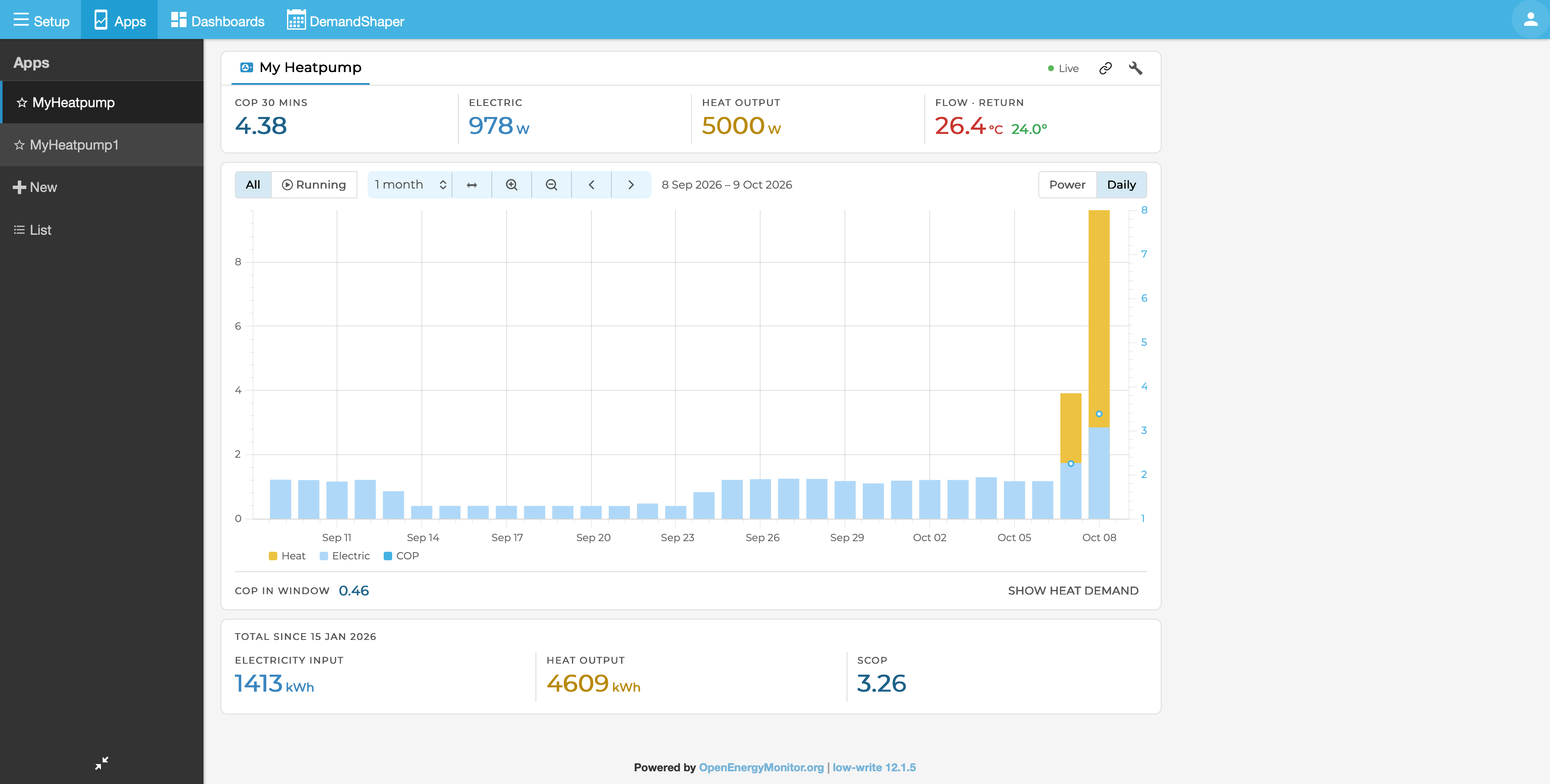

**Author:** ![dmhom](https://community.openenergymonitor.org/letter_avatar_proxy/v4/letter/d/7ab992/32.png) [@dmhom](https://community.openenergymonitor.org/u/dmhom)\
**Post date:** [8 October 2026 16:08 UTC](https://community.openenergymonitor.org/t/emoncms-v12-release-testing-feedback-welcome-now-on-emoncms-org/30399/8 "2026-10-08T16:08:31Z")
Great work. Did the upgrade and the ‘Components’ page is shown ( hope it looks ok ). Also the Apps page looks nice and clean.
 ![Emoncms - admin component](https://community.openenergymonitor.org/uploads/default/original/3X/a/2/a2ca2d058b22d5c437f388d6f27b0feae3f7e89a.webp)
 ![Emoncms - app view](https://community.openenergymonitor.org/uploads/default/original/3X/f/7/f7734782de03ead8e784551773a11e382e0c136a.png)

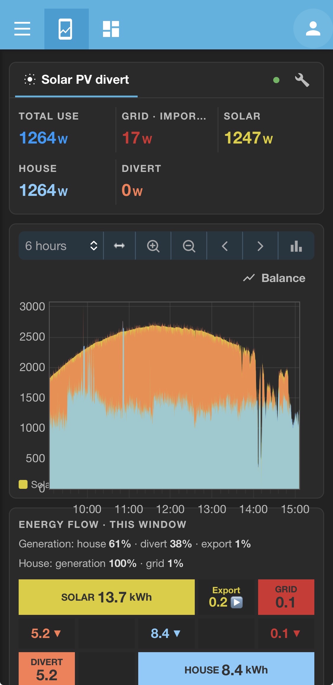

Fabulous 😀 - I should also have added that I also use MySolarDivert separately as PV diversion isn’t captured elsewhere 🫣 - it’s not as vital but good for consistency and visibility 👍
**Post date:** [13 October 2026 14:01 UTC](https://community.openenergymonitor.org/t/emoncms-v12-release-testing-feedback-welcome-now-on-emoncms-org/30399/19 "2026-10-13T14:01:04Z")
I’ve updated the MySolarPVBattery app, also includes a few other changes. E.g if you have cumulative kWh feeds zooming out is in power view is now much more accurate as it derives the average power values for the chart and totals from the cumulative kWh feed data. The daily mode also shows the total for the whole window in the energy flow boxes and hovering over the days shows a tooltip. This makes it more consistent with MyElectricFlow and MySolar.
I still haven’t made the changes to the divert app 👍
