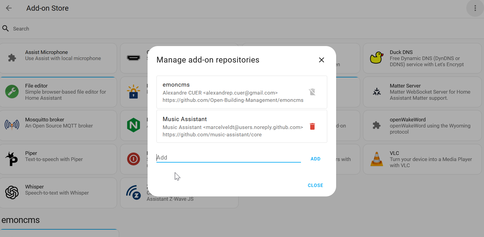

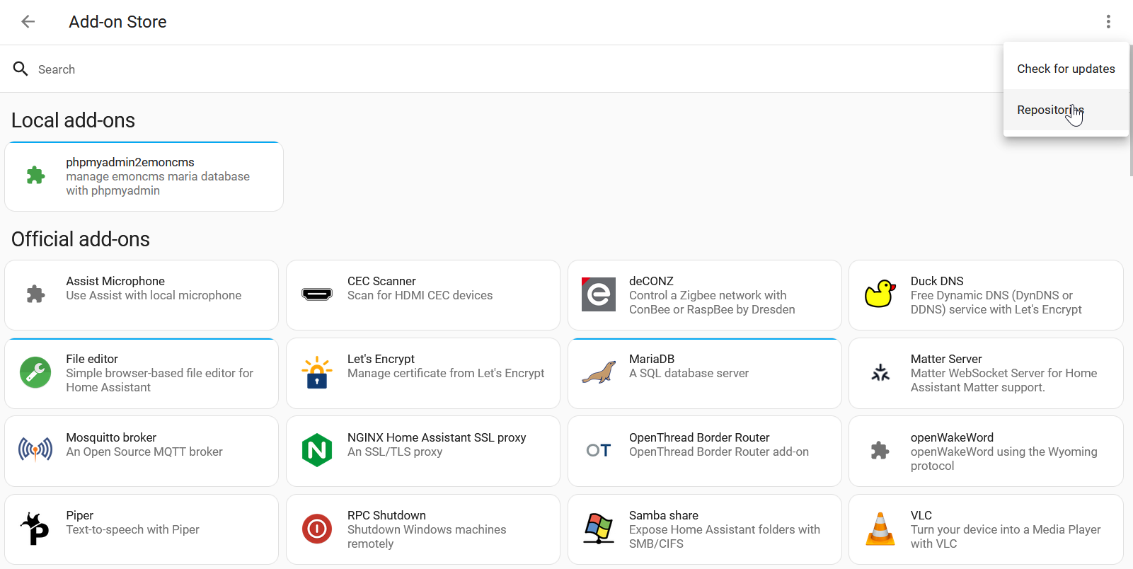

never add this problem. Did that message came after you added the url to the store ?
  1. click on ADD-ON STORE
  2. click on the three dots upper right and then on Repositories
  3. add the repo

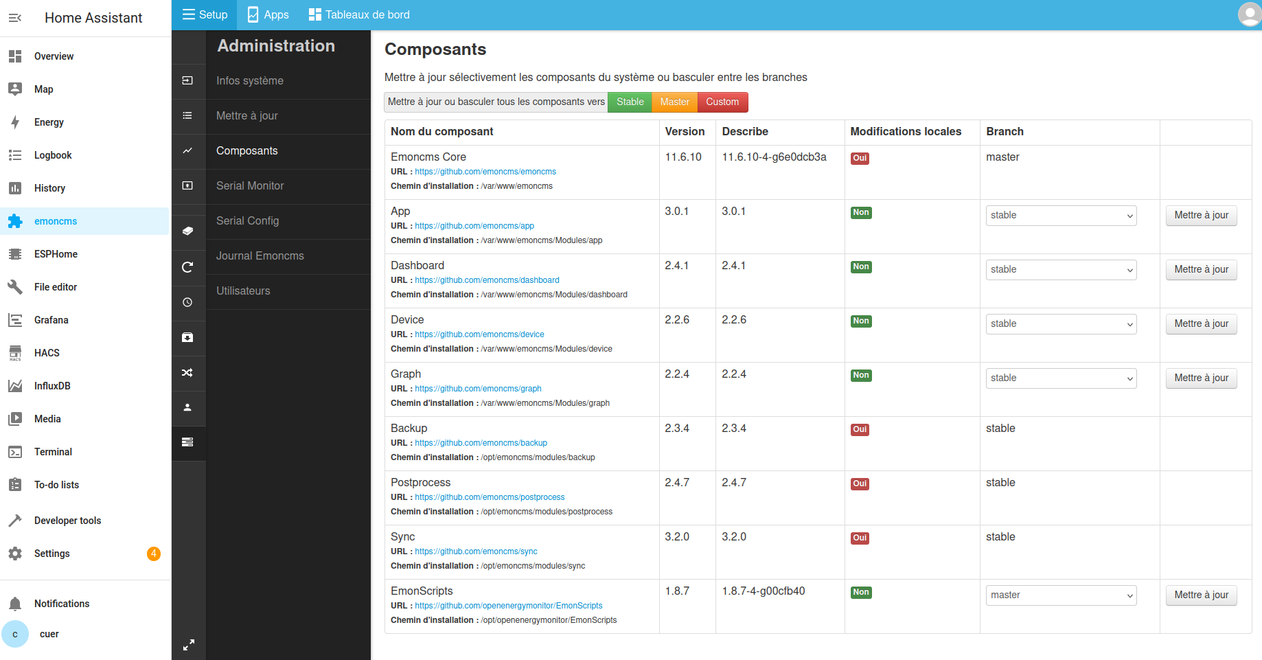

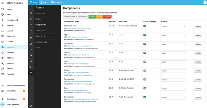

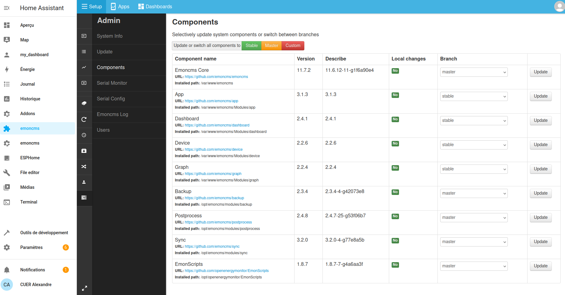

the home assistant addon has been updated.
you can now update the modules from the admin UI, whereas it was not possible before

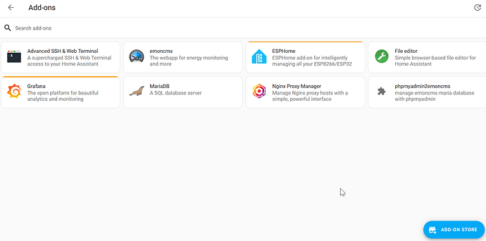

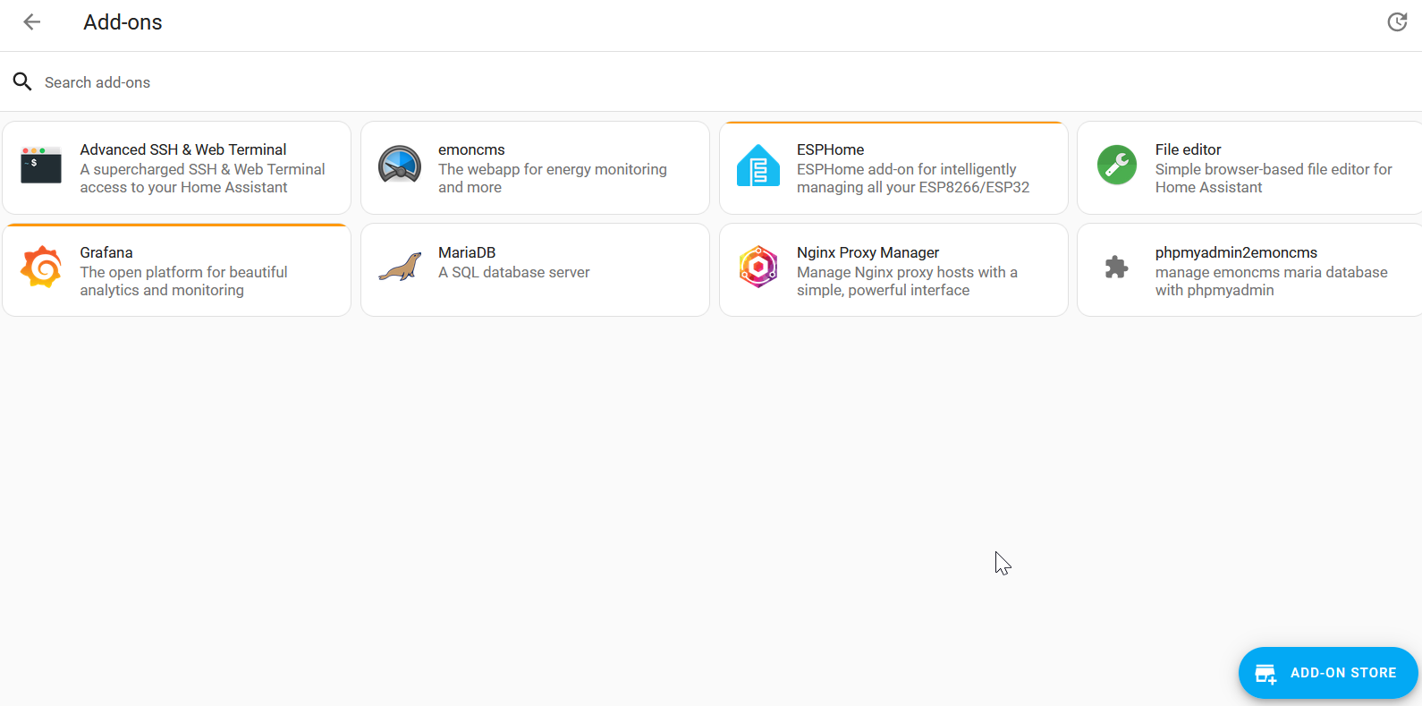

now :
before :
Good update, however, am I right that an update to the addon itself would bring in all the latest master (by default) branches of the modules?
This is therefore most useful if testing other branches etc?

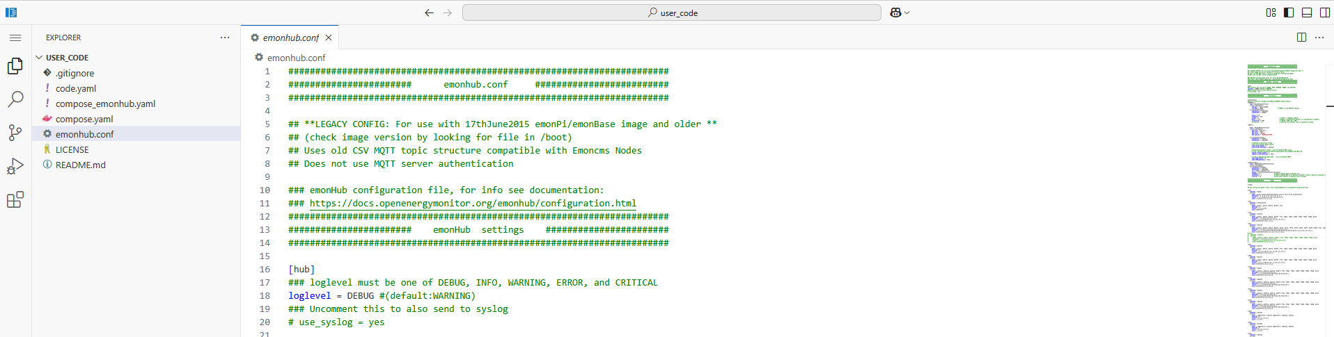

I’ve also updated the emonhub container with the last version.
I think even the bluetooth interfacer should be working (dont know if some of you are using it : emonhub/src/interfacers/EmonHubBleInterfacer.py at master · openenergymonitor/emonhub · GitHub)
Here you find a way to renovate for example an old emonpi1 with all new versions : GitHub - Open-Building-Management/compose-files: compose files to use with docker-compose
you can have emoncms + emonhub + code running even on a PI3 with only 3BG of RAM
