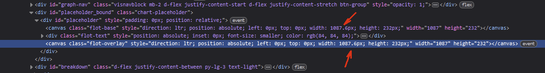

I’m trying to update an old EmonCMS installation to 11.6.10 using the alexjunk/emoncms docker image. All is working fine, I could import olr input, feeds, data, etc. However, the graphs of MySolar and MyElectric2 are blurry. It’s like I’d need glasses to look at them, it’s _very_ inconvenient. The old version (9.8.3) is perfectly crisp. As are the rest of the visual tools - the Visualization or the Graphs tools don’t exhibit this problem (among others), they’re as fine as in the old version.
After some digging, I noticed that in the HTML source the FlotChart canvas has 2 different sizes. One in the CSS and one in the surrounding element. The CSS one is 0.6px larger. This discrepancy seems to cause the blurriness. I’ve read on the net that in JQuery 3 the precision of certain functions changed to return fractions as well. This caused the issue in Flot which has been fixed. I see that JQ and its modules are very old, from 2017. I think it needs an update or at least a small fix for the old version.
I’m attaching 2 images, one where the +0.6px extra size exists, and one where it doesn’t (I hand-edited the HTML for the second image in the browser console). Even at this small size, the difference is quite apparent. I’m using latest Firefox.

**Post date:** [28 March 2025 20:36 UTC](https://community.openenergymonitor.org/t/emoncms-mysolar-myelectric2-blurry-graphs/28344/2 "2025-03-28T20:36:18Z")
Interesting, I had not noticed this and still cant quite tell the difference on e.g: [Emoncms - app view](https://emoncms.org/app/view?name=My+Solar&readkey=e24536fb68b132b864fa396d0de44da5)? Agreed that the library versions are old, there were some complexities with upgrading if I remember. Il make a note of this.
**Author:** ![kobuki](https://community.openenergymonitor.org/letter_avatar_proxy/v4/letter/k/dfb087/32.png) [@kobuki](https://community.openenergymonitor.org/u/kobuki)\
**Post date:** [28 March 2025 21:23 UTC](https://community.openenergymonitor.org/t/emoncms-mysolar-myelectric2-blurry-graphs/28344/3 "2025-03-28T21:23:03Z")
Yes, that view, for instance. But even though the weird CSS width values are there in your link, the view is not blurred. Weird. The difference is that on your link EmonCMS is version 11.6.0, whereas mine in the container is 11.6.10. Which is another weirdness, as the latest released version should be 11.6.9. Maybe the image maintainer is using an unreleased version?
