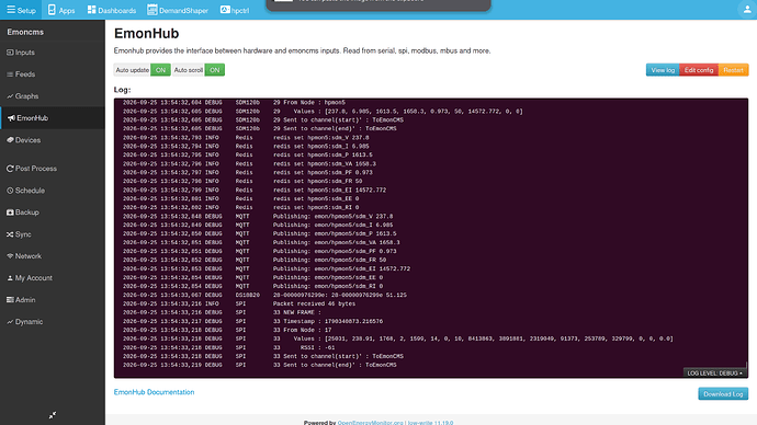

**Post date:** [25 September 2026 12:54 UTC](https://community.openenergymonitor.org/t/emoncms-keeps-stopping-with-recent-updates/30365/7 "2026-09-25T12:54:54Z")
Hello @RichardinCancale could you check this log:
 ![image](https://community.openenergymonitor.org/uploads/default/original/3X/c/4/c47861e4da008e67d9073f7d54f7f7efd6da4a1a.png)
Do you see activity streaming in on that?

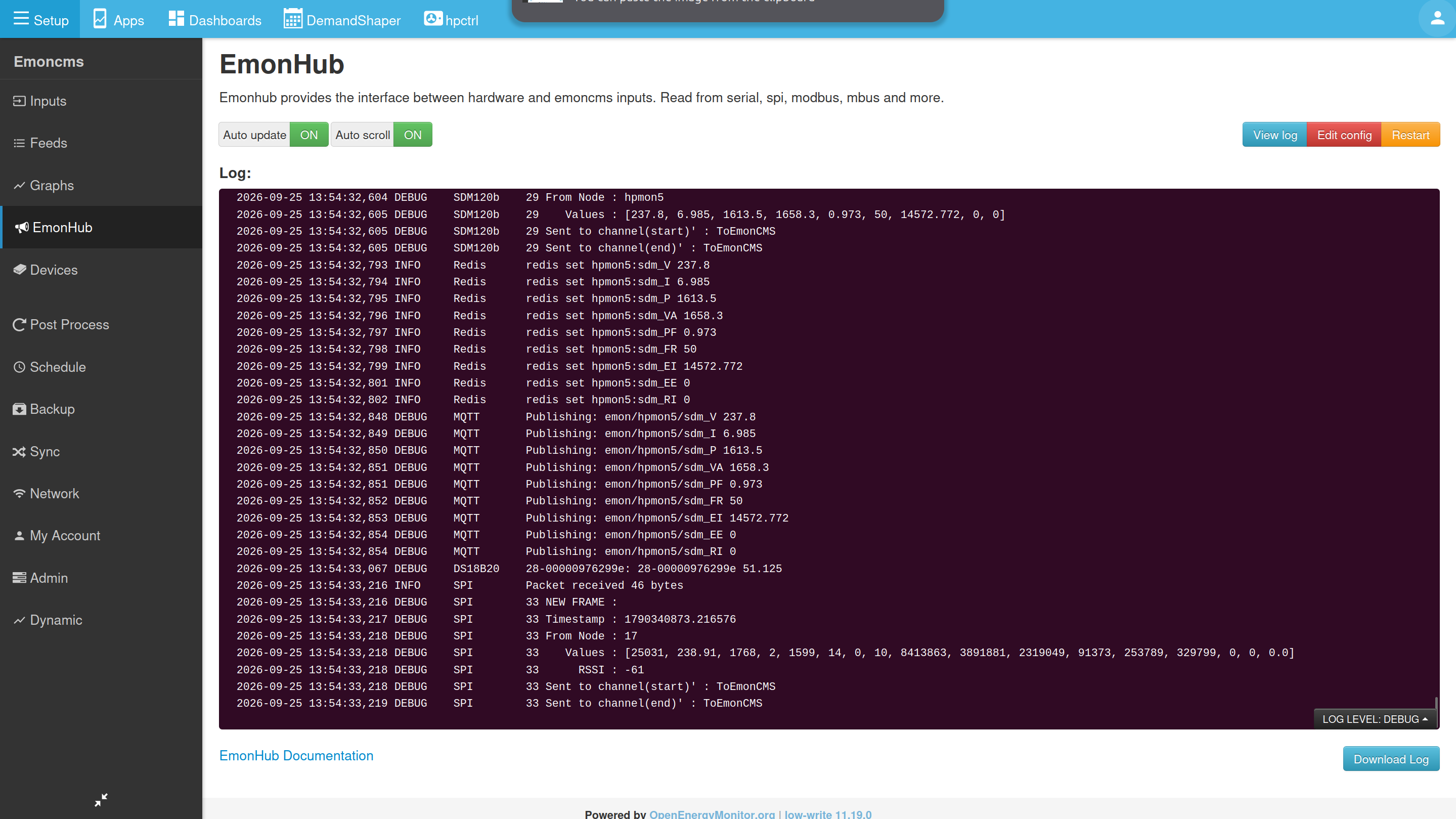

**Post date:** [25 September 2026 12:55 UTC](https://community.openenergymonitor.org/t/emoncms-keeps-stopping-with-recent-updates/30365/8 "2026-09-25T12:55:32Z")
and also what do you see here:
 ![image](https://community.openenergymonitor.org/uploads/default/original/3X/1/6/165c4eaf3082e55bc5460ad62ae5d54e89b118ca.png)
**Author:** ![RichardinCancale](https://community.openenergymonitor.org/letter_avatar_proxy/v4/letter/r/df705f/32.png) [@RichardinCancale](https://community.openenergymonitor.org/u/RichardinCancale)\
**Post date:** [25 September 2026 13:09 UTC](https://community.openenergymonitor.org/t/emoncms-keeps-stopping-with-recent-updates/30365/9 "2026-09-25T13:09:59Z")
Sorry but I rebooted this afternoon - if/when it bugs again I will capture this log.

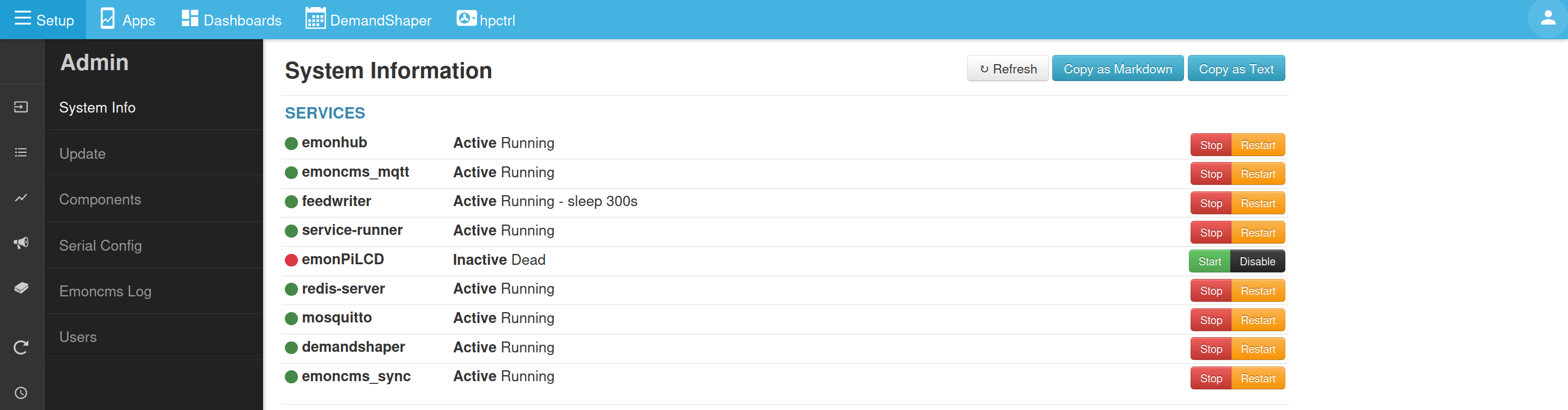

**Post date:** [25 September 2026 13:12 UTC](https://community.openenergymonitor.org/t/emoncms-keeps-stopping-with-recent-updates/30365/10 "2026-09-25T13:12:15Z")
For the list of tasks I see them all running (ie red Stop button is available) except the LCD task is running and the Demand Shaper is “not found or not installed”
