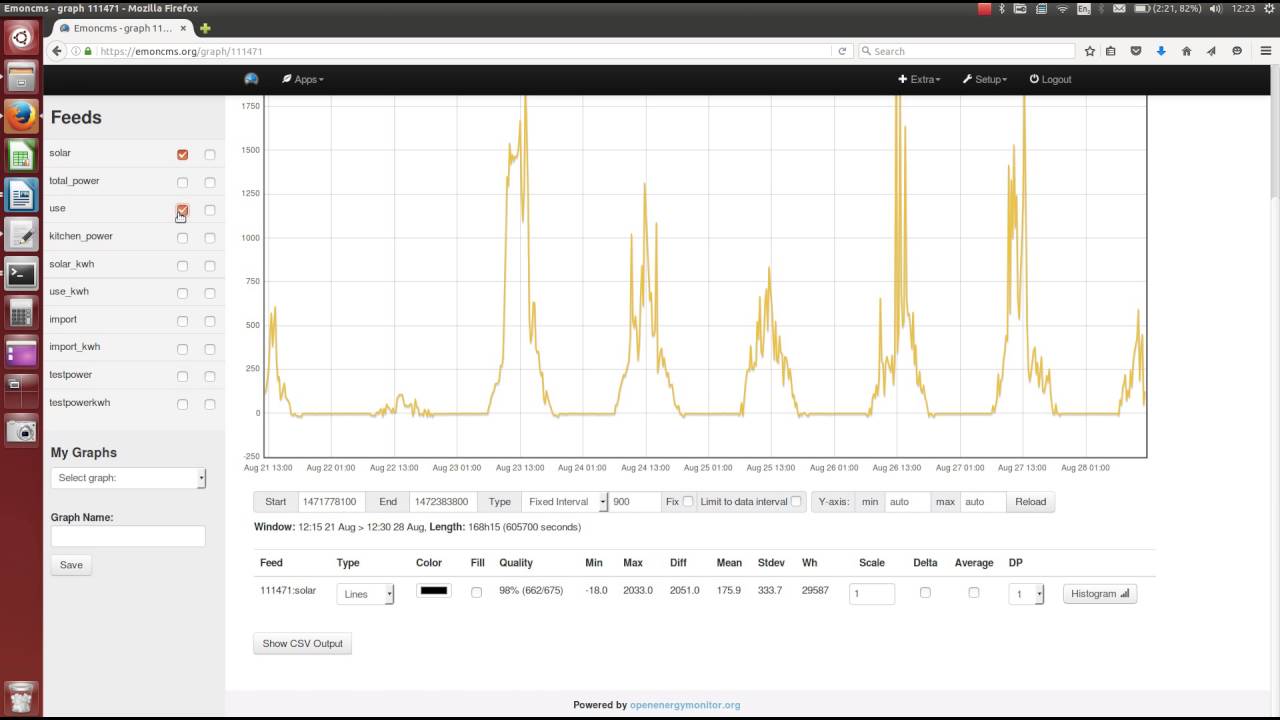

I’ve done a little more work on the emoncms graph module, also known as the data viewer accessible from the feeds list page. The main additions are:
- Ability to save graphs and embed these in dashboards
- Settable plot colour and fill
- Tooltips
- Watt hours in window for power feeds
- Settable yaxis min and max
- Improved responsive design
I’ve put together a short demo video here of these new additions:
[![](https://img.youtube.com/vi/4XVRtCnLIYA/maxresdefault.jpg "Emoncms Graph Module Development 28th August") ](https://www.youtube.com/watch?v=4XVRtCnLIYA)
With a bit more work it should be possible to replace the rawdata, bargraph, realtime and multigraph visualisations with graphs created using the graph module and I would like to add in the datapoint editor features into the same interface as well, providing one versatile interface for exploring, editing and exporting emoncms data.

Mixing bars and plots is cool, here is a quick example of a graph (I can now save and embed etc) of the cpu temperature of a Pi installed at a site where the PV inverter is overheating and cooking everything in the plant room including my monitor, so it’s something I check frequently until they fix the overheating.
It would be nice to have some bar width control once we start playing with daily totals etc, The “fill” box isn’t utilized with bars, perhaps that could be also toggle “filling” the report period (not quite 100%, perhaps 90% to provide gaps) to toggle “line bars” or fill out to “interval bars” eg 1 day or 1 hour for the job at hand?

Sorted the toggleable legend, tag and saving of the show/hide missing data field 🙂 (top-right hand corner above the graph)

I have just spotted a misleading anomaly that you may need to take a peek at!
Using the same cpu\_temp example from above
 ![](https://community.openenergymonitor.org/uploads/default/original/2X/2/2b02574153046e070a26ab318e4bbd8c19341e12.png)
when we “Show CSV output” the 9x cpu\_temp\_max and 9x cpu\_temp\_min values are listed alongside the first 9 cpu\_temp datapoints, appearing to give them timestamps spanning 2hrs not 8days.
 ![](https://community.openenergymonitor.org/uploads/default/original/2X/8/8c20362955c2ea3870e9ab410850ff99ad682b72.png)
EDIT - I have just noticed something that maybe of value, the number of datapoints and the timestamps seem to be driven by the first selected item on the table ie the top one, using the same example again, by deselecting the yellow cpu\_temp trace in the lefthand panel and reselecting it so it effectively moves from the top to the bottom of the table, I now ONLY have the first 9 datapoints of each feed (data subset) included in the CSV output and they are 86400 secs apart.
 ![](https://community.openenergymonitor.org/uploads/default/original/2X/a/a4c55ffd186fc5c5ae02cebce7a394e5c40975e7.png)
