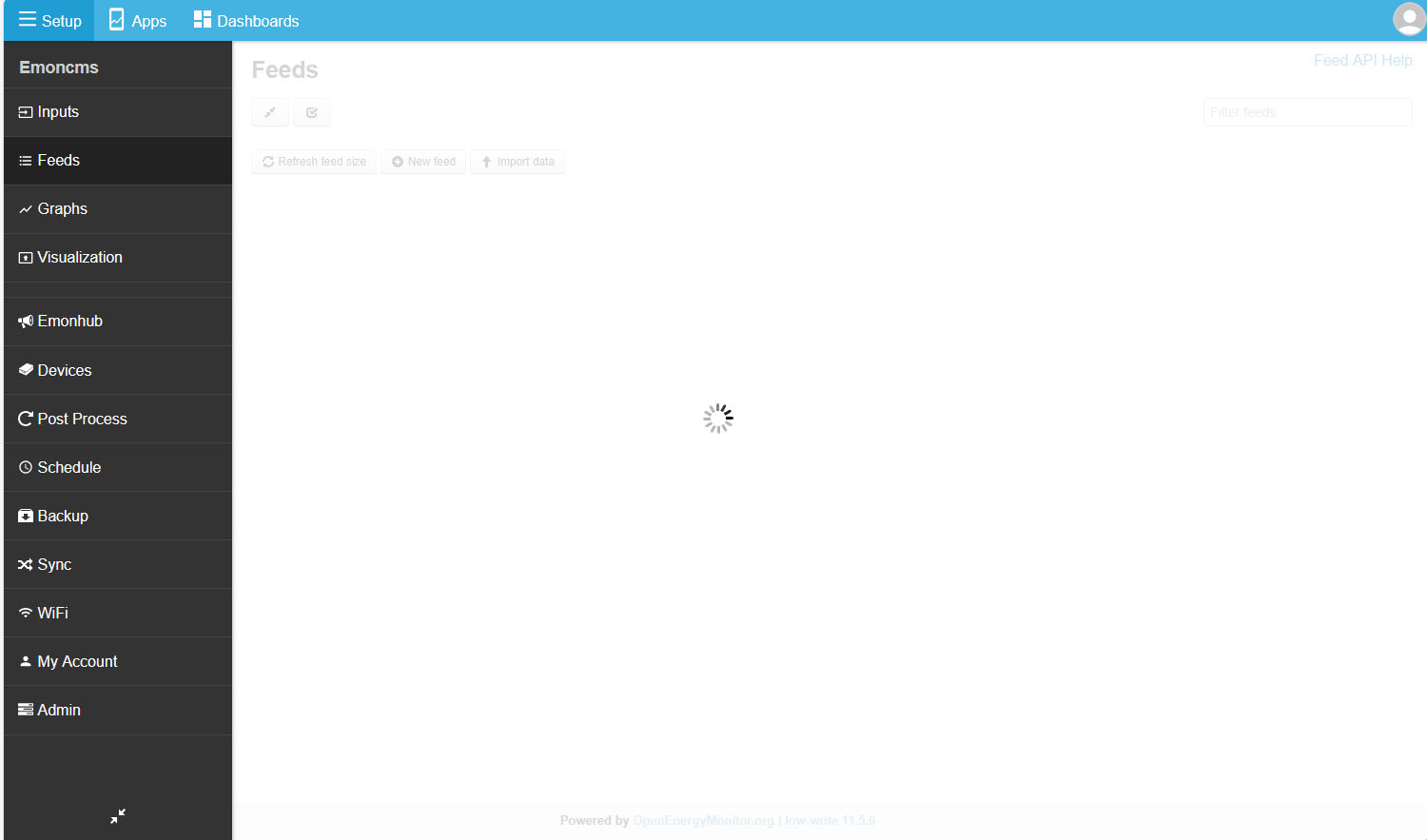

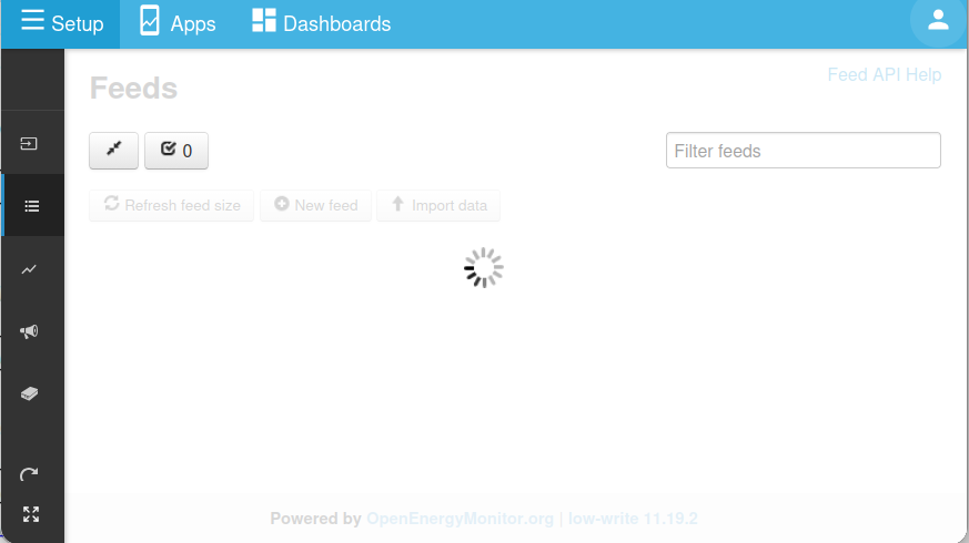

My Feeds page is greyed out. What should I do to fix it?
My Feeds page became greyed out attempting to assist @BrianD. What should I do to fix it?

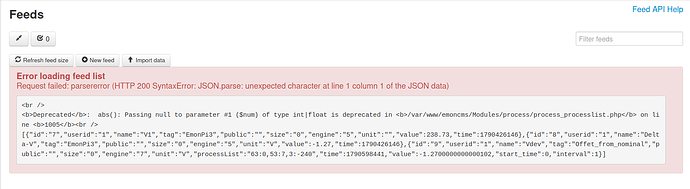

Sorry about this issue, could you let me know what you see if you type the following URL directly:
http://emonpi.local/feed/list.json
This should hopefully give us an error to work with. Once I have that error I will improve the catching of this error state so that it doesnt result in this issue in the first place, again apologies!

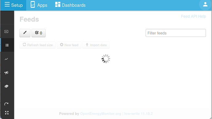

I managed to reproduce this issue, it was caused by the source feed of a virtual feed being deleted. I have now added a fix for this and pushed to latest master and stable branches, release v11.19.3. Let me know if this fixes the issue for you both @BrianD @Robert.Wall
For me, not true. I had only one Feed, V1, and I only deleted it AFTER the problem surfaced - which was not immediately after I changed the Virtual feed from Source Feed = V1 as op.1 to absolute value = 0 as op.1 and + source feed as op.2, then moved back to the Inputs page. Returning to the Feeds page, it refused to load.
@TrystanLea - I think you’re looking for a missing or illegal value in the maths. OK, it should be intuitive to use Source Feed as the first operation but equally starting with zero and adding to it should not crash the page, which is what appears to have happened.

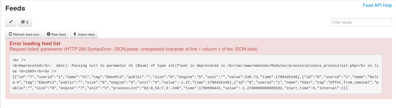

Updating and opening the Feeds page generated this error:
- probably because had I deleted all process steps on the Inputs page inside emonCMS and the Feed files (unused anyway) outside of emonCMS because I had no other way to attempt a recovery.

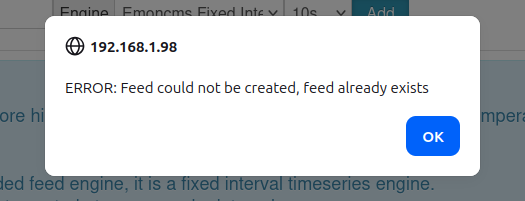

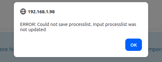

then when I try to create it:
You’re relying on a list somewhere instead of looking for the files themselves? How is the list corrected?
(There are NO process steps at all on the Inputs page, so it appears a method of updating the stored list is needed.)
The way for me to recover is clear - rewrite the SD card and reload the emonPi3 software. This clearly isn’t viable if the same happens to another user, because the corrupted lists/tables will be part of the backup and will get reloaded and restore the fault as it was.
Nice to see the new error reporting addition in the latest version working there at least that gives me something to work with. Thanks @Robert.Wall !

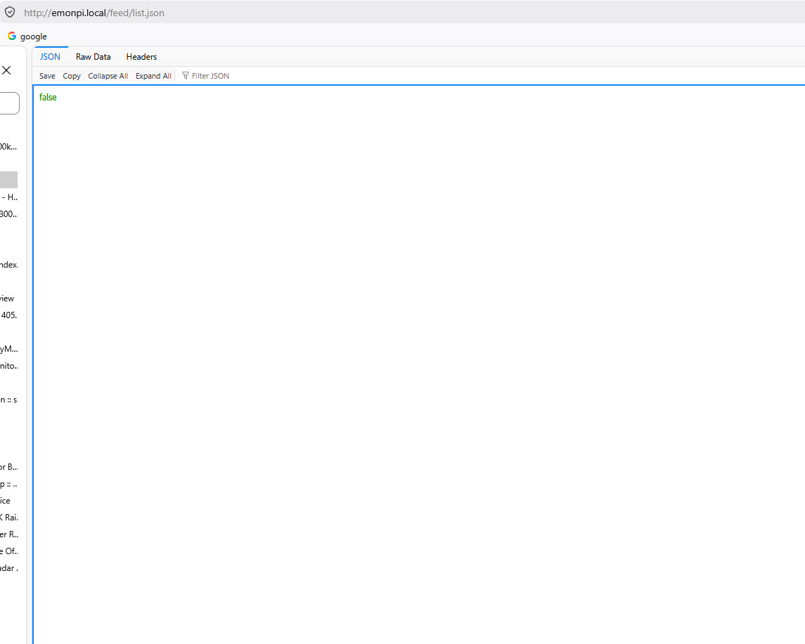

The response is ‘False’
Just fixed this @Robert.Wall , latest version skips the abs function if the value is null, you are welcome to update again.
Is that what you see in the same error window as @Robert.Wall? Can you try logging out and back in again, a session issue is usually the reason for a False response but I may be off the mark there..

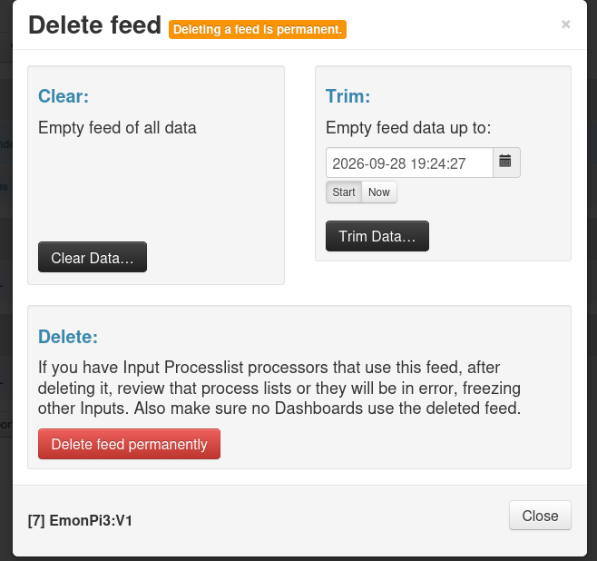

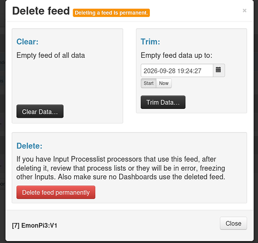

So a new problem surfaces: I can write and add process steps to use those feeds for which no file exists - and hasn’t been (re-)created. Now the question: If it delete the just-added process steps and then delete the Feeds via the Feeds page, will this clean the system up? Nope:
But I appear to be able to delete the no-files Feeds via the Feeds page:
And they’re gone - even though thee wasn’t a physical file to delete in the first place, and taken the process steps it refused to delete from the Inputs page with them, so it happens to have done what the “Delete:” note suggests the user does.
So by a circuitous route, it appears to have cleaned everything up.

The original problem was caused by the abs function returning an error when the value from the previous process or absence of process was NULL, that was fixed earlier above Fix null error with abs process · emoncms/emoncms@80c7c02 · GitHub
After logging out and back in:
It really is returning false then ! Can you check the emoncms log on the admin page?
