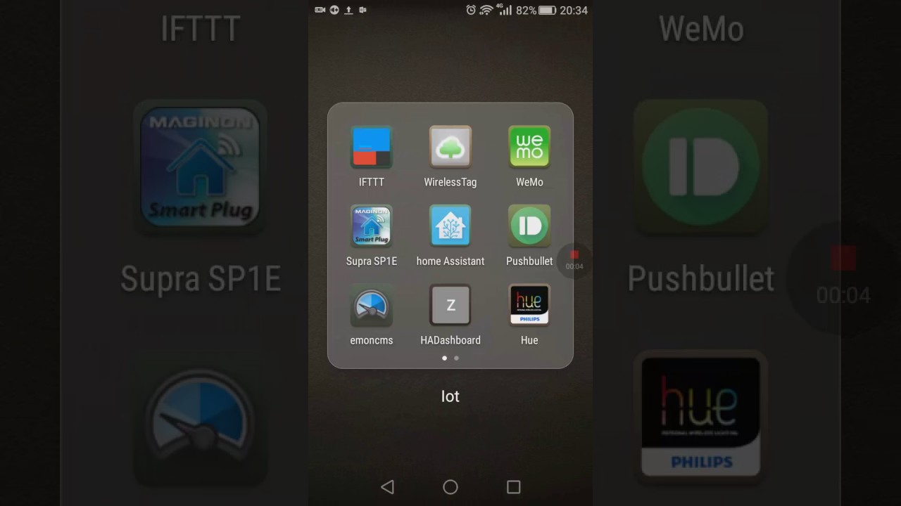

  • I can make the app crash or at least so it seems. If you add a new page and fill in all details (feed power / kwh, currency sign, kwh elepased) but with price you remove the ā€œ0ā€ value so it becomes blank (so just remove the 0 with backspace) and then you press the back button on the top left (which would normally save the new page), the app seems to crash with no fault or anything. iā€™m returned to my android phones main screen. When restarting the app that page i was adding is not created.
    hereā€™s a video showing the bug in action:
