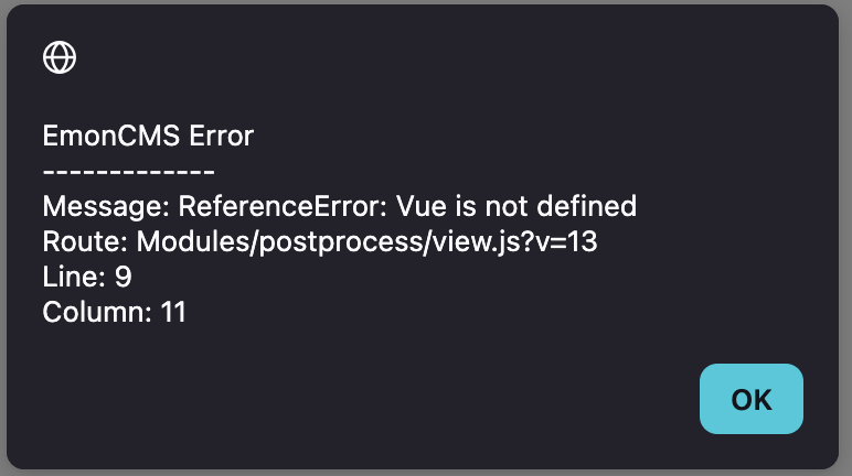

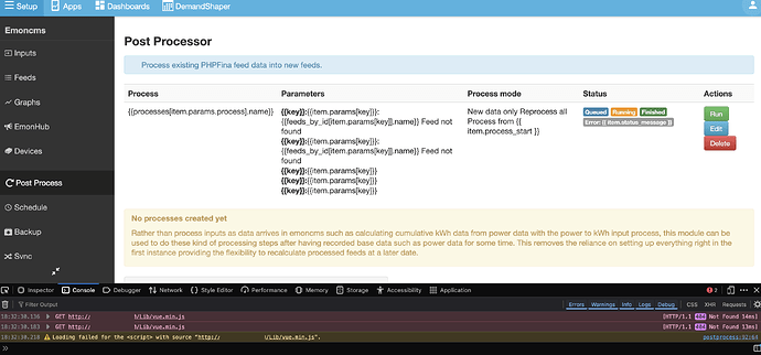

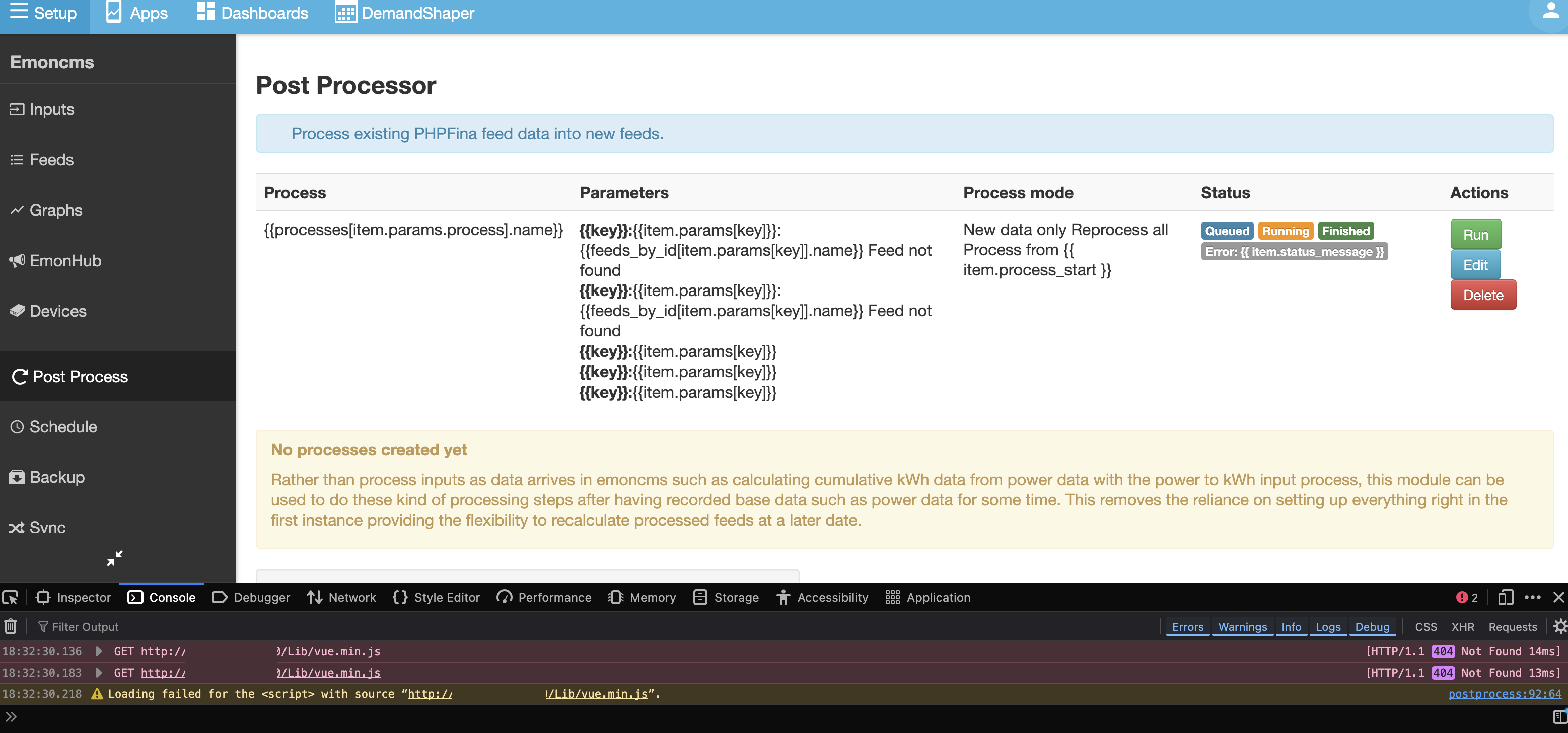

When opening Post Process in v11.18.0 of emoncms I’m getting an error “Vue is not defined”. Looking at browser console that’s because /Lib/vue.min.js returns 404.

Ahh, that may have been it. Was at 2.4.7 and the only component set to HEAD (I think to solve previous issues with PHP version incompatiblity).
When I set to master and update to 2.7.1 I now see
Parse error: syntax error, unexpected ':', expecting ')' in /opt/emoncms/modules/postprocess/common.php on line **170
