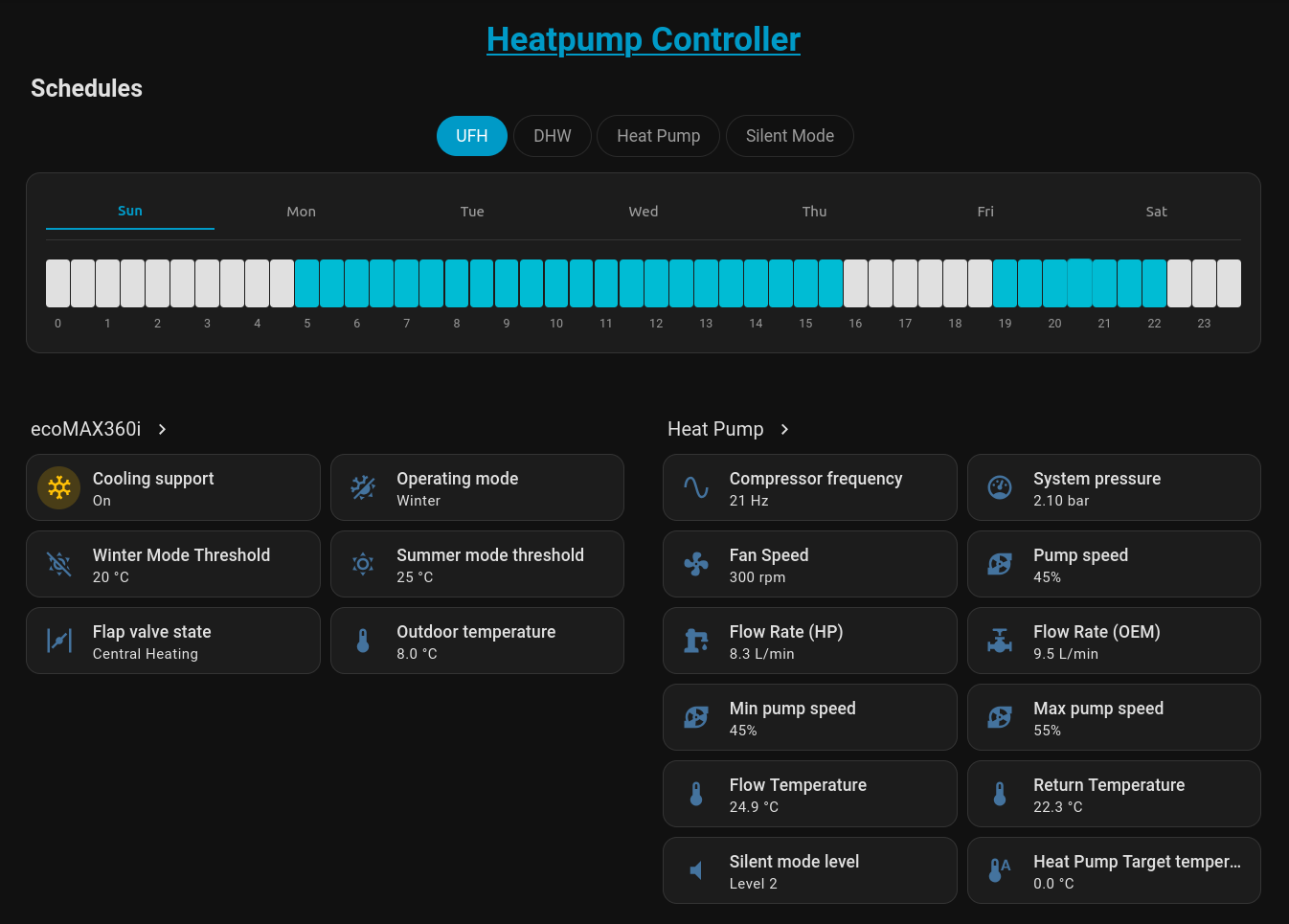

Here’s some screenshots of my Heatpump dashboard

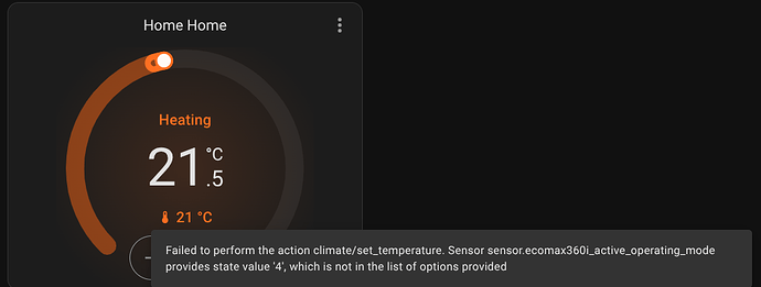

I’ve noticed this error when adjusting the thermostat set-point temperature, the command works fine, but this error is visible:

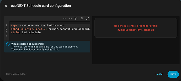

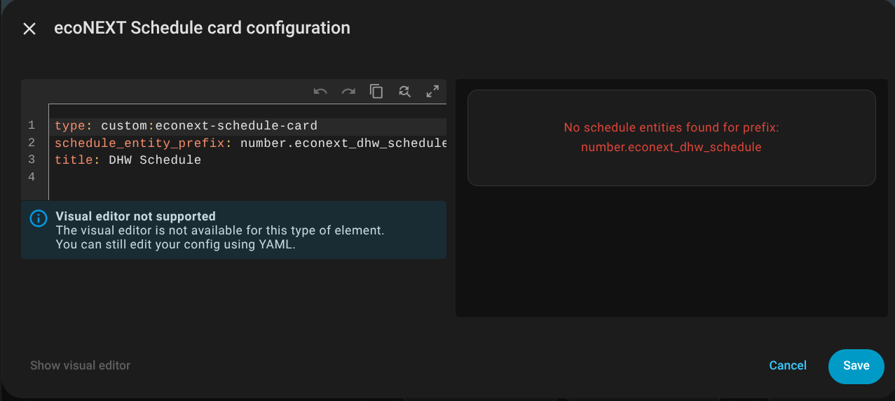

I’ve been trying to set up the econet-schedule-card, I think I’ve got it installed correctly, but I’m getting this error:
 ![Screenshot 2026-02-19 00.00.39](https://community.openenergymonitor.org/uploads/default/original/3X/4/9/49099f1916b122c56c8cfa68b8958f3d60f59bbb.png)
Any ideas?

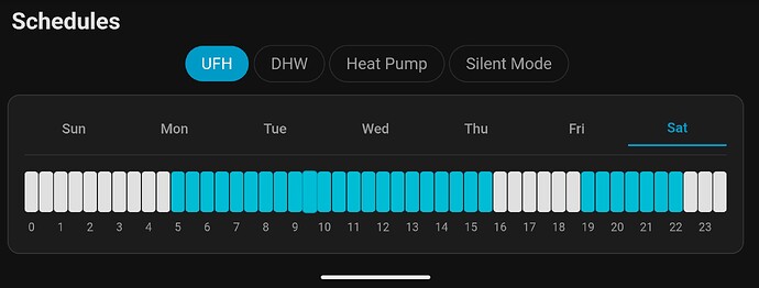

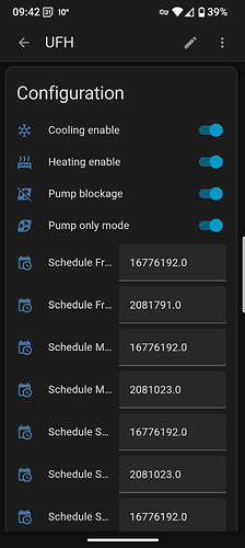

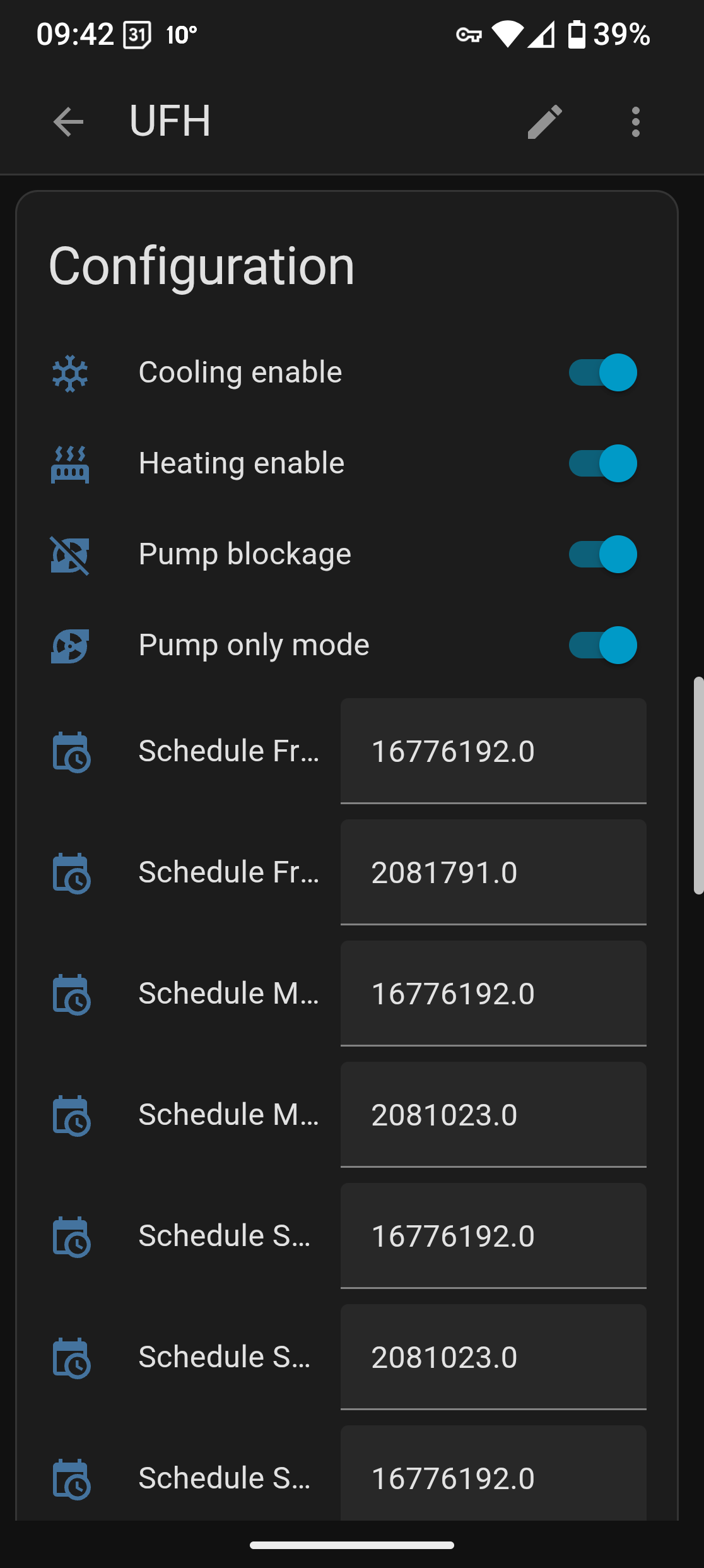

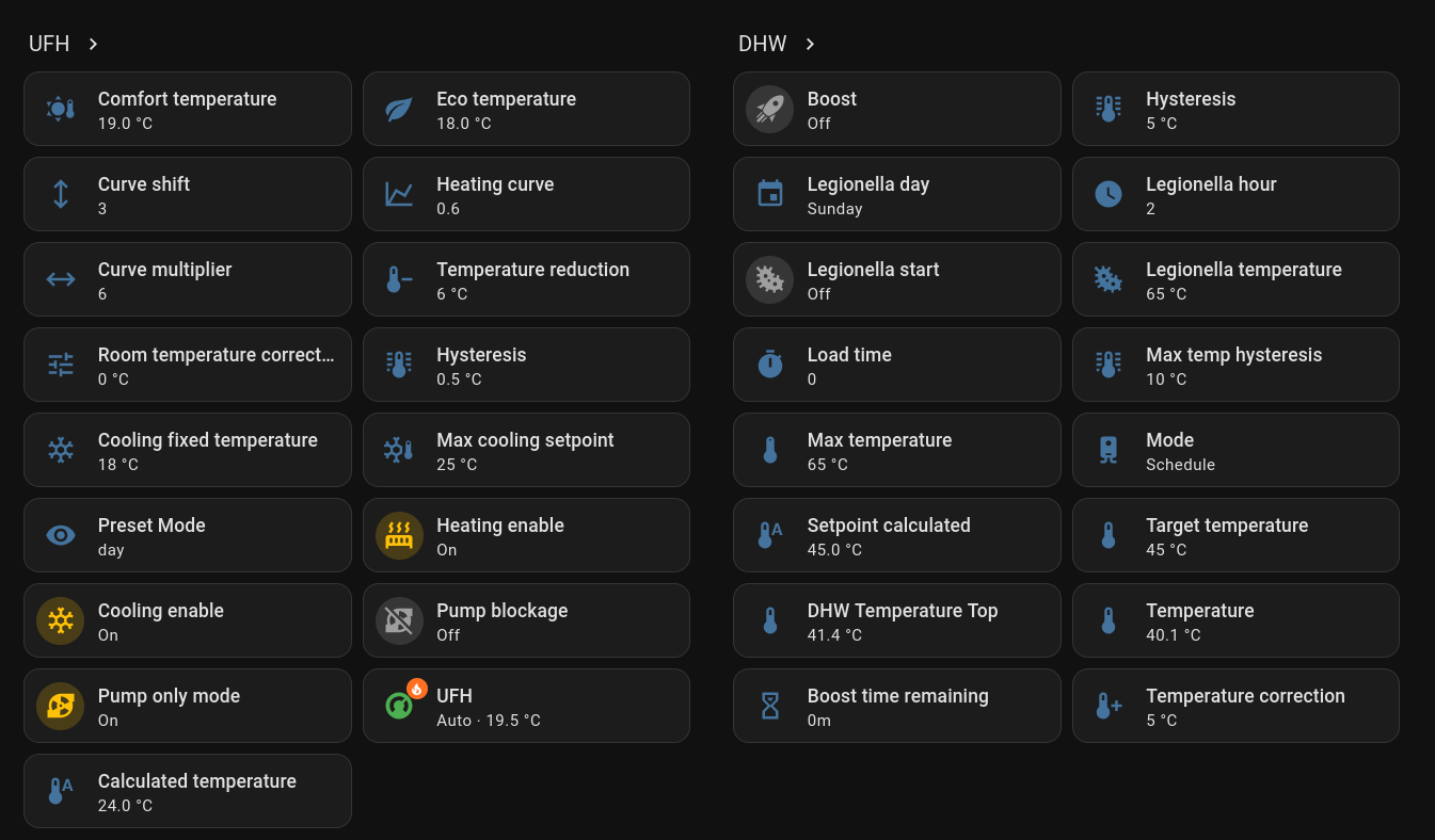

I think you entity prefix might be incorrect. Verify what the schedule entities begin with (you can see a list of them on the respective device page)
 ![Screenshot_20260221-094259](https://community.openenergymonitor.org/uploads/default/original/3X/9/f/9f7bc4704ad06d702aa571c9acab02f0c7359f1e.png)

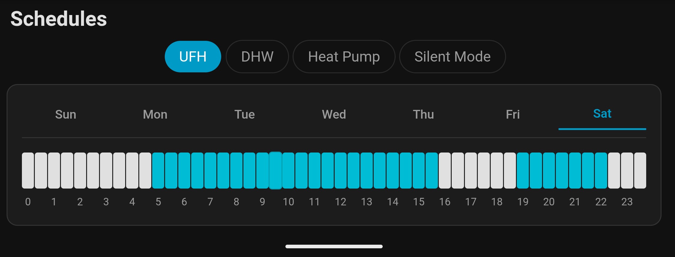

This is my dashboard setup for all schedules. My circuit is called UFH (which is used as device name), I installed [simple tabs](https://github.com/agoberg85/home-assistant-simple-tabs) to have them all nicely organised like this:
 ![Screenshot_20260221-094555~2](https://community.openenergymonitor.org/uploads/default/original/3X/9/2/92a4028f2005633736c2bff2d429dd48d363ef1a.jpeg)
```auto
type: grid
cards:
  - type: markdown
    text_only: true
    content: "## Schedules"
    grid_options:
      columns: full
  - type: custom:simple-tabs
    tabs:
      - title: UFH
        card:
          type: custom:econext-schedule-card
          schedule_entity_prefix: number.ufh_schedule
      - title: DHW
        card:
          schedule_entity_prefix: number.dhw_dhw_schedule
      - title: Heat Pump
        card:
          schedule_entity_prefix: number.heat_pump_heat_pump_schedule
      - title: Silent Mode
        card:
          schedule_entity_prefix: number.heat_pump_silent_mode_schedule
    column_span: 2
    grid_options:
      columns: full
column_span: 2

Yes, you’re right I was using `schedule_entity_prefix: number.econext_dhw_schedule`, when actually the DHW schedule was `number.dhw_dhw_schedule`. It’s now working. Thanks 👍

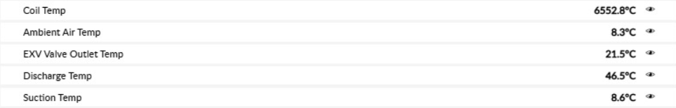

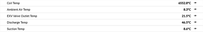

@LeeNuss do you if it’s possible to read the refrigerant system data that’s available on econet e.g
 ![Screenshot 2026-03-01 17.04.16](https://community.openenergymonitor.org/uploads/default/original/3X/1/7/17a3b358edb9b5b2ac4c3860fd0959d08980fc9c.png)

If you can see the item on the original web page, then you may be able to extract the name from the page code.
**Author:** ![LeeNuss](https://community.openenergymonitor.org/user_avatar/community.openenergymonitor.org/leenuss/32/35778_2.png) [@LeeNuss](https://community.openenergymonitor.org/u/LeeNuss)\
**Post date:** [3 March 2026 13:32 UTC](https://community.openenergymonitor.org/t/econext-direct-local-control-of-grant-hp290-econet-replacement-plum-ecomax360i/29758/17 "2026-03-03T13:32:11Z")
it’s `AXEN_REGISTER_61`

definitely possible, will need to see which parameter is the EXV Valve Outlet Temp, the other one’s are easily to find. Will add this into the integration and make a new release with it later
**Post date:** [5 March 2026 12:27 UTC](https://community.openenergymonitor.org/t/econext-direct-local-control-of-grant-hp290-econet-replacement-plum-ecomax360i/29758/19 "2026-03-05T12:27:13Z")
Just pushed a new release for the HA integration adding these values (and a few more) 🙂
**Post date:** [6 March 2026 23:37 UTC](https://community.openenergymonitor.org/t/econext-direct-local-control-of-grant-hp290-econet-replacement-plum-ecomax360i/29758/20 "2026-03-06T23:37:30Z")
Nice work, I just updated. All seems to be working well. I can now see the refrigeration metrics listed. Thanks 👍
