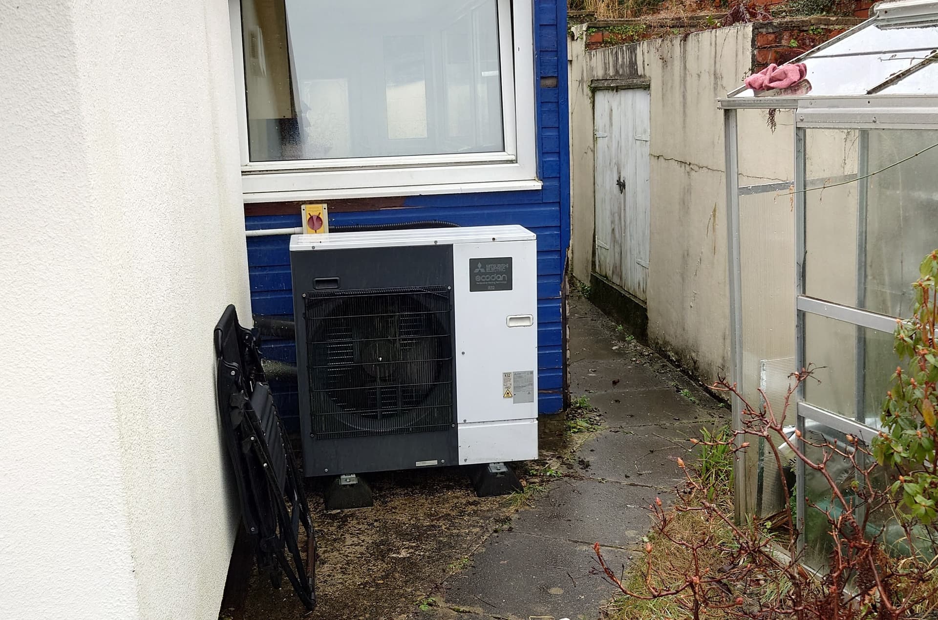

Good Morning!
Firstly I’d like to thank Trystan for setting me up with emoncms using only the native Melcloud data, much appreciated!
I have noticed in the very cold weather that the outdoor temperature sensor appears to fluctuate with defrost cycles. I am wondering if this is having an impact on the how the heatpump behaves. See here: [Emoncms - app view](https://emoncms.org/app/view?name=Ecodan&readkey=bdac37d5426ae20e695028f971adf69a&mode=power&start=1736370450&end=1736423700)
 ![20250114_121201](https://community.openenergymonitor.org/uploads/default/original/3X/5/4/540b7427f1b7642fc1f2c1e62d483859eba89669.jpeg)
Does anyone know if it is possible to connect an additional outdoor sensor? or if I could move the existing sensor? It looks like the unit is creating it’s own microclimate which affects the readings. But if it makes it’s own microclimate then perhaps it’s important that the sensor stays inside it.
Or maybe it’s not worth worrying about. 🤔
Thanks,
Robyn
**Post date:** [14 January 2025 12:50 UTC](https://community.openenergymonitor.org/t/ecodan-outdoor-temperature-sensor-possible-feedback/27715/2 "2025-01-14T12:50:09Z")
Welcome aboard the emoncms train!
The sensor is tied to the back of the unit, so it does pick up the wave of heat from each defrost. [Mine does the same](https://emoncms.org/cryosphere?mode=power&start=1736573040&end=1736594640).
I don’t think it has any impact on the running of the heatpump.
