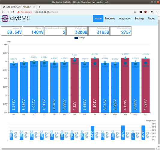

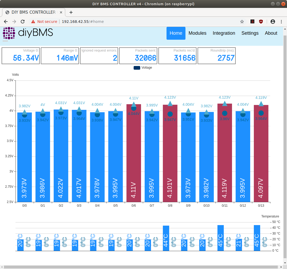

![Screenshot from 2020-04-15 15-12-55](https://community.openenergymonitor.org/uploads/default/original/2X/b/b330e2d5ce35ad6b212049f6007d67f1ab256c23.png)
I’m finally able to test with bypass mode. In the image you can see 4 cells are red but when I look at the modules only the last 3 (the ones showing temperature of 45 degrees or so) have the red flashing light. Does that mean that one is not working correctly?
Looking at the circuit diagram (I only know basic electronics) my guess would be that the pin from the ATTINY to the DUMP\_LOAD\_ENABLE probably is not properly connected? Would that be a good guess?
I was right 🙂 the pin on the ATTINY was not soldered. Fixed it now and the bypass now works on that module.

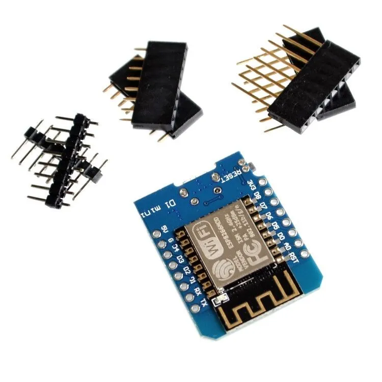

Going out of my mind here but has anyone got a link to the exact wemos d1 required? Even Amazon is giving me 100 pages. From 3 for €12.00 to €11.00 each.
Thanks in advance.
**Post date:** [16 April 2020 05:12 UTC](https://community.openenergymonitor.org/t/diybms-v4/11292/1217 "2020-04-16T05:12:17Z")
> [@tomash](#):
There are so many bad rip offs about I only buy mine direct from China [HOME — WEMOS documentation](https://www.wemos.cc/en/latest/)
Its “WEMOS D1 Mini Pro 16M Bytes + ESP8266/D1 Mini Pro Series WiFi Wireless Antenna”
Although at the moment any D1 Mini will work.
