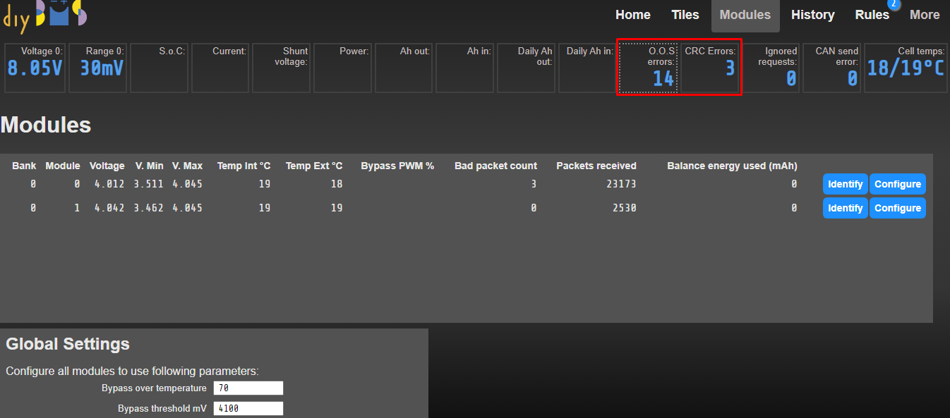

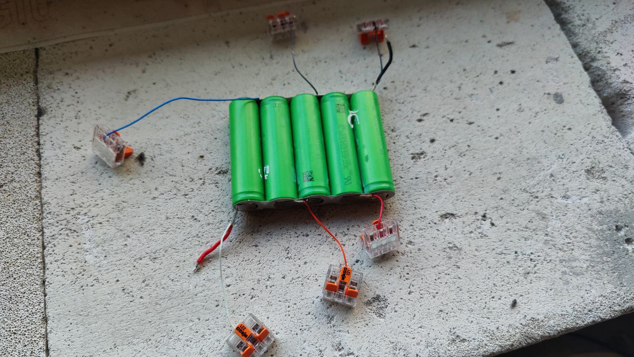

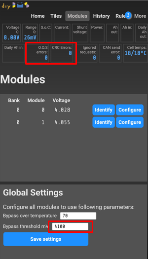

**Author:** ![Adas](https://community.openenergymonitor.org/letter_avatar_proxy/v4/letter/a/cc9497/32.png) [@Adas](https://community.openenergymonitor.org/u/Adas)\
**Post date:** [2 July 2023 12:54 UTC](https://community.openenergymonitor.org/t/diybms-v4/11292/5330 "2023-07-02T12:54:24Z")
Hello, I have a problem when my modules are supposed to calibrate the battery, they don’t do it and it seems that it hangs and does not pass data.
 ![photo_2023-07-03_01-27-01 (2)](https://community.openenergymonitor.org/uploads/default/original/3X/2/4/24fb57b786f86808b7b71358573134ca18c263e5.jpeg)
 ![photo_2023-07-03_01-27-01](https://community.openenergymonitor.org/uploads/default/original/3X/e/8/e8064b33746e3de42e3d4265077237b80cbfde6d.jpeg)
 ![photo_2023-07-03_01-27-01 (3)](https://community.openenergymonitor.org/uploads/default/original/3X/1/d/1d404846609b8c1ac8d560978c307df189f5eb0d.jpeg)
Balancing does not work, although I was set to 4.080v
 ![photo_2023-07-03_01-27-01 (4)](https://community.openenergymonitor.org/uploads/default/original/3X/5/6/569aea5b626adbd751b64d1e6c8035b93b7e360e.jpeg)
When I connected this battery balancing works.
What is wrong?
**Author:** ![stuart](https://community.openenergymonitor.org/user_avatar/community.openenergymonitor.org/stuart/32/16661_2.png) [@stuart](https://community.openenergymonitor.org/u/stuart)\
**Post date:** [3 July 2023 06:57 UTC](https://community.openenergymonitor.org/t/diybms-v4/11292/5331 "2023-07-03T06:57:37Z")
Hello @Adas , on the tiles page take a look at the “ignored requests” and the “OOS errors” they should both be zero.
When you set the voltage calibration, there is a short delay whilst the values are sent across to the modules. During this time, the screen may show that cell as missing or zero volt, but should refresh in a few seconds.
If you calibrate the modules using the small 5 cell pack you have, you shouldn’t need to re-calibrate them again on the larger pack.

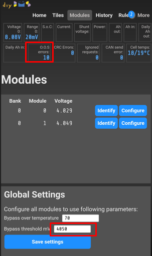

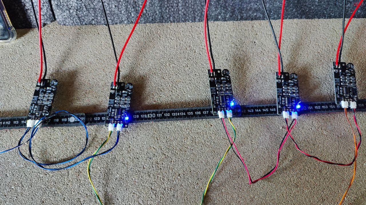

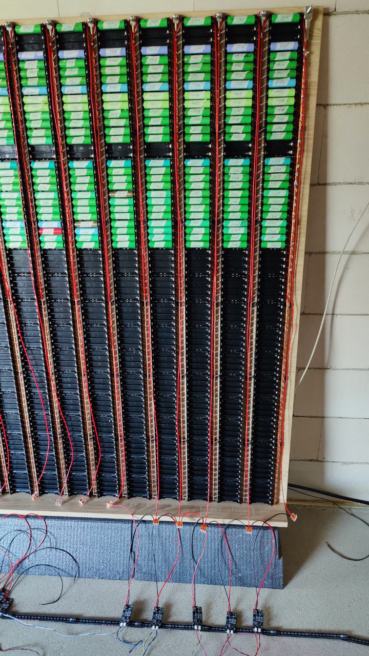

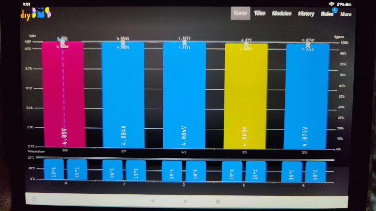

**Post date:** [3 July 2023 21:04 UTC](https://community.openenergymonitor.org/t/diybms-v4/11292/5333 "2023-07-03T21:04:01Z")
Hello @stuart , Today I checked everything once more and there are no errors until the battery needs to be calibrated.
![1](https://community.openenergymonitor.org/uploads/default/original/3X/8/0/80daa03ac67d9a5e75cedf4343435f2e341275d4.png)
 ![2](https://community.openenergymonitor.org/uploads/default/original/3X/b/a/bac39e9c097e256eb384d6af9ee7b34686d05e6d.png)
 ![3](https://community.openenergymonitor.org/uploads/default/original/3X/1/0/10d57ce297e8db52590efdb0f6172c948763714a.png)
 ![4](https://community.openenergymonitor.org/uploads/default/original/3X/0/1/010d5d1b8bfd09c855c6e3e59eb25936f9d2df95.png)
Now I set bypass threshold mV 4050 and immediately all modules start to flash D4 led synchronously.
When I tried using the small 5 cell pack, the calibration worked.
I don’t understand why it doesn’t work when I connect it to a large pack.
 ![5](https://community.openenergymonitor.org/uploads/default/original/3X/4/a/4a611cb9e39c11c00f9043c87fc19747238f5743.png)
Yes after 12 hours of operation I got “OOS errors”
Where do I find the problem?
