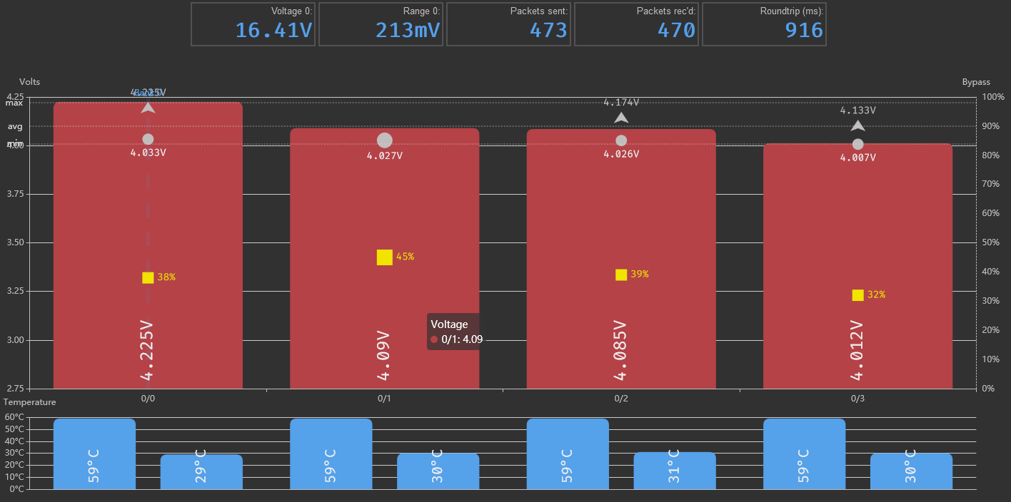

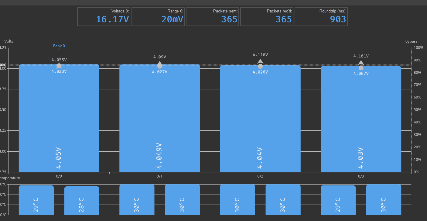

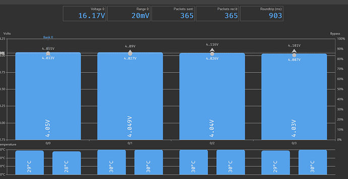

Well first impression are not good…
At start, all cells around 4.05V and bypass fixed hight to 4.20V:
 ![imagen](https://community.openenergymonitor.org/uploads/default/original/3X/2/5/251a293e688f559bcd19fd178cac904ff6a4fb03.png)
Then down bypass to 4.05 and voltage measures start to crazy up and down:
 ![imagen](https://community.openenergymonitor.org/uploads/default/original/3X/6/d/6d390a4e79152f36d6301eb6458171b620b42591.png)
It seems that during balance, voltage measures will fail.
-Will the cables be very thin?
-My Attiny or other HW are bad?
-Other unknown config?

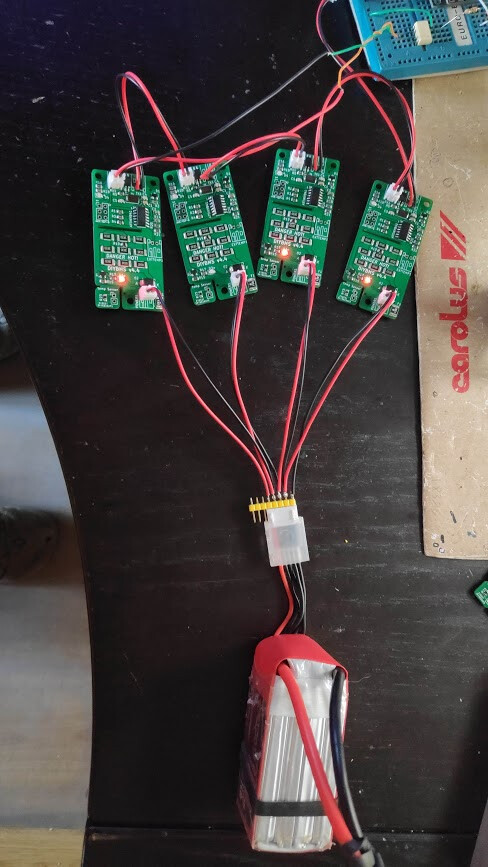

Tested with a lipo drone cell 4s
 ![imagen](https://community.openenergymonitor.org/uploads/default/original/3X/f/5/f58df7fb2a122bd6cceb5bc276703b14178a1929.jpeg)
My config: V440 modules with last firm.
ESP8266 controller.
After few minutes draining energy, disconnect modules and reconect. Voltage is now around 3,9 volts and no bypass.

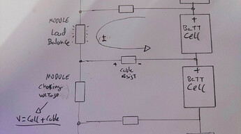

**Author:** ![dakoal](https://community.openenergymonitor.org/letter_avatar_proxy/v4/letter/d/7bcc69/32.png) [@dakoal](https://community.openenergymonitor.org/u/dakoal)\
**Post date:** [22 June 2021 20:10 UTC](https://community.openenergymonitor.org/t/diybms-v4/11292/3845 "2021-06-22T20:10:05Z")
As written here some time ago: Don’t share cables.
Always go with + and - direct from the module to the battery pole.
As soon as one module is starting to balance, the voltage of the + pole is sinking at the end of the cable. But this value is the - of the next cell.
So the next cell suddenly has a higher voltage, because the - is sinking, and if its higher then balance voltage, it starts.
Then the game goes to the next cell.
With the cheap China BMS 30mA and less balance power of them is no problem. But we have here 800 to 1000mA Balancepower.
Edit: and we don’t use these red/black PH2.0 JST connector china cables from the picture for powering the modules, they are to thin. For communication no problem.
We use as minimum 24AWG for power connector cables.

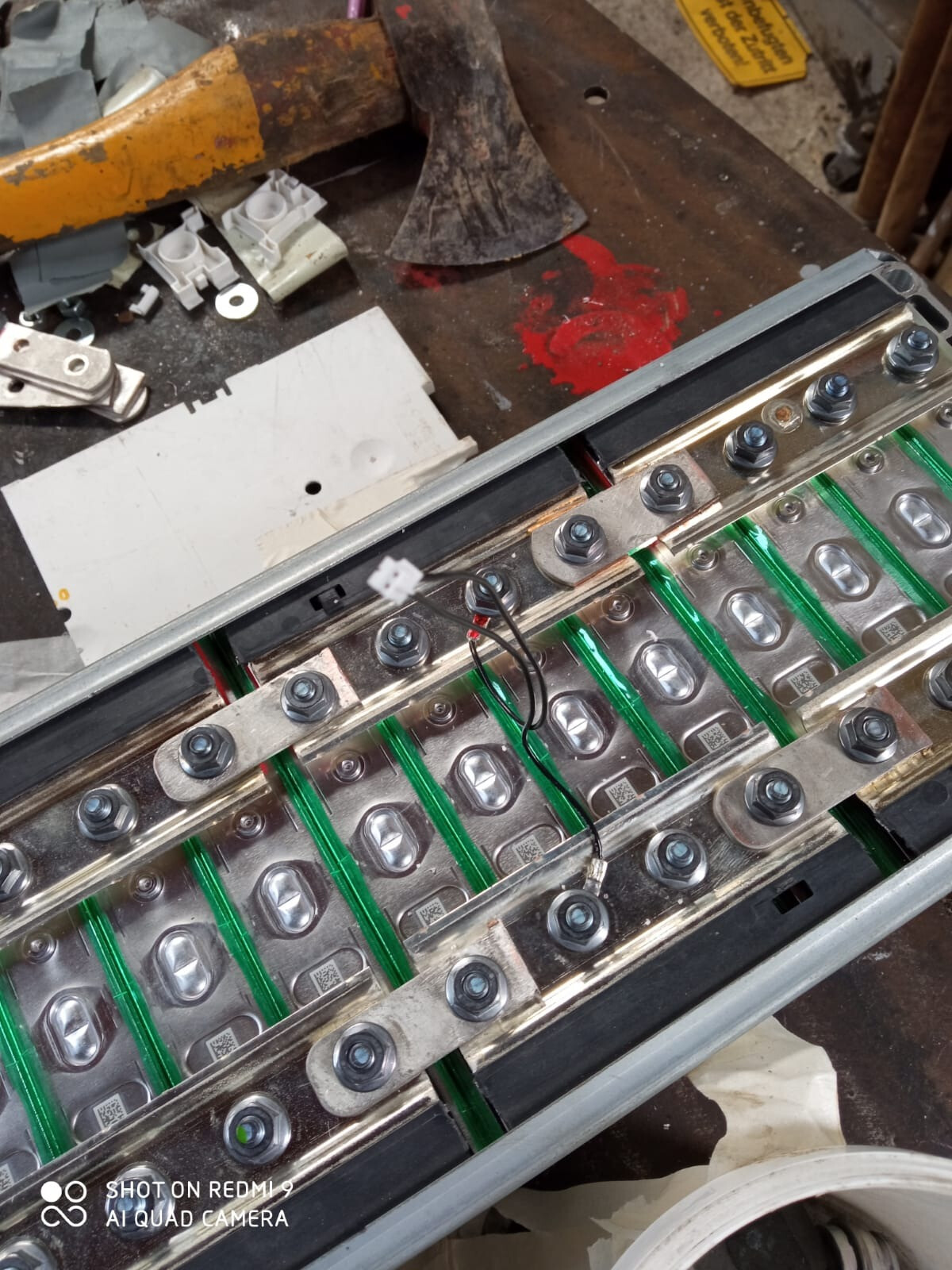

**Post date:** [22 June 2021 20:20 UTC](https://community.openenergymonitor.org/t/diybms-v4/11292/3846 "2021-06-22T20:20:50Z")
![image](https://community.openenergymonitor.org/uploads/default/original/3X/5/8/5862670dd2f4540d6053105761f373ca7a7b0b61.jpeg)
300Ah battery, own + and - cable for the V4.21 module.
**Author:** ![almol](https://community.openenergymonitor.org/user_avatar/community.openenergymonitor.org/almol/32/16269_2.png) [@almol](https://community.openenergymonitor.org/u/almol)\
**Post date:** [22 June 2021 20:49 UTC](https://community.openenergymonitor.org/t/diybms-v4/11292/3847 "2021-06-22T20:49:50Z")
Thanks for the advice. I can’t find cables bigger than 26AWG, really PH2.0 JST is too small for the propuse.
On that test, Lipo cables (common part) are 22AWG then 26AWG.
That will be common mistake… Neverless, I’ll tried with real cells shortly.
Maybe this will be arrange by firmware? (stopping balance and check voltage). I’m worried that voltage is down and down without intervention and battery will be maybe drained.
**Author:** ![stuart](https://community.openenergymonitor.org/user_avatar/community.openenergymonitor.org/stuart/32/16661_2.png) [@stuart](https://community.openenergymonitor.org/u/stuart)\
**Post date:** [22 June 2021 22:08 UTC](https://community.openenergymonitor.org/t/diybms-v4/11292/3848 "2021-06-22T22:08:07Z")
Jst ph2 connectors are rated for 2amps, plenty for the 1amp it may draw.
As a cell balances, the voltage will drop due to ohm’s law and the cells and cables internal resistance.
**Post date:** [22 June 2021 22:38 UTC](https://community.openenergymonitor.org/t/diybms-v4/11292/3849 "2021-06-22T22:38:36Z")
Yes, I know, you shouldn’t use common cable, but in some environments I don’t think you can do much.

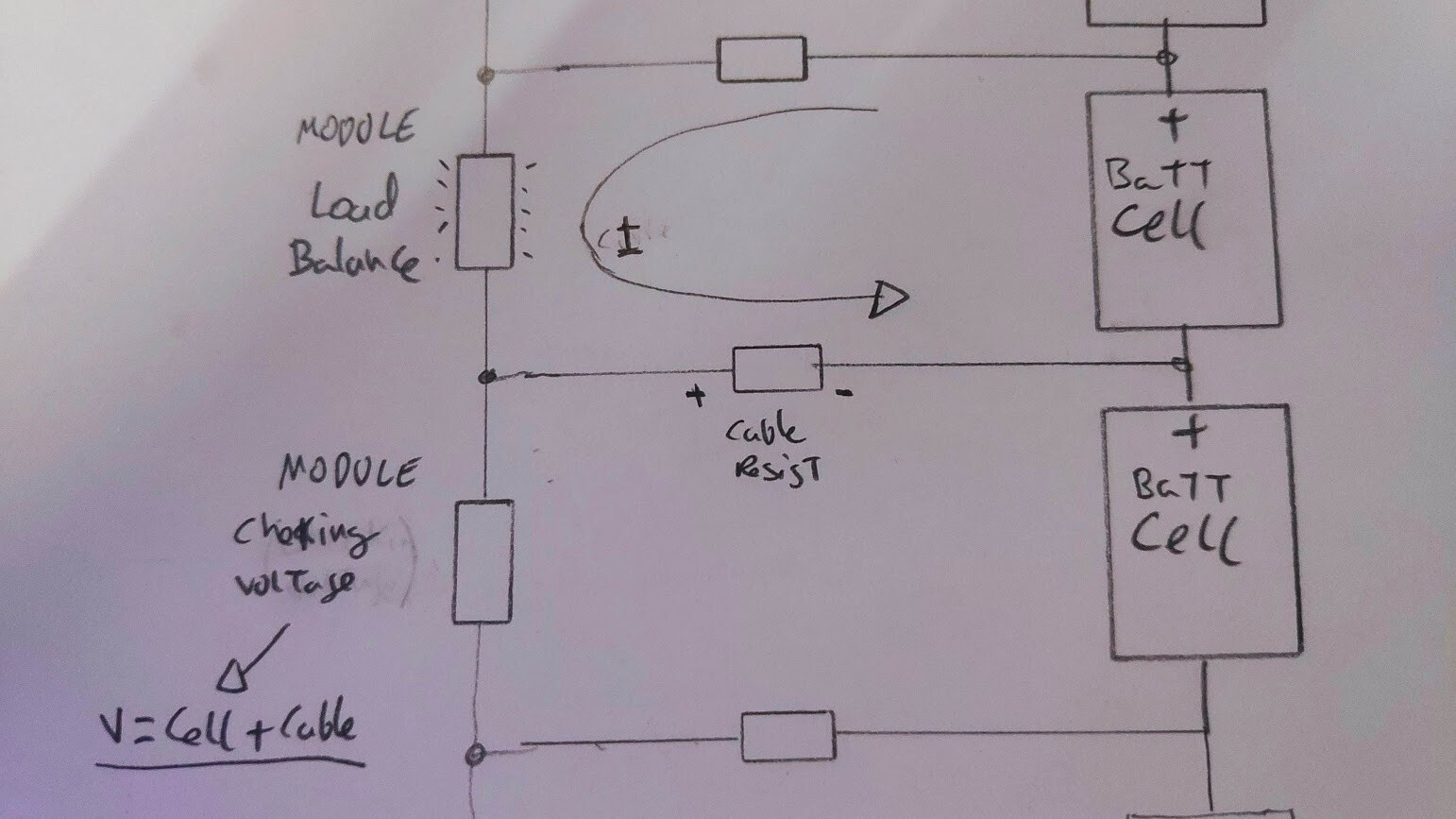

As @dakoal explains, in an environment with common wires, when a module is balancing it causes an increase in the measured voltage of the neighboring module. This causes this module to detect a higher voltage and also to balance. This goes into a spiral that causes the whole system to malfunction and to stop it, intervention is needed: raising the bypass voltage or disconnecting the modules.
 ![imagen](https://community.openenergymonitor.org/uploads/default/original/3X/6/f/6f13bcbe91cda6f6bccbc206d238aab76cee97b1.jpeg)
I think the software solution would be simple:
-Stop the balancing for an instant in all the modules every minute and measure the correct voltage, or stop the balancing in the adjoining modules.
-Detect that if there are large voltage variations in contiguous measurements and also stop the balancing for a moment.
-Use the lowest voltage in a serie of measurements.
**Post date:** [23 June 2021 06:52 UTC](https://community.openenergymonitor.org/t/diybms-v4/11292/3851 "2021-06-23T06:52:11Z")
The issue you have is slightly artificial.
In a normal charge cycle, all the cells won’t be out of balance. So the BMS will then only have a few random cells to balance (if any)
The charger should have stopped balancing well before the cut off voltage, to prevent the situation in the first place.
What you are now doing is more of a discharge test.
