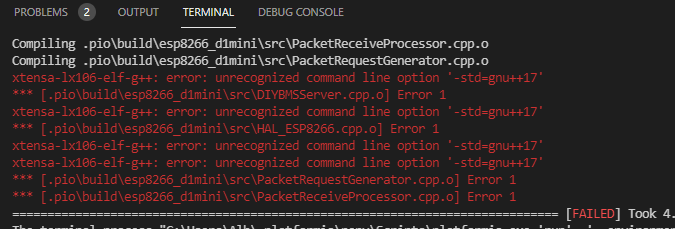

**Author:** ![almol](https://community.openenergymonitor.org/user_avatar/community.openenergymonitor.org/almol/32/16269_2.png) [@almol](https://community.openenergymonitor.org/u/almol)\
**Post date:** [20 June 2021 22:16 UTC](https://community.openenergymonitor.org/t/diybms-v4/11292/3821 "2021-06-20T22:16:30Z")
Well. I make a big mistake to actualize platformio and since that…
![Captura3](https://community.openenergymonitor.org/uploads/default/original/3X/6/4/64cb9e1f693751f89efccf878003320b254a5f9f.png)

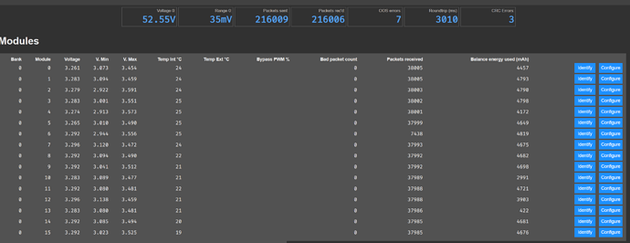

**Author:** ![donnib](https://community.openenergymonitor.org/user_avatar/community.openenergymonitor.org/donnib/32/11015_2.png) [@donnib](https://community.openenergymonitor.org/u/donnib)\
**Post date:** [21 June 2021 07:27 UTC](https://community.openenergymonitor.org/t/diybms-v4/11292/3823 "2021-06-21T07:27:51Z")
@stuart as i mentioned earlier, i did the resistor change as per the video you made and the result is now like this :
 ![image](https://community.openenergymonitor.org/uploads/default/original/3X/2/8/28312ecc501065b3a68d33f43c26217a24e4839a.png)
Notice the module 6 is getting less packets received, is it the sixth module from the controller or should i look a the cable from the previous module or what can that be ? Bad module ? Also i still see few CRC and OSS, is that what to expect at 200.000 packets ?

**Author:** ![stuart](https://community.openenergymonitor.org/user_avatar/community.openenergymonitor.org/stuart/32/16661_2.png) [@stuart](https://community.openenergymonitor.org/u/stuart)\
**Post date:** [21 June 2021 08:22 UTC](https://community.openenergymonitor.org/t/diybms-v4/11292/3825 "2021-06-21T08:22:48Z")
> [@donnib](#):
> Bad module ?
Definitely something wrong with that module - perhaps is just a cable issue?
Can you swap that module with another one and see if the problem moves?
**Post date:** [21 June 2021 08:24 UTC](https://community.openenergymonitor.org/t/diybms-v4/11292/3826 "2021-06-21T08:24:53Z")
but should i try to replace module 7 (it’s starts at 0) or should i replace module 6 ?
**Post date:** [21 June 2021 08:58 UTC](https://community.openenergymonitor.org/t/diybms-v4/11292/3827 "2021-06-21T08:58:50Z")
If you click the “identify” button it will flash the LED to indicate which module it is.
As the packet count is significantly lower than the rest, I suspect the controller ship is rebooting.
Perhaps some bad soldering ?
**Post date:** [21 June 2021 09:14 UTC](https://community.openenergymonitor.org/t/diybms-v4/11292/3828 "2021-06-21T09:14:33Z")
> [@stuart](#):
> controller ship
What do you mean ? As far as i can see the controller doesn’t reboot, maybe you mean the module ?
**Post date:** [21 June 2021 09:43 UTC](https://community.openenergymonitor.org/t/diybms-v4/11292/3829 "2021-06-21T09:43:30Z")
Crazy typo there!
“module chip”
**Post date:** [21 June 2021 23:20 UTC](https://community.openenergymonitor.org/t/diybms-v4/11292/3834 "2021-06-21T23:20:40Z")
> [@DIYBMS v4](https://community.openenergymonitor.org/t/diybms-v4/11292/3821):
> Well. I make a big mistake to actualize platformio and since that… [Captura3]
SOLUTION HERE: [Xtensa-lx106-elf-g++: error: unrecognized command line option '-std=gnu++17' - #4 by maxgerhardt - PlatformIO IDE - PlatformIO Community](https://community.platformio.org/t/xtensa-lx106-elf-g-error-unrecognized-command-line-option-std-gnu-17/22111/4)
