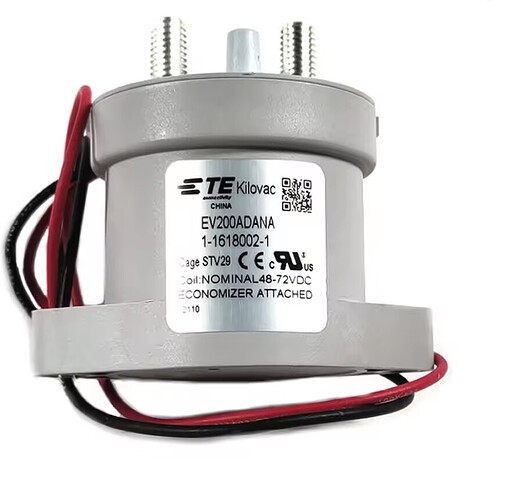

Hi, I decided to use this relay that has an economizer built in, so
- very low consuptions
- provide real isolation
- 500A rated
 ![image](https://community.openenergymonitor.org/uploads/default/original/3X/4/b/4b91c328eff5b5a40570c767dc16713d907dc051.jpeg)

thats the same contactors i use for both the live and negative leads
