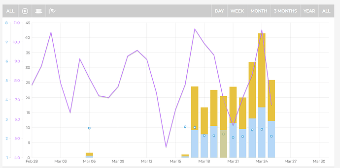

I have data flowing onstantly, and this can be seen in the Daily/Hourly plots, but at one level higher (main page) the daily bar plot has stopped; a few days ago.
How do I get ths back up and running? Thanks

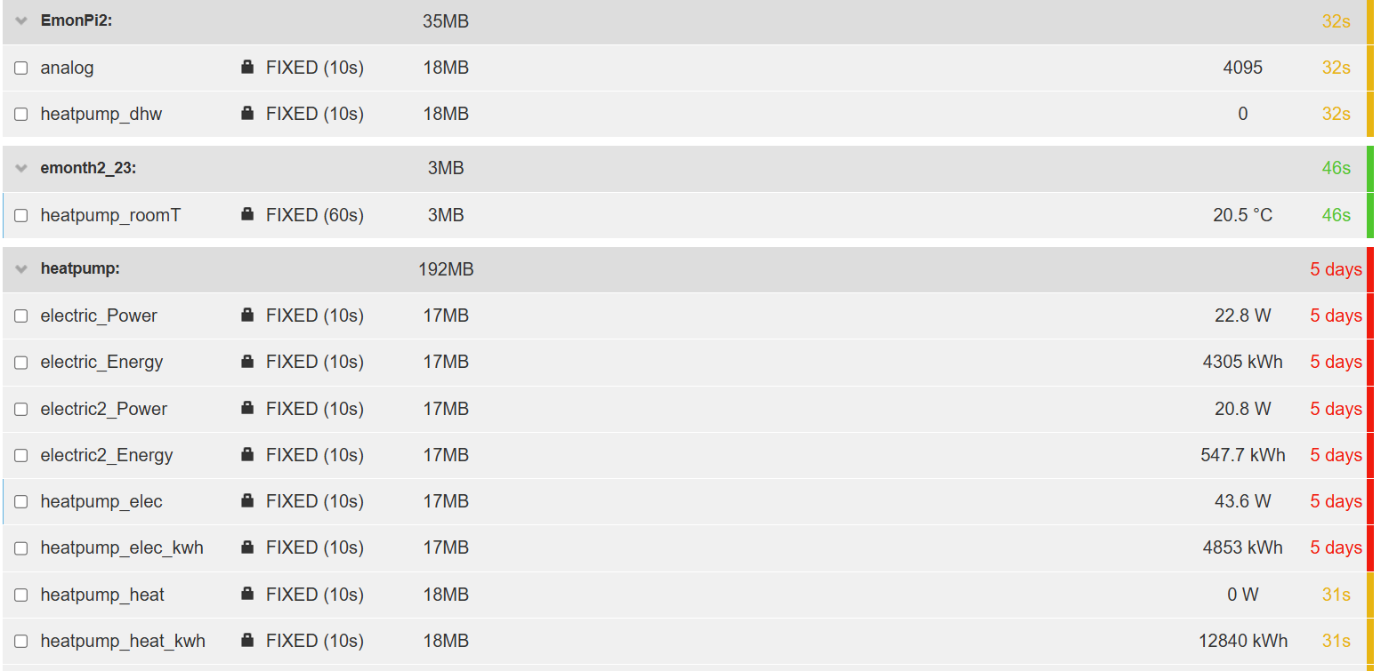

Apologies, there was an issue with the configuration of your electric meters which resulted in no electric meter data being logged. The graph will only display when both electric and heat meter data is present. This has now been resolved, so the graph will start showing again once there’s 24hrs of both heat and electric data.
