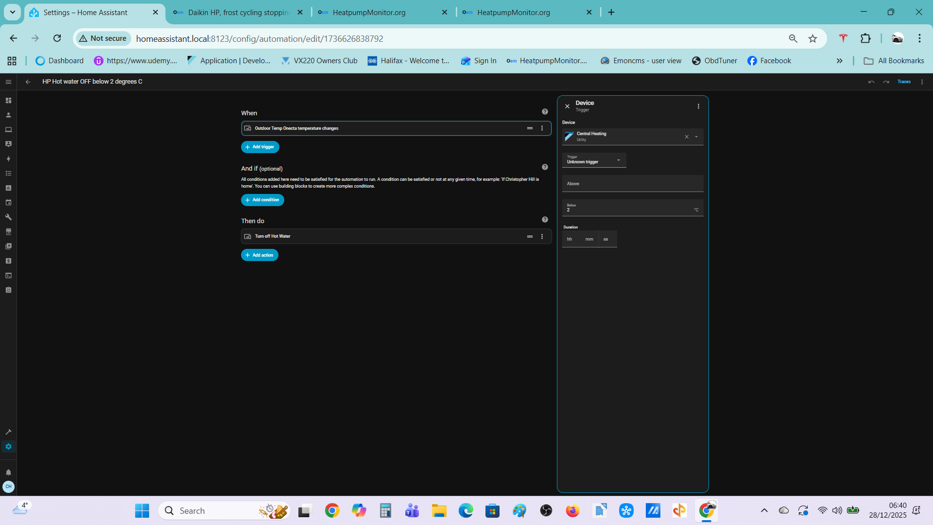

i am using home assistant to turn off the hot water and force the element on at a certain time if the hot water is below xx degree C

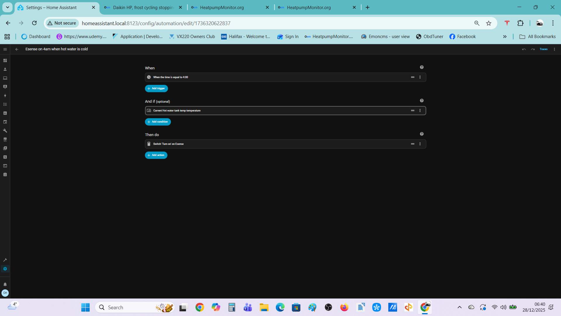

esense is my hot water element in tank
 ![image](https://community.openenergymonitor.org/uploads/default/original/3X/7/e/7edf04aee542a9add88eefaacb93b9b49b455d52.png)
this also guarantee hot water if something goes wrong with the hot water cycle

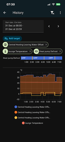

**Author:** ![Chris\_Hill](https://community.openenergymonitor.org/user_avatar/community.openenergymonitor.org/chris_hill/32/27079_2.png) [@Chris\_Hill](https://community.openenergymonitor.org/u/Chris_Hill)\
**Post date:** [31 December 2025 07:39 UTC](https://community.openenergymonitor.org/t/daikin-hp-frost-cycling-stopping-hot-water-heat-up/27632/18 "2025-12-31T07:39:22Z")
![image](https://community.openenergymonitor.org/uploads/default/original/3X/4/3/43bff5c122ab6c0456cf7e6eaed77c57640d33da.png)
this is when i have reduced my target LWT from the wc to -3 degree C
which has helped reduce the defrost cycles
 ![image](https://community.openenergymonitor.org/uploads/default/original/3X/6/c/6cef4ce420f58263fcb13965121323940e056e7b.png)
then the lwt recovers later and the internal temps do not take a hit
