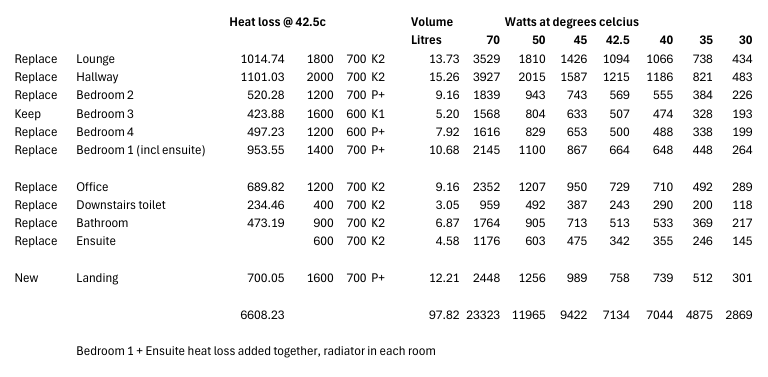

I’d like to run by the forum the radiator proposal, just to make sure it is sensible. (I have followed Matt D’s posts and journey and am particularly keen to ensure the radiators are about right!).
4 bed mid 50’s semi including extension in 2007 (which doubled the house from a 2-4 bed)
135m2
Insulated cavity walls on 50’s house
200mm loft insulation
Electric underfloor heating in kitchen extension
10 radiators (plus 1 proposed addition for landing)
BG heat loss calculation 6.2kW (Octopus 6.9kW)
BG have designed the house @ 21c everywhere, including bedrooms (other than 22 for bathrooms), to maintain that temp throughout.
The bedrooms at 21c is the main question.
Is this in the real world likely to be ok? We don’t want overheating bedrooms, but also recognise that having bigger radiators, may actually be a benefit to the system as a whole.
BG will install TRVs to the bedroom radiators only.
This is the radiator schedule, which I’ve calculated should have enough capacity at 30c flow temp to allow the 8kw Daikin to modulate low enough.

I think you’ll be fine with the 8kW Daikin and the radiators you are proposing.
I have got the 6kW Daikin and have in total 6.8m length of 600mm high K2 (total volume about 40L). That’s about half what you are proposing. I have also got a 20L volumiser. I get some cycling in warmer weather but I think you will have enough to avoid that in most situations.
Assuming the heat losses are accurate (or at least consistent) then the proposed radiators look well sized for the rooms.
For the bedrooms 21C would be too warm for most people. The TRVs will allow you to control to a lower temp. That means that you can’t really count those radiators for the purposes of heat dissipation & volume though. I still think you will be fine even if you exclude the bedroom rads.
The advantage of oversized bedroom radiators is that if you want those rooms to warm up in the morning (after a night-time set back for example) then they will do so quickly.

I suppose there is no ā€œperfectā€ sizing of the system and you also have to work with the installers guidelines to a degree. I think BG have done a decent job so far, which was a significant improvement on Octopus.
I hadn’t considered quicker recovery times in the early morning with having slightly bigger radiators in the bedrooms, which should be a benefit.
I’m not chasing the best COP possible, as that will have diminishing returns on ROI, especially I have 45kwh of battery storage. The BG install is very good value, many, many thousands lower than the Heat Geek install I was quoted. I’d never recover the upfront cost.
I’m confident I’ll have a plenty warm house, I just don’t want too much cycling by oversizing our radiators unnecessarily

If anything, you’ll get less cycling with bigger radiators - provided the TRVs are open. If you find the bedrooms get too warm you can use the TRVs to reduce their output slightly, which is little different from having smaller radiators in the first place.
It does sound as if BG have designed you a decent system.

We knew our cold spots from running the boiler at 45c last winter. The good thing is that BG’s survey picked this up with the heat loss calculation and were spot on with the sizing of those areas, which was reassuring.
They just designed the bedrooms at 21c when others were at 18c which we weren’t expecting.
We are not unhappy with that, as we’ve ended up with slightly bigger bedroom radiators without paying any extra, although they may require a little managing to keep them from overheating.
