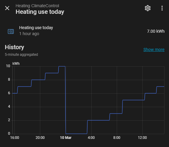

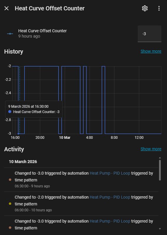

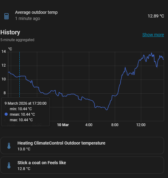

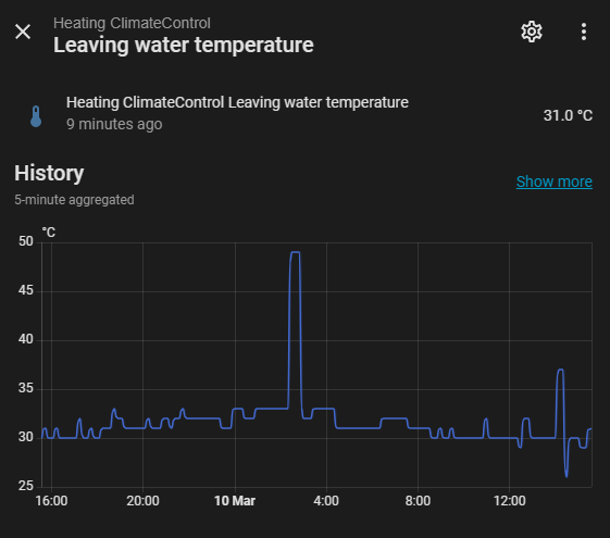

Ok so big update on this one. I’m now using a PID style controller that factors in my solar PV, weather forecasting and internal/external temps to refine and run the system. My system is running at its most optimal level and can now take advantage of solar gain as well as automatically turning on and off when long periods make it wasteful to run. Its a think of beauty.
code below…

further update, today is another good example of a coldish but very sunny day,
 ![image](https://community.openenergymonitor.org/uploads/default/original/3X/a/f/af781bcb02b91715358535457a4ab3f5afc59412.png)
 ![image](https://community.openenergymonitor.org/uploads/default/original/3X/2/e/2ecd63e76978d2d4502d6dc55980c9dc0d1d20f2.png)
 ![image](https://community.openenergymonitor.org/uploads/default/original/3X/d/b/db444799bd4fb4be329a537b5182cc956362e0e3.png)
 ![image](https://community.openenergymonitor.org/uploads/default/original/3X/1/f/1f2c1ef184c45052898d82cc22b89063d945b7b9.png)
Thats my general readings, so on the leaving water temps the 2 spikes are hot water cycles.
Today, the PID controller has kept it sat 3 degrees lower for a nice long steady period due to solar gain etc. Seems to be running very well, suspect today will likely 8 to 9kw of energy used across a 24h period which for an Octopus installed Daikin 8kw is probably the best i can hope for.
