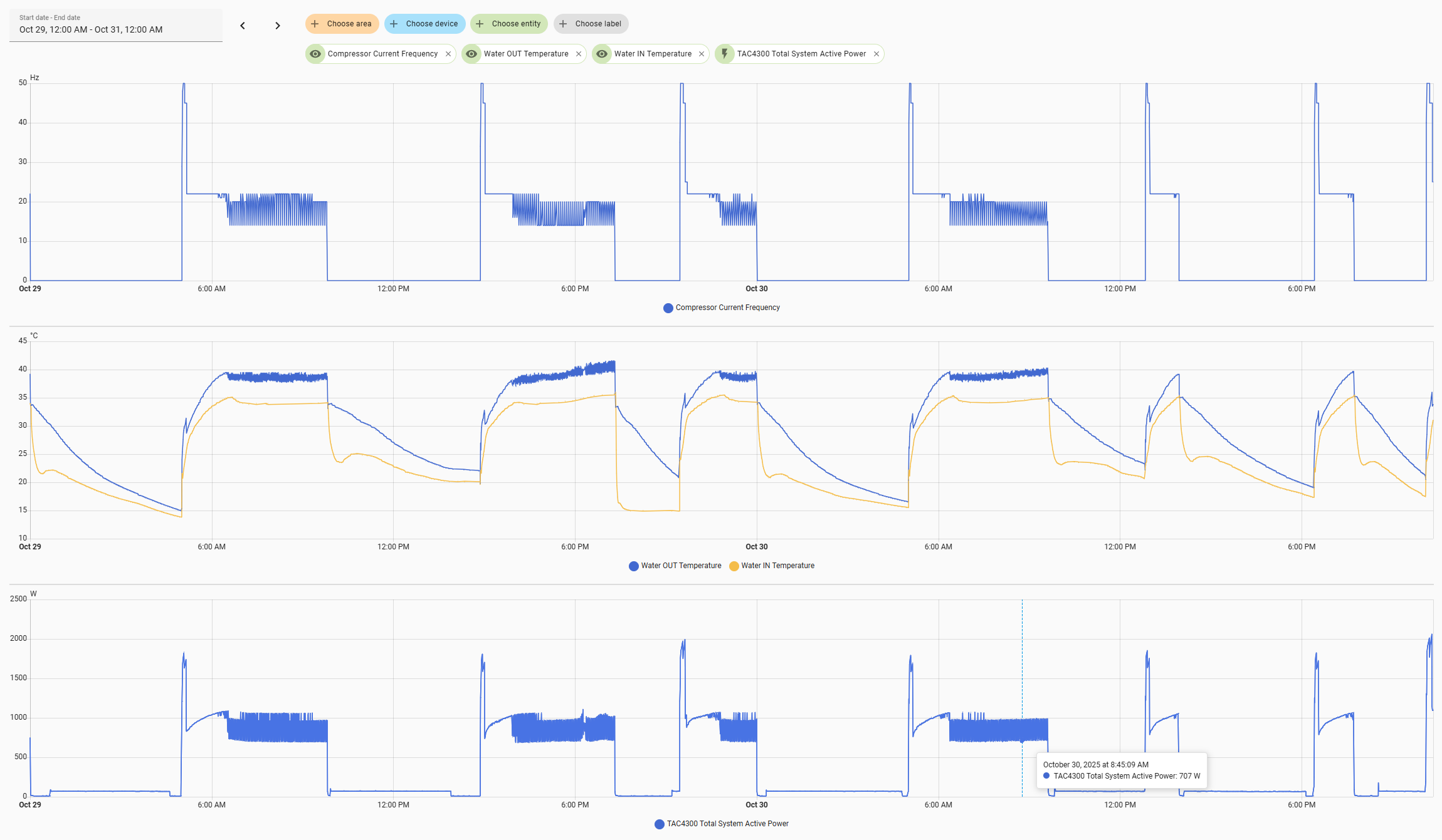

Daikin 8kw flow T and power are hunting and will not settle down
It does just seem to be what the smaller Daikin units do, especially at lower power input levels.
Its the input power which varies, which in turn causes the LWT to fluctuate. You never see the variation on the RWT because the water becomes too mixed as it moves around the central heating circuit.
I have a theory that the compressor speed (or input power maybe) is variable, but in fixed increments. When the input power fluctuates between two levels it is achieving an average power between its two fixed power levels by pulse width modulating between them, but that is just a theory.
COP is generally good so it just appears to be how they work. If you didn’t have monitoring you would never notice it.
Well exactly the same on my Samsung and I can’t figure it out. Seems really it starts when LWT reaches the target temperature and DT can’t be maintained anymore because I’m at lowest flow temp already. Compressor jumps from 22Hz to 14Hz and back every minute. I simply don’t understand why the pump can’t modulate much more smoothly. It happens more when it’s warmer outside and compressor is already running at low power. I’ve found enabling compressor frequency control help prolong this interval until it starts flutter but it’s only because the pump will start heat slowly. Seems for radiators with low water volume it’s a problem but matt mentioned he has over 300L in the system and still has these flutters. So I don’t know but it’s driving me nuts.
