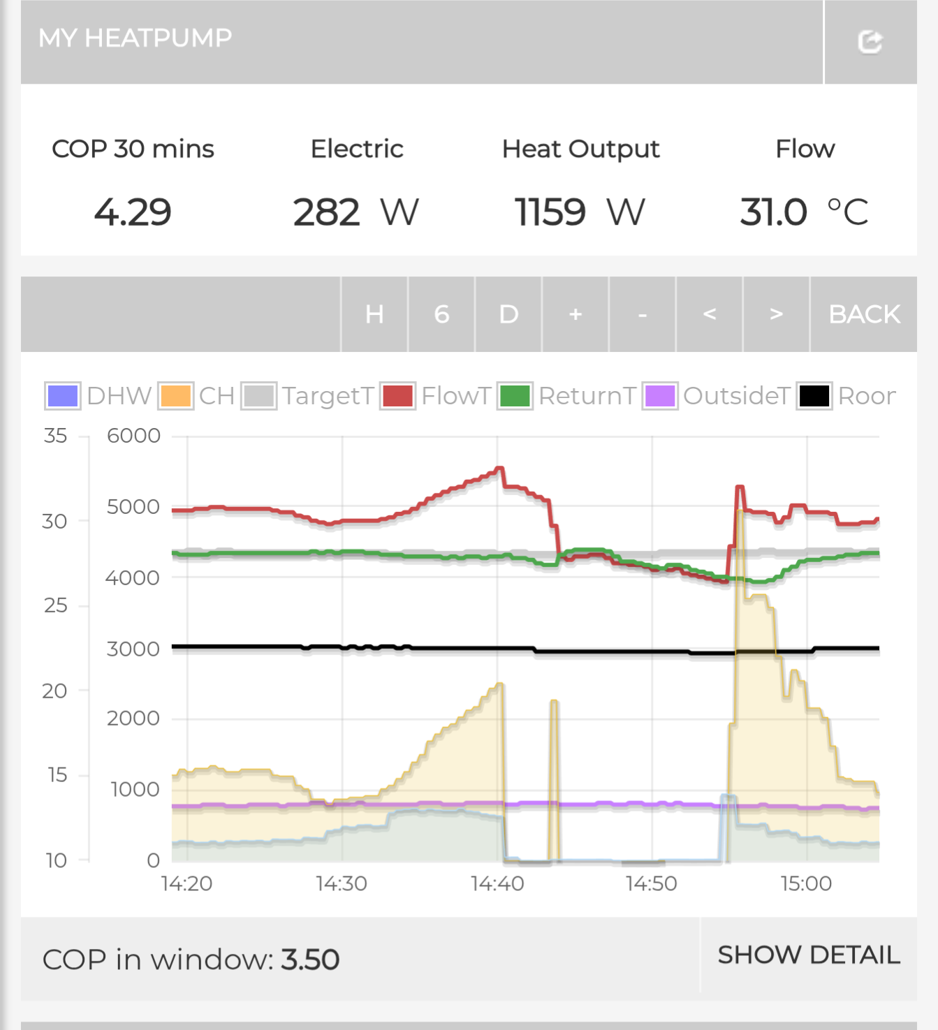

Daikin 6 kw randomly stopping today
Has anyone noticed any random stoppages of (daikin )
noticed this twice this afternoon , i do have the heat pump setup to shutdown at 14 degree outside temp but today its stopped producing heat on its own and temps were below 14 degree C
before starting up again ,
full day

Do you know what the LWT target was at the time?
There appears to be a distinct rise in flow temperature in the lead up to the shutdowns - maybe FlowT exceeded targetT + overshoot?
yes this definitely happened (overshoot ) on both occasions , the input power also went up
I have seen this before on my 6kW, not in recent days, but it happens from time to time. Most often after a period of steady running at a low level.
The source of the problem is the rise in input energy, this raises the LWT, and after a few mins the unit effectively cycles because the LWT has got too high. After a period once the LWT has dropped sufficiently it restarts as per normal.
As to why it happens I have no idea really. My best guesses are either it’s control system get itself into some sort of feedback loop where it raises input power and/or compressor speed more and more. Or it is some sort of self-maintenance thing like moving oil around the system or something.
Its weird but it does just appear to be a thing that these models do.
