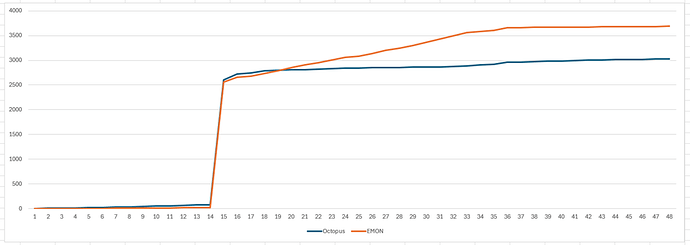

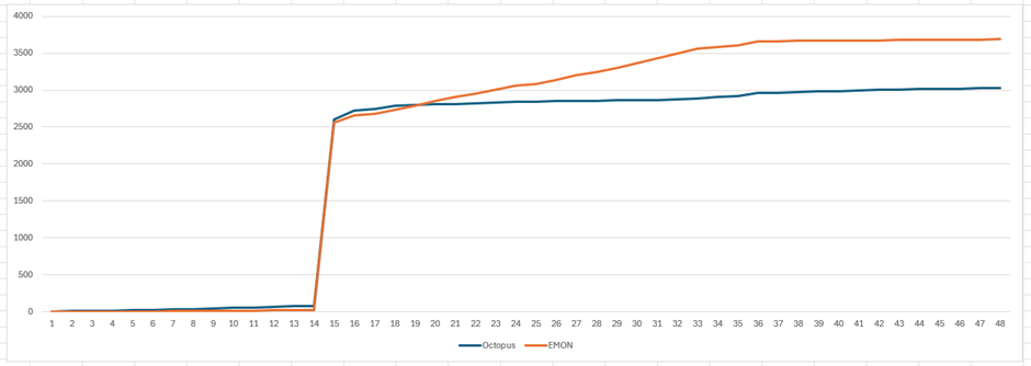

Since fitting the new battery that was a replacement for a powervault 3 (4kWh) I’ve noticed the import from grid reading are not very accurate when compared with the reading from octopus energy, I think there are two reasons for this:
  1. My use from the grid is much lower and any use from the grid is in large lumps (charge from grid)
  2. The input seems to have loads of little spike In the data these seems to happen in two occasions
    • when the battery is providing power to the house and the sun is down
    • When the sun has come up and the solar is charging the battery
The below shows the grid import Realtime trace for one hour – the battery is being charged during this snapshot my real use from the grid was 17Wh where as the emon pi reported 220wh

It may do, because the new emonPi2 uses a different input circuit configuration to the older emonTx’s and the original emonPi, but from what you’ve written the source of the problem is the new battery and its charger/inverter, and it really should be a case of tracking down the source of the interference and curing it at source. This will be a lot better than trying to filter it out once it’s go into the measurements. First thoughts are, is all the earthing correct (no paint under the case earth bonding leads, etc)?

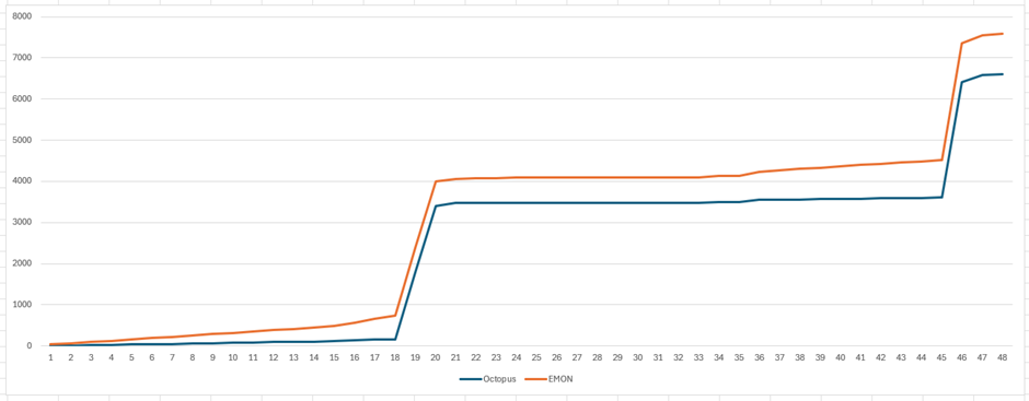

Some progress, I was using very old firmware, so I took the plunge, made a new SD, updated the firmware to the CM version, set up some inputs, just the one monitoring the grid for now and the averaging over 10 seconds has made a massive difference,
I’ve ordered a USB to UART cable so I can update the firmware to the tx3 to CM as I need 3 inputs (grid, solar PV & battery)
I’m in the UK single phase house.
The image you did not recognise was an image for octopus energy, was just to illustrate how good the inverter conected to the battery is at keeping the flow of energy to nothing
Good news, the CM firmware is much more accurate, looking like 1.8% out with no tweaking, firmware has been updated on the tx3 to CM

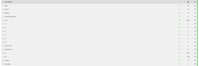

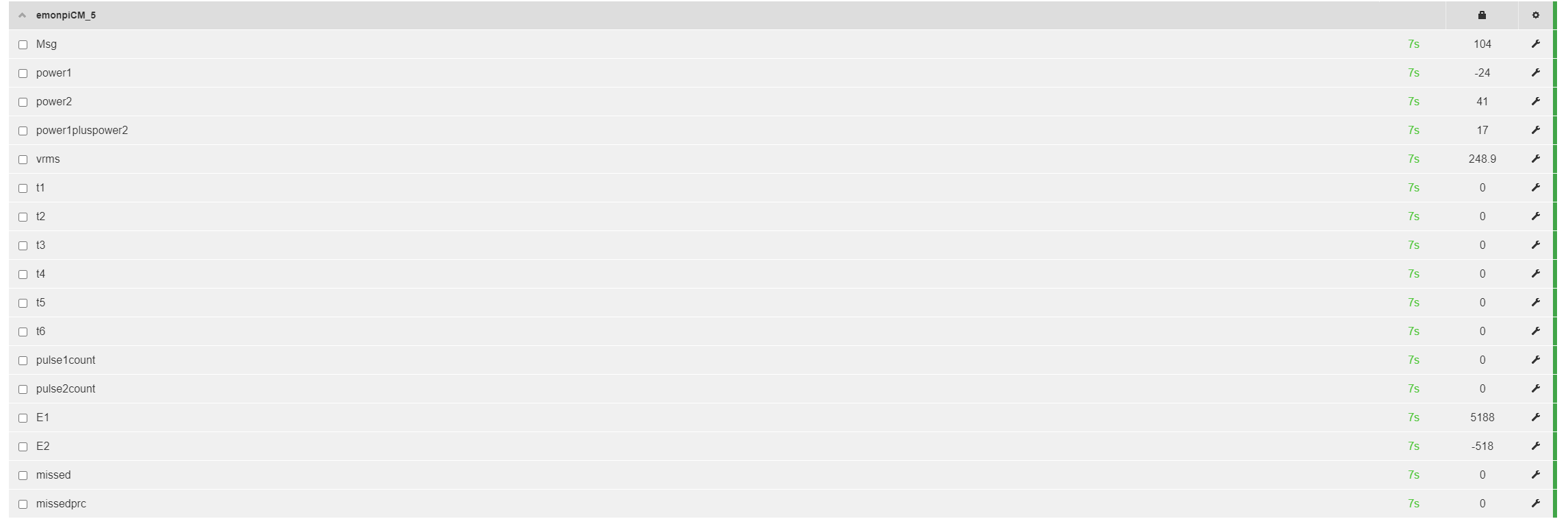

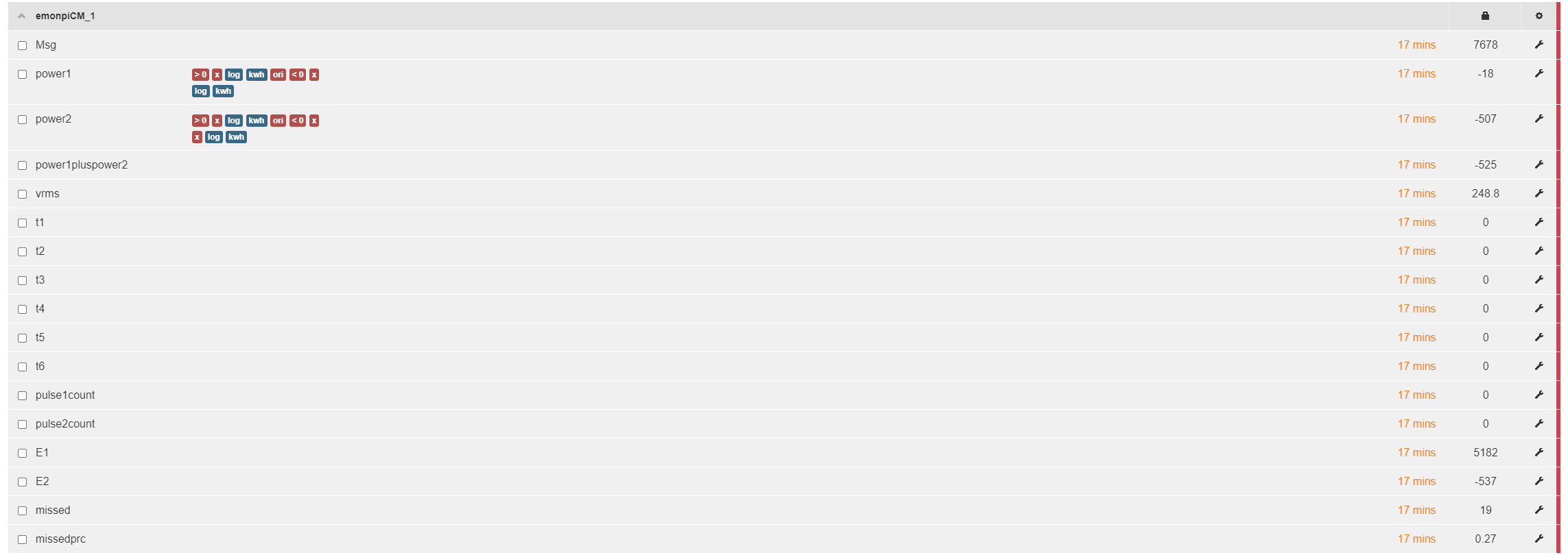

Bad news, difficult to explain but in the input view I set it up like this under emonpiCM_1
then randomly these feeds stop working as a new set under emonpiCM_5 have appeared?
Any idea?
It’s possibly due to Trystan’s “autoconfig” getting itself in a mess. I suggest find the line in your emonhub.conf and if it’s on, turn it off. Defining the Node exactly in emonhub.conf gives valuable protection against malformed data coming in. From what I can see, “autoconfig” throws away that protection.
If you look at the sketch you loaded into your emonTx, there should be a Node Definition in the source file, which (assuming you’re using the inbuilt radio to get the data to your emonPi) you copy into your emonhub.conf
