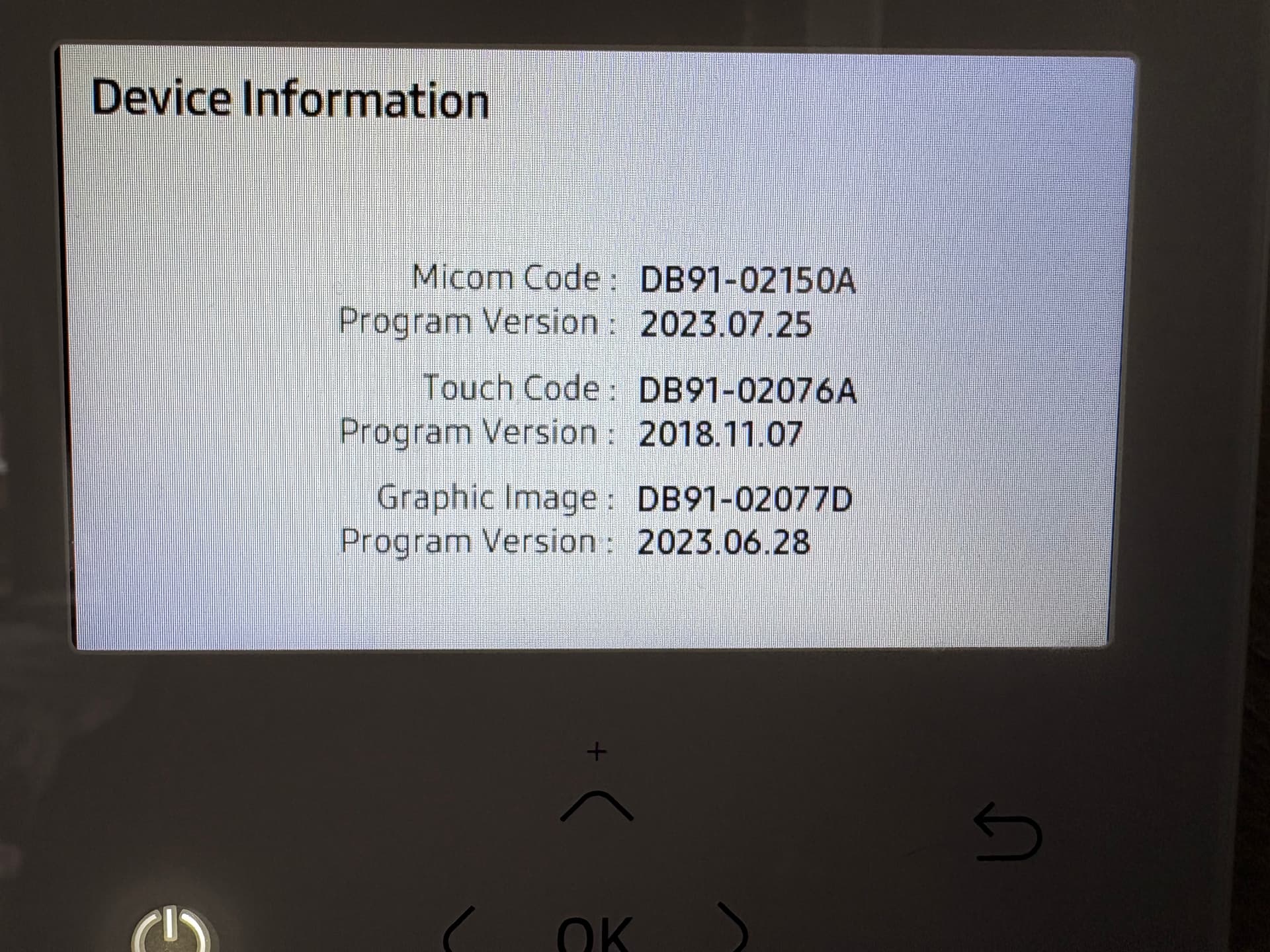

Hi Paul, my Samsung Mono Control Kit MIM-E03EN purchased in August 2024 has the following firmware (is this what you are referring to?) and does not run the circulation pump in summer and it also seems to modulate the LWT several degrees below the set weather compensation curve when above the target temperature. Is it this feature that improves short cycling?
Where can I find the adjustment to indoor temperature hystereses?
 ![IMG_0304](https://community.openenergymonitor.org/uploads/default/original/3X/e/f/efc4cb88850e839355854c46bd34396ecb785f0f.jpeg)

Hi Stuart,
That is the current software on the remote control, not the MIM. I don’t actually know a way of seeing the current version on the MIM other than through SmartThings or connecting the SNET interface.
Can you see and adjust FSV 1061 & 1062? If you can adjust them it sounds like you have the newer firmware already. If you can see them but the controller says not available you are probably on the older firmware. However from the behaviour you describe it does sound like it has been updated already or is the later board that shipped with newer firmware from the factory.

thankyou Paul, I can indeed adjust 1061 and 1062 so it must be the latest firmware. Apart from the water pump cycling the most useful improvement for me is the modulation of LWT. I can see it is working right now preventing an overshoot of target room temperature which would otherwise cause unnecessary cycling that many complain about.
It means that the setting of the weather compensation is not so critical and the controller can adapt to solar heat gain/wind chill effects and set backs like I described in my other post. [Finally understanding Samsung smart controller algorithms for the triple dip tariff set back operation](https://community.openenergymonitor.org/t/finally-understanding-samsung-smart-controller-algorithms-for-the-triple-dip-tariff-set-back-operation/29292)
