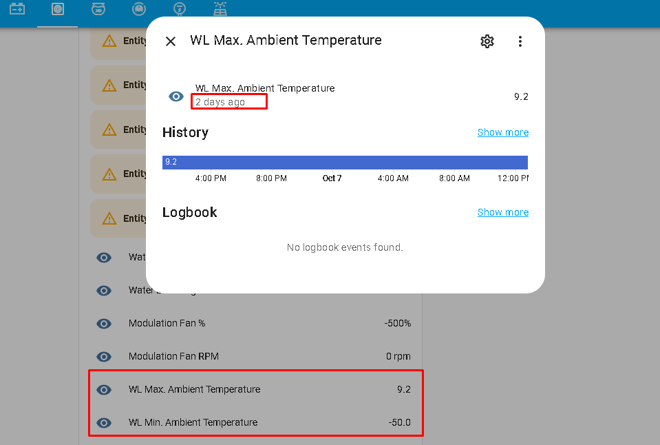

**Post date:** [7 October 2025 10:20 UTC](https://community.openenergymonitor.org/t/contribution-samsung-ashp-nasa-link-mqtt-bridge-home-assistant/26744/124 "2025-10-07T10:20:34Z")
Hi Sarah,
Thanks for the tip! This would be amazing if this works! I will give it a try for sure.
But currently what I need to achieve as well is to set #2021, #2022 and possibly #2041 and #2042. No matter I do nothing is written on that address. I’ve took it from NASA protocol but no matter what the values are not updated on those addresses. There is some value stored but some old one and not updating. This is when connected to F1 and F2 on modbus board (not control unit).
Do you have maybe an idea why ? Do I really need to connect to F3/F4 with @toadhall board to be able to change these stupid FSV values ? I saw you were able to do it in that windows tool over F1/F2 connected directly to HP control unit but why the heck this is not working via modbus 🙂 I just need it configure once and forget so maybe even your solution would be enough for me. So you are connected directly to F1/F2 on control unit?
Thanks for insights.
@toadhall do you still have some boards available ? I would be really interested to buy one because I need to find a way how I can change #2021 programmatically. Thing is, wired controller won’t allow me to use lower than 10C degree temperature and I need to set it to 0C@40C water temp. My pump is super inefficient with anything lower than 40 because I don’t have floor heating. If I set temp curve as I need then at 10+C outside it will use water temp around 30C which is unusable.
This with frozen modbus interface is interesting. Maybe that’s why #2021 FSV is not updating on mine but other values are updated so I don’t know. I pool the address but it still shows me some older value. How do you restart it ? Just cut the power to outdoor unit ?

**Author:** ![Michal\_S](https://community.openenergymonitor.org/user_avatar/community.openenergymonitor.org/michal_s/32/28455_2.png) [@Michal\_S](https://community.openenergymonitor.org/u/Michal_S)\
**Post date:** [7 October 2025 10:50 UTC](https://community.openenergymonitor.org/t/contribution-samsung-ashp-nasa-link-mqtt-bridge-home-assistant/26744/127 "2025-10-07T10:50:55Z")
Hi Topaz.
Yes exactly, that’s why I don’t understand it. It really looks like frozen.
I’m writing this to address 7000:

**Author:** ![Topaz](https://community.openenergymonitor.org/letter_avatar_proxy/v4/letter/t/e19adc/32.png) [@Topaz](https://community.openenergymonitor.org/u/Topaz)\
**Post date:** [7 October 2025 11:16 UTC](https://community.openenergymonitor.org/t/contribution-samsung-ashp-nasa-link-mqtt-bridge-home-assistant/26744/128 "2025-10-07T11:16:36Z")
From my understanding of the ASHP, the -50C is the default returned temp for unknown temp sensor ☹
