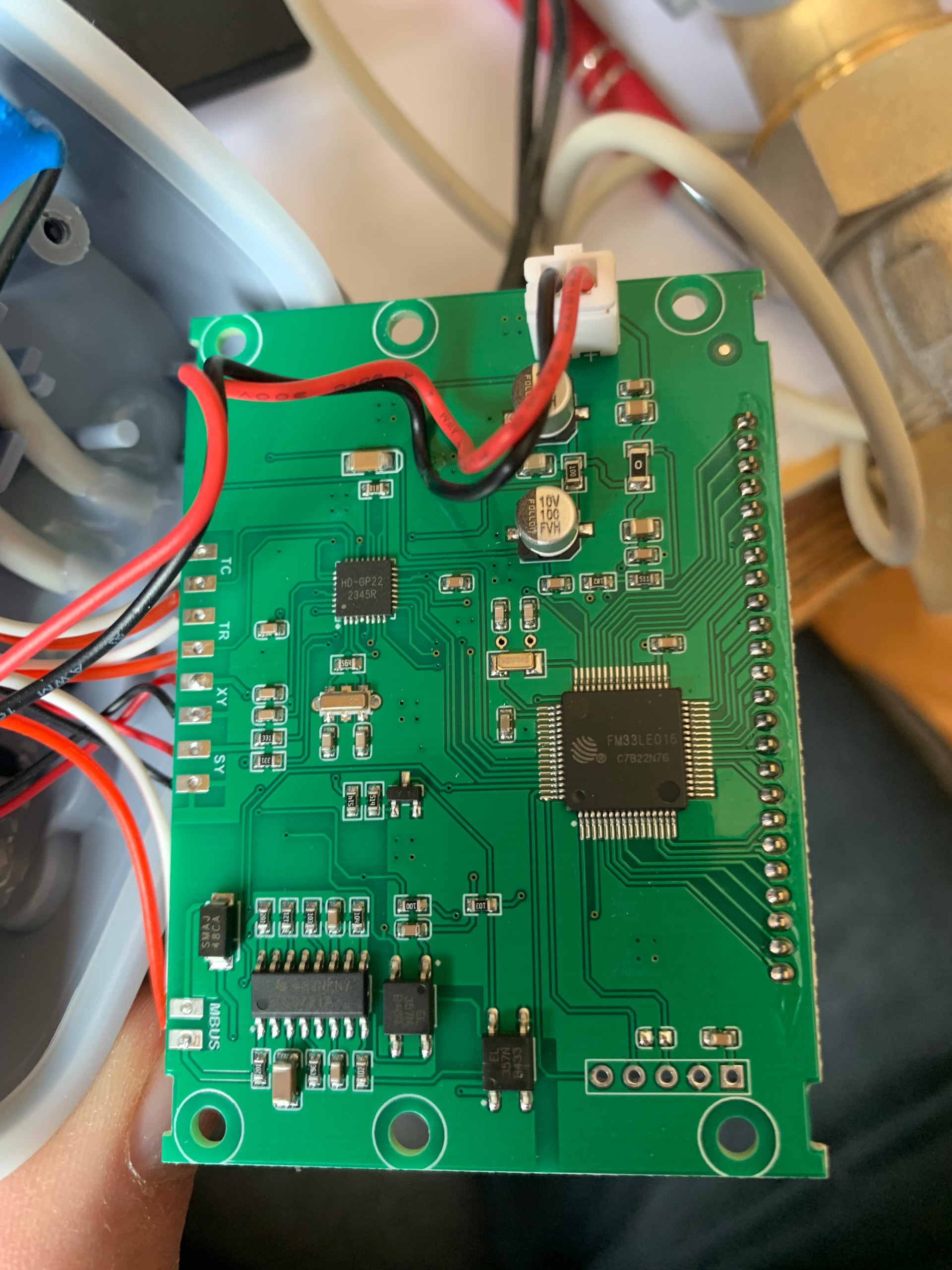

Hi David,
I have the same model; opening it has the telltale M-Bus transceiver chip from TI TSS721A - but I also have not yet been able to communicate with the meter at all…
Did you ultimately find a solution?
Have you tried the IR interface as an alternative - maybe the wired M-Bus needs to be activated somehow before becoming responsive?

Hello, no never able to communicate with it, I gave up in the end after wasting a lot time, with no real explanation for the seller. At the beginning the display showed the correct numbers. It’s a shame it doesn’t work, after removing from my heating system I found lots rust particles in its pipe work and wondered even if had worked if it would have been accurate.
Did you try communicating with the IR sequence?
The ir led and receiver seem awfully close to the tss721 mbus transceiver
Or can you describe your attempts so i don’t have to repeat them all?
Do you still have the documentation which were mentioned in another forum? Since the heat meater has an internal date/time clock, there must be a way to set that up… Presumably the M-Bus could double as S0 interface (one pulse per x.xxx kWh), be disabled, or run the full M-Bus protocol… (I don’t know if the TSS721 could be made compatible with RS485 though.
Hello, I have many files in connection with the meter, I have made zip file here
energy meter.zip (8.5 MB)
take a look you might find something to get it working
