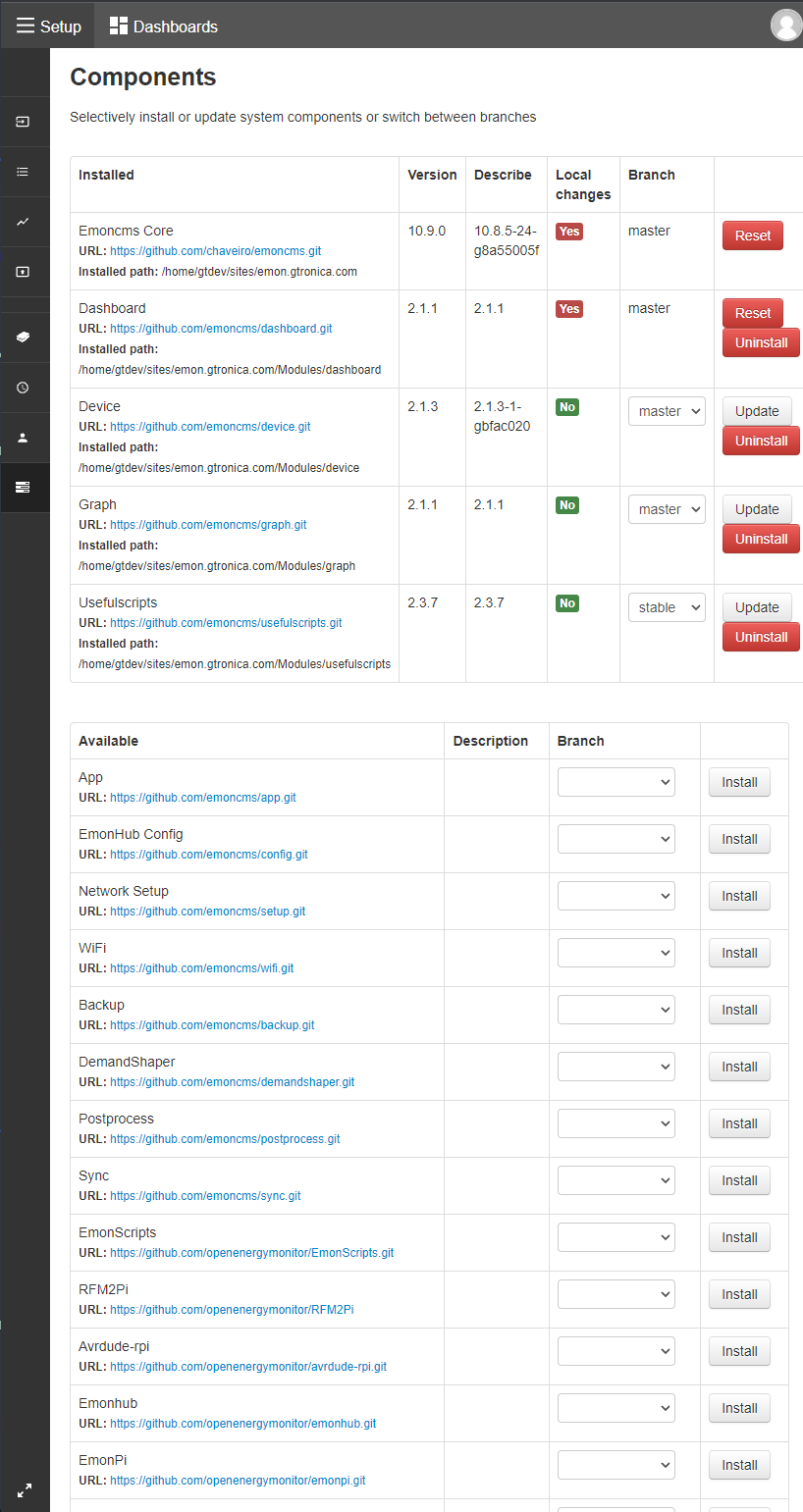

A very useful feature that is not working for me as i’m on a shared server, so I’m trying to make the components update run without redis or service-runner.
## Issues to solve:
##### 1 - Use git directly from PHP when service runner is not available, or always?
##### 2 - How is this file updated? Why not make this a universal github RAW url to the latest file?
- /opt/openenergymonitor/EmonScripts/components\_available.json
##### 3 -Remove hardcoded absolute paths:
Are they used in any place ?
> <https://github.com/emoncms/emoncms/blob/f1c5ee0c58b722e128961cf0ceac6175a7c2d0e7/version.json#L4>
> <https://github.com/emoncms/device/blob/28fb5f6dfb9282d0dee9c8cd76fc981792888d4c/module.json#L4>
##### 4 - Where are the source for this files?
- /opt/openenergymonitor/EmonScripts/update/update\_component.sh
- /opt/openenergymonitor/EmonScripts/update/update\_all\_components.sh
@TrystanLea please comment on the topics above.

**Author:** ![nchaveiro](https://community.openenergymonitor.org/user_avatar/community.openenergymonitor.org/nchaveiro/32/12392_2.png) [@nchaveiro](https://community.openenergymonitor.org/u/nchaveiro)\
**Post date:** [30 September 2021 08:18 UTC](https://community.openenergymonitor.org/t/components-update-working-on-shared-servers-without-redis-or-service-runner/18621/12 "2021-09-30T08:18:46Z")
Update on this topic, added the new features to the components page to install/uninstall modules working with php at [Revamp Admin Module by chaveiro · Pull Request #1732 · emoncms/emoncms · GitHub](https://github.com/emoncms/emoncms/pull/1732) :
 ![image](https://community.openenergymonitor.org/uploads/default/original/3X/d/8/d8d3b28bd51b8d6064343d60d52955ea3ad12125.png)
