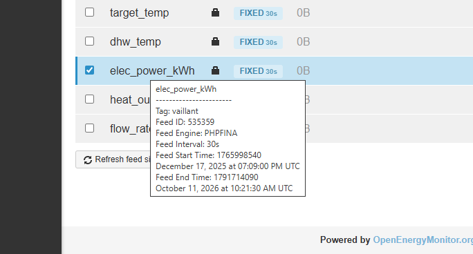

**Author:** ![Dan\_Grey](https://community.openenergymonitor.org/user_avatar/community.openenergymonitor.org/dan_grey/32/29264_2.png) [@Dan\_Grey](https://community.openenergymonitor.org/u/Dan_Grey)\
**Post date:** [11 October 2026 10:35 UTC](https://community.openenergymonitor.org/t/can-i-export-half-hourly-electricity-consumption-from-emoncms-org/30422/3 "2026-10-11T10:35:56Z")
Hello Trystan,
I’m exporting elec\_power\_kWh:
 ![Screenshot 2026-10-11 113110](https://community.openenergymonitor.org/uploads/default/original/3X/7/3/73b8df2f891f820ec08481eef965947b042a1323.png)

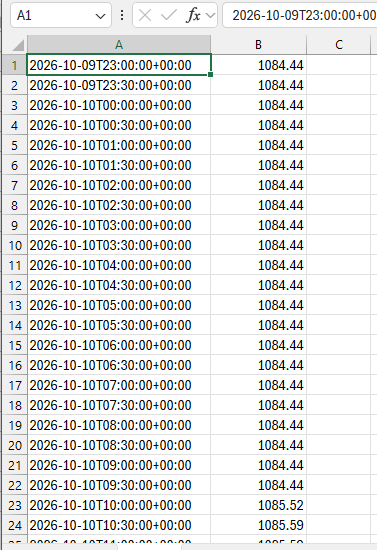

And this is the result:
 ![Screenshot 2026-10-11 113156](https://community.openenergymonitor.org/uploads/default/original/3X/8/0/80181d4d41efeecdb8fbe4b21e5ea3f7cc6d76e2.png)
I think that’s total electrical power since oem recording began, isn’t it? So the number increments by however much energy was used over the previous 30 minutes. Is there a simple way to download only the increment, or shall I just figure it out how to extract the increment at my end? Probs pretty easy with a bit of AI-provided code!
I see your [page on using AI agents to analyse data from the API](https://docs.openenergymonitor.org/emoncms/agents.html), so might give that a try instead, although my data is in [emoncms.org](http://emoncms.org), not a local install.
**Post date:** [11 October 2026 12:50 UTC](https://community.openenergymonitor.org/t/can-i-export-half-hourly-electricity-consumption-from-emoncms-org/30422/4 "2026-10-11T12:50:40Z")
Hello @Dan_Grey
> [@Dan\_Grey](#):
If you are using the CSV download tool on the feeds page, the option to do this isnt actually broken out on the UI easily (I should add it!). If you use the Graph page CSV export tool you can select delta mode on the feed config.
Here’s an example python script generated quickly with claude just now, this uses delta=1 to conver the cumulative kWh data to kWh per half hour:
Prompt example:
> Please write a simple python script to download half hourly kWh data from an [emoncms.org](http://emoncms.org) feed. Use delta mode on the [emoncms.org](http://emoncms.org) api, output the result to a csv file, implement this in the least lines of code possible and make it very easy to understand.
Resulting script:
**Post date:** [11 October 2026 17:37 UTC](https://community.openenergymonitor.org/t/can-i-export-half-hourly-electricity-consumption-from-emoncms-org/30422/5 "2026-10-11T17:37:49Z")
That code worked a treat, thank you!
