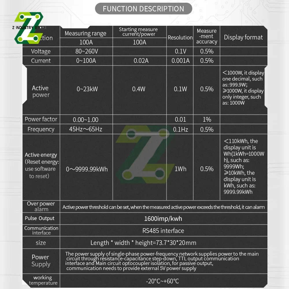

It’s not the standard monoblock outdoor unit to most of the Daikins on there. The EPGA011-016DV7 has 3.5kg of R32 compared to 3.80kg of the EDLA units so I would suspect a different compressor or setup. I also have around 950m of UFH pipes at 100mm spacing so probably able to maintain lower flow temp without overshooting quite as much as those on radiators.
The PZEM has voltage input and PF monitoring:
 ![image](https://community.openenergymonitor.org/uploads/default/original/3X/f/2/f23b62158f99d372be2bf7d070f09aa743ea3d77.png)
I’d be more worried about the accuracy of the thermal output from ESPAltherma - the return inlet temp (R4T) is only accurate to 0.5C on this model.
I could turn off some circuits so only the heat pump is on and see if my IHD/SDM230 matches the PZEM reading, but I’ve never had reason to question it’s accuracy before when it was doing whole house metering as it always tied in with IHD reading (granted that’s not going to be skewed much by motor/compressor PF).
Oh and the UFH is measured by a shelly PM and included in the readings - but its only 25W or so.
**Author:** ![rupert](https://community.openenergymonitor.org/letter_avatar_proxy/v4/letter/r/f14d63/32.png) [@rupert](https://community.openenergymonitor.org/u/rupert)\
**Post date:** [22 February 2024 13:09 UTC](https://community.openenergymonitor.org/t/calling-east-midlands-11kw-daikin-owner/25626/6 "2024-02-22T13:09:03Z")
Just by coincidence, I have a similar PZEM-004T module in a case, that I bought to play with (!). The main chip is a Vango V9881 energy meter chip. Searching with Google, the chip data sheet is available online (284 pages!). It does all the normal energy meter measurements, including power factor, frequency etc, and has a specified active power measurement accuracy of 0.5% …
So it should be ok … 🤔 YMMV
edited to add - assuming that the PZEM-004T module is correctly calibrated.
and - one further point - the voltage and current sensing on the PZEM-004T are both on the live mains side - one side of the CT is connected to the neutral terminal of the PZEM-004T. The PCB has mains voltages on it. The mains isolation is done on the data output side of the V9881, using optocouplers. The PZEM-004T schematic can be found on the web.
So you need to know what you’re doing for safety’s sake!

**Post date:** [22 February 2024 16:13 UTC](https://community.openenergymonitor.org/t/calling-east-midlands-11kw-daikin-owner/25626/11 "2024-02-22T16:13:42Z")
Ok great, apologies for jumping to conclusions regarding the power meter, I could only see the CT sensor in the photos. It does indeed have Real Power, it claims 0.5% which if true is more accurate than MID meters! Impressive.
[![](https://ae01.alicdn.com/kf/S1f414f05008d480293d6fcf02b84827aQ.jpg) ](https://ae01.alicdn.com/kf/S1f414f05008d480293d6fcf02b84827aQ.jpg)
