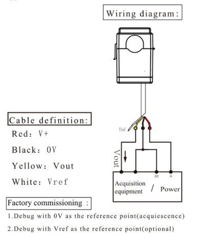

Hey community,
I am using the HSTS016, range 100A, I am trying to calibrate it using an ESP32 in order to measure DC current, the problem is whatever I do to make it work it gives me values like literally non sense. Another thing, I cannot exactly understand the role of the Vref pin, like trying to find something useful in the datasheet but I find nothing.
Please, if anyone worked with it before, tell me.
Thank you,

Actually, the HSTS016L is a hall effect sensor not a current transformer sensor, so it measures both AC and DC

I see what went wrong. Google returned the wrong data sheet and called it a current **transformer**. It is not.
Now I see also what you mean by Vref - it is not the ESP32’s pin, You connect a stable and accurate 5 V power supply between 5V and GND, and the output will be at 2.5 V ± 0.625 V 15 mV with no current flowing. You will need to measure, but I _think_ Vref will be at the same d.c. voltage, that is, you can use Vref and the output to feed into a differential amplifier, to remove the effect of the ± 0.625 V 15 mV error. If this does not appear to be the case, leave it not connected.
[This data sheet](https://cdn.shopifycdn.net/s/files/1/2723/6858/files/HSTS016L_2.5V_0.625V_5V__1_c1bbdd67-912c-4dbd-91c0-aa8bca399eda_2048x2048.jpg?v=1669012946:) seems to indicate the same thing:
 ![image](https://community.openenergymonitor.org/uploads/default/original/3X/4/7/470c0d373d336adf1228f896324448edf07db5bb.png)
This also gives the calibration equation.
 ![image](https://community.openenergymonitor.org/uploads/default/original/3X/c/9/c983f2a39c730727b25b180b8fc0a843fb12bb51.png)

> [@Robert.Wall](#):
> to remove the effect of the ± 0.625 V error
Just a nit, but the ±625 mV is the output, not the error. The V\_REF pin can be used to subtract out the ~2.5 V bias correctly, which you have [alluded to in the past](https://community.openenergymonitor.org/t/calibration-value-in-case-of-hall-effect-sensor-with-voltage-output/19406/2). As is typical, the datasheet is terrible but the reference pin is described across a few implementations.
**Post date:** [27 January 2025 12:35 UTC](https://community.openenergymonitor.org/t/calibration-of-the-sensor-hsts016l-range-100a/27827/7 "2025-01-27T12:35:05Z")
> [@awjlogan](#):
Agreed - the error is 15 mV. But the first data sheet I looked at was even worse - that’s where the 625 mV read as if it was the offset bias error.
