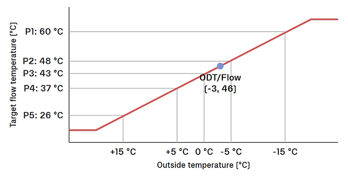

A question for all you experts.
I have a AIRA Heat Pump system which has virtually no user controls or information on flow, return temperatures or water flow rates (or anything else, not even the temperature of the water in your hot water cylinder).
They claim it follows a curve which they can email to you
 ![AIRA Weather Curve](https://community.openenergymonitor.org/uploads/default/original/3X/5/f/5fa7f5000cfb4bc1f1bef00d475a2b6056518d15.png)
I have fitted my own flow and return rate sensors but what I am after is a more detailed graph giving you the information per degree c so for any outdoor temperature it will give you heat pump flow temperature. The idea being I can see if the graph is being followed.
Any thoughts please?

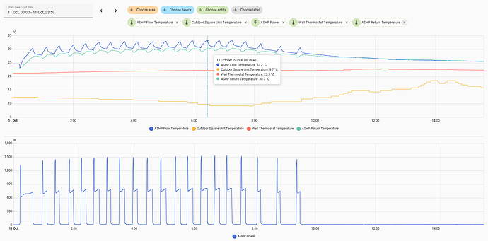

 ![Screenshot 2025-10-11 153548](https://community.openenergymonitor.org/uploads/default/original/3X/4/5/45c22ca8ad0df9b64b337d7261c6c3a02428f448.png)
**Post date:** [11 October 2025 17:24 UTC](https://community.openenergymonitor.org/t/calculating-the-optimal-weather-compensation-curve/24799/8 "2025-10-11T17:24:07Z")
Your approach makes sense, but as your heatpump is cycling a bit you won’t directly see this since the actual flow temperature will oscillate around the target. Try averaging over mutiple cycles and see whether it fits.
However I don’t believe this curve as it makes no sense. It’s fully linear, and all heatcurves I’ve seen are sub-linear as convection heating by radiators and UFH increases more strongly than with deltaT.

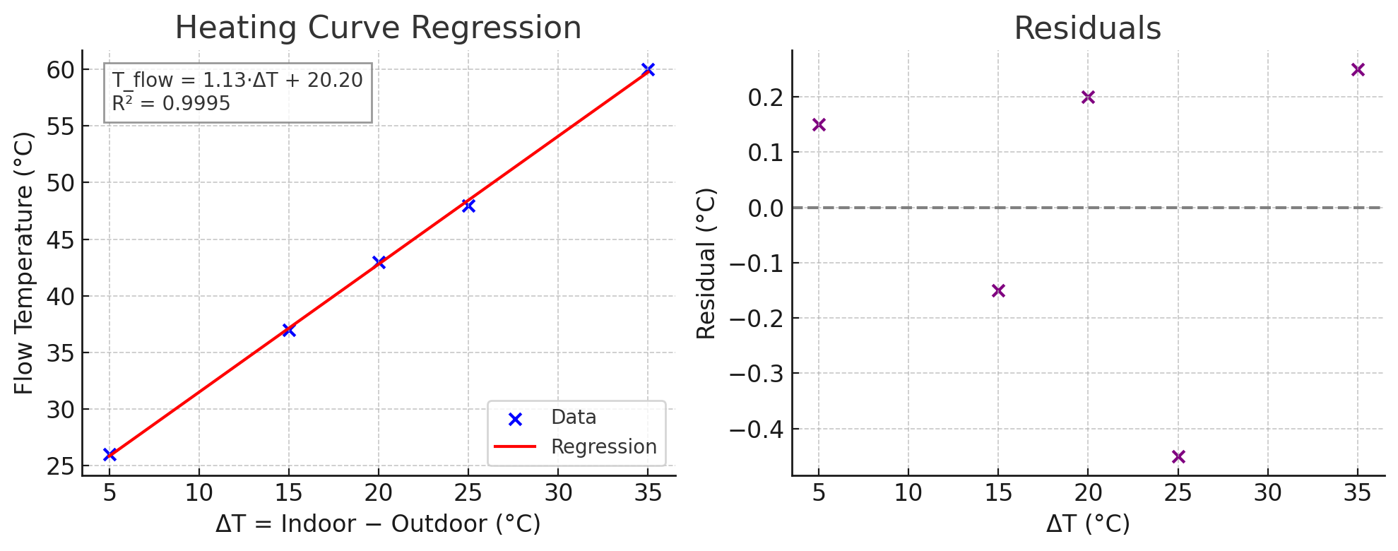

 ![output](https://community.openenergymonitor.org/uploads/default/original/3X/5/8/587696e98b963a309045e90a54a7a72e37d3bd42.png)

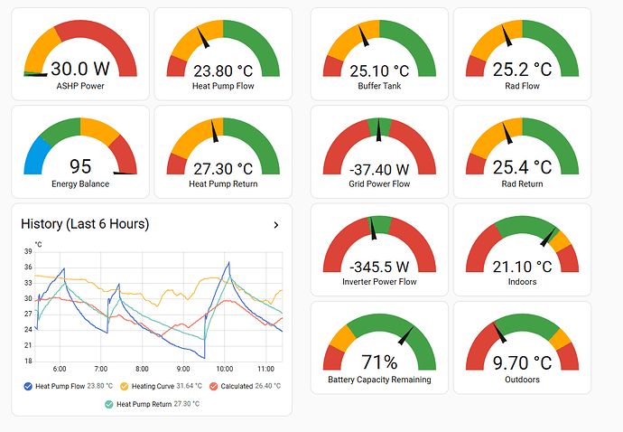

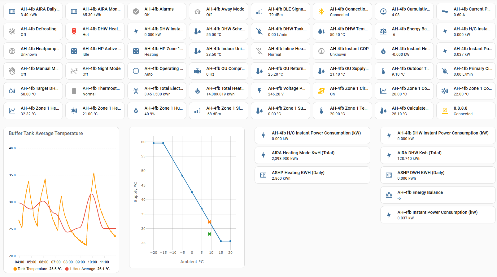

Don’t tell AIRA but some clever folks have created a Home Assistant app which allows you to at least monitor it more but no more control than the AIRA app offers.
Visit [https://airausersforum.com/](https://airausersforum.com/) for more information and general support for the AIRA system.
A screen from my system using HA also monitoring my solar and battery status.
 ![Screenshot 2026-05-13 112412](https://community.openenergymonitor.org/uploads/default/original/3X/0/4/04b7c2049468c75218107f86d5a6563e656db98f.png)

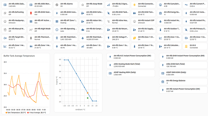

If you are not already running Home Assistant (best on a Pi and must have Bluetooth and be within range of your AIRA indoor unit) I would get that up and running.
The following screen lists most of the data you can get from the system (there are a few more).
 ![Screenshot 2026-05-13 115702](https://community.openenergymonitor.org/uploads/default/original/3X/0/2/02980765a4c9741d49b386d852d9f9daab4041f6.png)

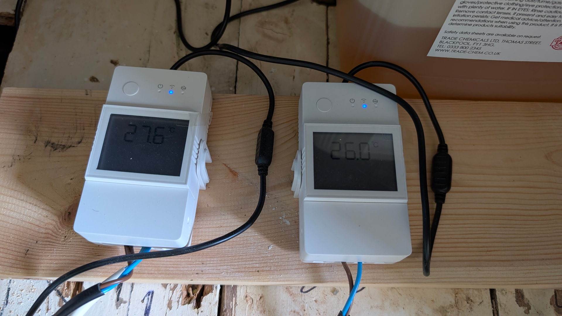

I have extra sensors on the central heating radiator flow and return temperatures (AIRA doesn’t monitor that).
I use THR320D by SONOFF with the sensors cable tied to the pipes which you can add anytime.
