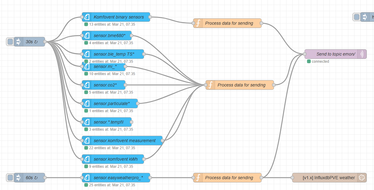

I pull this sort of thing off using Node-RED addon in HA. Just pulls everything that is a ‘temperature’ sensor, packages the data into a JSON and sends it across.
I do it for lots of different sensors
I do not create all of them into feeds, but it does mean if I add a new sensor to HA the data just gets sent to emoncms.

7
Sort of. Using Node-RED I can control the rate of update so I trigger these to send a new value every 30s. I also send a time with it so all the items get the same timestamp in emoncms.
