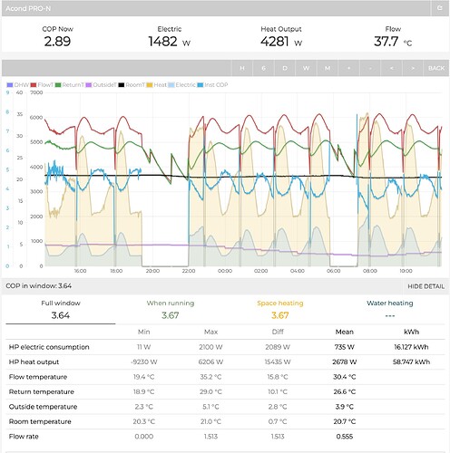

So after a longish journey getting my ASHP upgrades done (new rads, 22mm copper main runs) Last September I had a local heat geek make some changes to be able to use the existing buffer as a volumiser. Some caveats to this is that when running as a volumiser flow rate drops to 0.63 vs 0.85 when a buffer resulting in a DT of circa 7.5˚C for a time.
Buffer Tank
 ![with buffer tank - no hot water](https://community.openenergymonitor.org/uploads/default/original/3X/8/d/8d13790cefc75db1dffd92bcad22fe8405ff9f41.jpeg)
Volumiser
 ![with volumiser - no hot water](https://community.openenergymonitor.org/uploads/default/original/3X/6/d/6d003e90b3388ea9fa3fa5315128b29cc0efb964.jpeg)
Not quite as dramatic a difference as one might expect (while being in the real world in uncontrolled conditions but as close as I could get it as least over two days). 800watts less electric used and very slightly higher COP. However when running with the volumiser the heat / electric output is a lot more erratic and if it hadn’t turned for for a few hours, then electric usage would have been the same or more over when it was running in a buffer config.
Upgrading to a larger pump (quicker and easier), or increasing to 28mm from the tank to a central point may improve things when running in a volumiser configuration. But the I much prefer the output when running as a buffer, electric usage being more predictable and lower higher draw for the batteries.
Just thought I’d share as I doubt many systems can switch from one to the other config and for my install it’s not as bad as I thought it would be when running in a buffer config.
