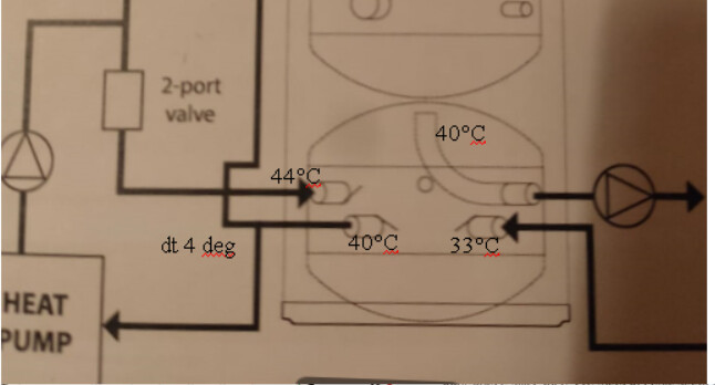

Not really engaged with your figures properly, but I would generally think that there isnt a lot of saving by removing a pump.. i.e. a single pump would need to be on a higher setting (more pressure head) than two on a lower setting (the same quantity of water is circulated weather 1 or 2 pumps on the system).
That aside, there could be more COP drop with a buffer due to mixing.
These are tempeure measurements from a system. To get 40c to rads, the HP flow has to be 44c
This probably drops COP by around 12%
Ok. Thanks for that input John.
I was assuming that both my pumps are actually on maximum flow. The internal pump shows 860l/hour on the controller. Maybe that is a Vaillant thing as 860l/hour is the maximum flow rate that the pump is capable of according to the Arotherm+5kW documentation.
I believe it is possible to change this in the settings, but most of the Arotherm+5kW on HPM seem to show same 860l/hour (14.3l/min).
The secondary Grundfos pump has also been set to maximum constant flow (setting III) - not sure this is by design or by default.
Vaillant’s COP figures obviously measure the values in the outside unit and take no account of additional electrical usage of pump and controls or any heat loss in pipework.
So for Feb - Vaillant app gives average COP as 4.30. If the additional electrical energy is added in, this drops to a COP of 3.78. I think the secondary pump uses about 50Watts.
My own not that accurate DIY heat monitor setup also gives an average COP of 3.85 for the same period. I measure the flow and return temperatures next to the buffer ports.
Yes maybe an efficiency drop due to the buffer. It is the short stubby 30litre stackable one from Vaillant with all of the ports at the same level so mixing inevitable unless these is something clever inside it.
Turning it into a 2 port volumiser might help, but I thought that would mean removing the second pump.
