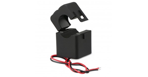

The CT sensors I purchased were these because they fit (snug) on my cable diameter:
Summary CT = 16mm inner diameter, 42 ohms internal resistance, 100A/100mA 1000:1 ratio

Yes they will, but you’ll have to change the burden resistor inside the emonPi - or add another externally. All you need is another 22 Ω in parallel with the one that’s fitted. If you’ve already built your own energy monitor, that shouldn’t present a problem. Doing that modification means you won’t need to change the calibration in the software. (And if you don’t do it, you’ll only be able to read up to 50 A on each leg of your supply.)

The better, safer method is to have the parallel burden resistor external to the emonPi. Your c.t’s don’t have a protective zener diode, which means without a burden, they’re at risk of damage if unplugged while current is flowing in the cables they are clipped around. The resistor can be anywhere on the cable - where you extended the leads looks to be a good place. It is of course connected in parallel with the c.t. and the plug. (A ¼ W resistor is plenty - the power in it will be 220 mW worst case (i.e. with 100 A flowing, c.t unplugged, normal use will be 55 mW max).
If you don’t fancy doing that, and want the resistor inside, and if you do buy the assembled emonPi, you’ll first need to disassemble it. With nothing connected, take off the acrylic end (nearest the pushbutton, a T20 screwdriver is required), and slide out the display and the Pi plus the ‘emon’ part together just an inch or so, taking care not to strain the push button and display connections.
If you now look down behind the two 3.5 mm sockets, you’ll see the burden resistors - the big ones labelled “22R0” - with a hole for a wire-ended resistor at each end. That’s where you solder in the second parallel 22 Ω resistors.

The CTs state in their product guide (link above) that they have an internal resistance of 42 ohms. quote " Internal resistance: 42Ω "
I believe the emonPI comes with small 22 ohm resistors already installed in parallel. I can see from the pic you uploaded above.
And you’re suggesting that I need to install an additional 22 ohm resistor onto the CT lines in parallel, one for each line.
Am I correct in thinking that in order to adjust the circuit to accommodate my CTs and power environment, we are looking at 42+22+22 = 68 ohms in parallel is where I need to get to?
cheers
That’s exactly right, and as you should have expected. Two times too much, to be precise. And your maximum current will show as 100 A, but will be only 50 A.

No. That’s wrong on two counts.
First, the 42 Ω is irrelevant.
Second, resistors in series add up like that, resistors in parallel add as the reciprocal of the sum of the reciprocals, so 1 ÷ ( (1÷22) + (1÷22) ) = 11 Ω.
Those resistors are ½ W, so they are probably too big to fit between the holes in the PCB, you’ll need to either stand them on end, or (safer - you can unplug the c.t. without risking damaging high voltages) connect them across the white and black wires from the c.t. where you’ve extended them to the jack plug.
It’s safer because a c.t. is a current source. It will try to generate whatever voltage is necessary to drive the current it wants to into the load (or burden). You can always safely short-circuit a c.t., and it’s actually then working under no load. If you leave it open-circuit, it will generate a high voltage trying to force a current that can’t flow, and may well damage the insulation inside and destroy itself. If it doesn’t damage itself, it will probably need demagnetising to restore accuracy.
