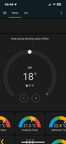

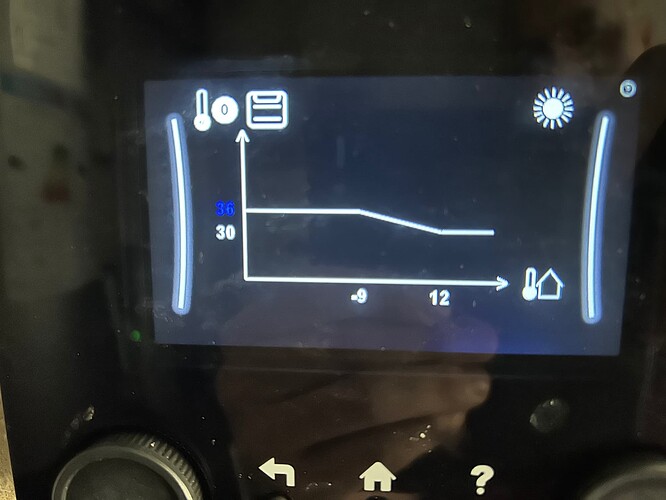

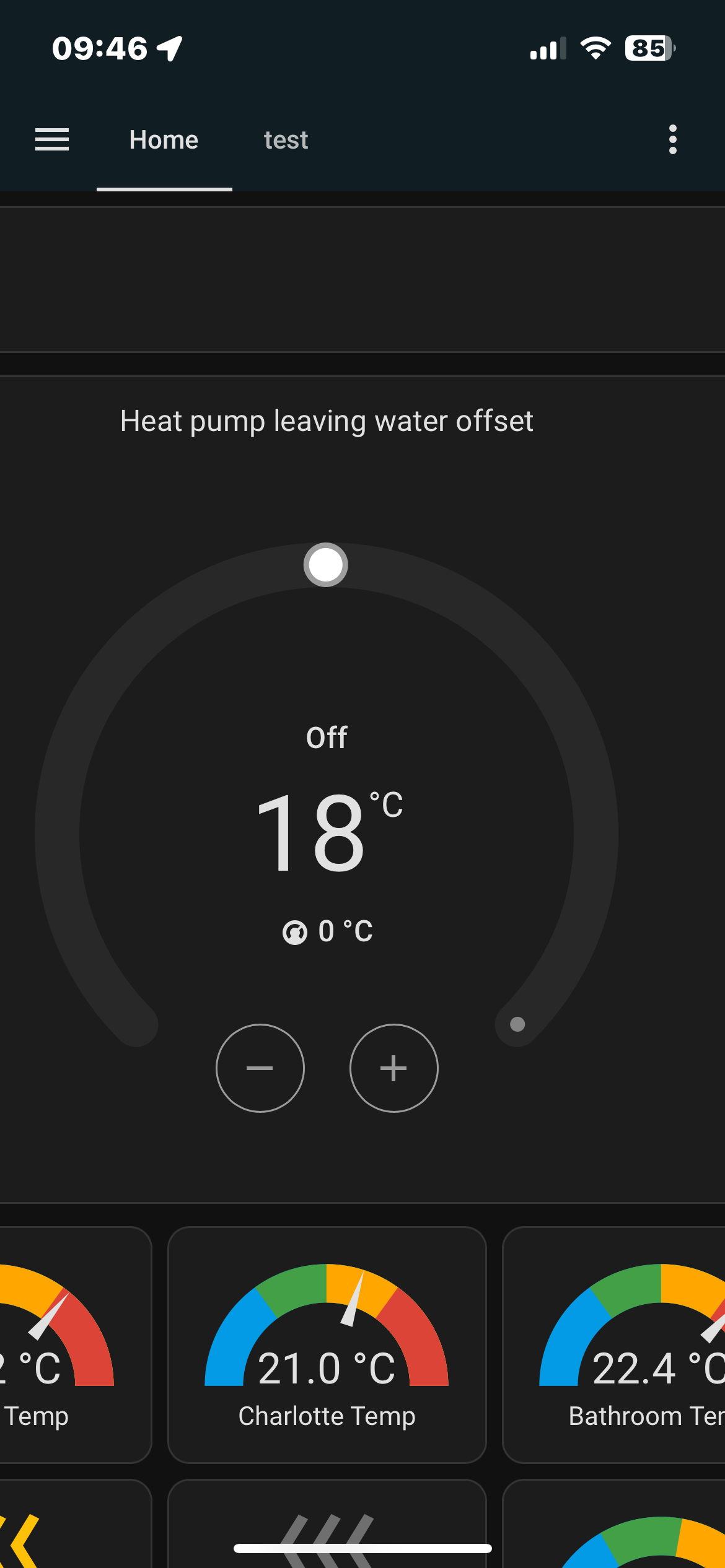

I spent most of my first year tuning in my weather compensation curve and have got it very close to a perfect curve for my home and setup
 ![image](https://community.openenergymonitor.org/uploads/default/original/3X/7/9/7912cc30d1872e43fa5c83c766fa45f714a0978c.jpeg)
but i have noticed that there are some events ( weather events like humidity and wind chill and rain ) that can throw the curve out, causing the home to fall in temp or raise in temp. Also the amount of people in the home can effect a perfect flow temp.
so i have used this very useful tool from Daikin integration with Home assistant to pull the flow temp of the weather curve by 1 degree + or - based on the internal temp rising or falling
 ![image](https://community.openenergymonitor.org/uploads/default/original/3X/9/4/9407ffd90bcfb4095eb5850c2462e4b2f6e201d6.png)
this allows a off set of the flow temp if there is a event (double amount of people in the home ) or other event throwing the curve out ,
thought i would share if anyone else has found they are constantly changing the curve because the above conditions are changing what heat demand is of the home is needed to keep a constant temp in the home
if anyone else has any comments on this or doing something different please comment below

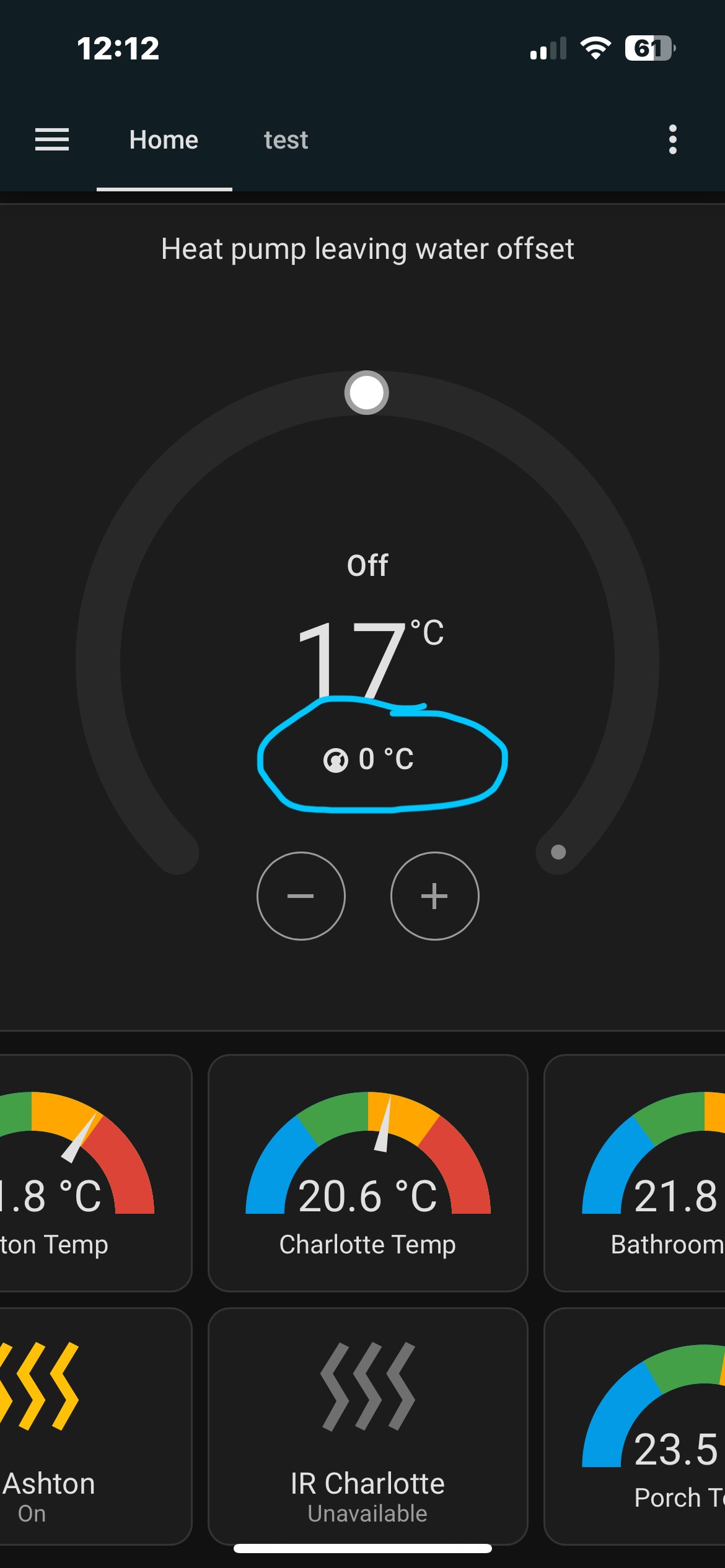

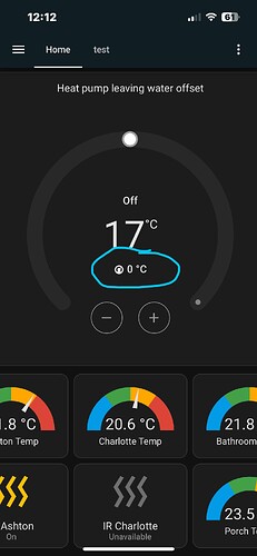

**Post date:** [25 September 2025 11:14 UTC](https://community.openenergymonitor.org/t/beyond-weather-compensation-daikin/29152/9 "2025-09-25T11:14:42Z")

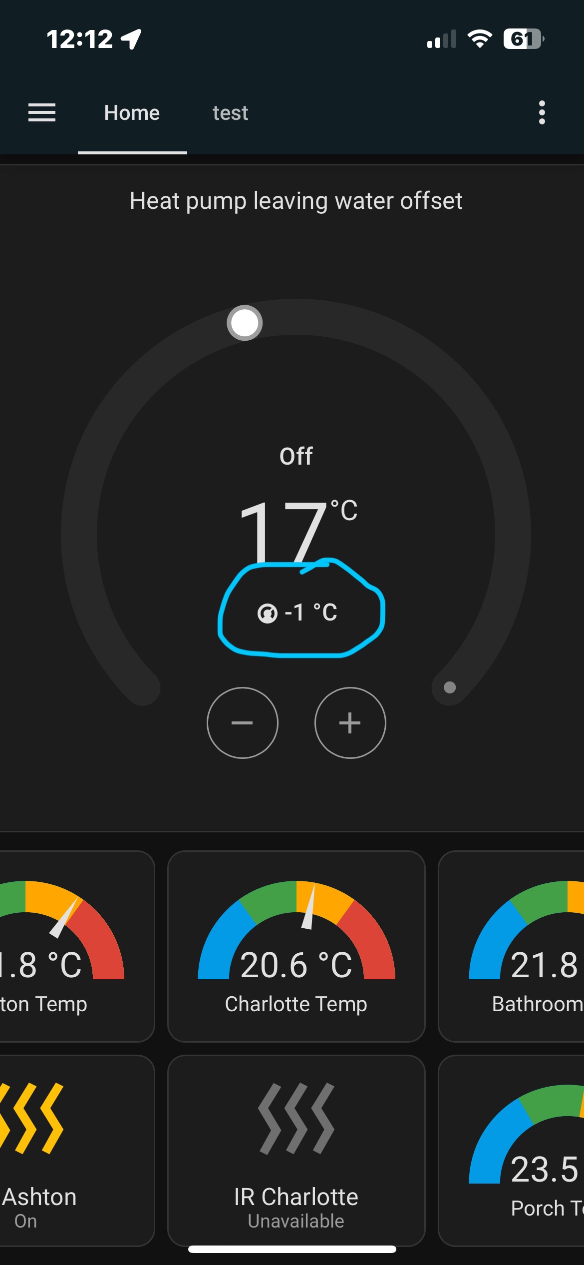

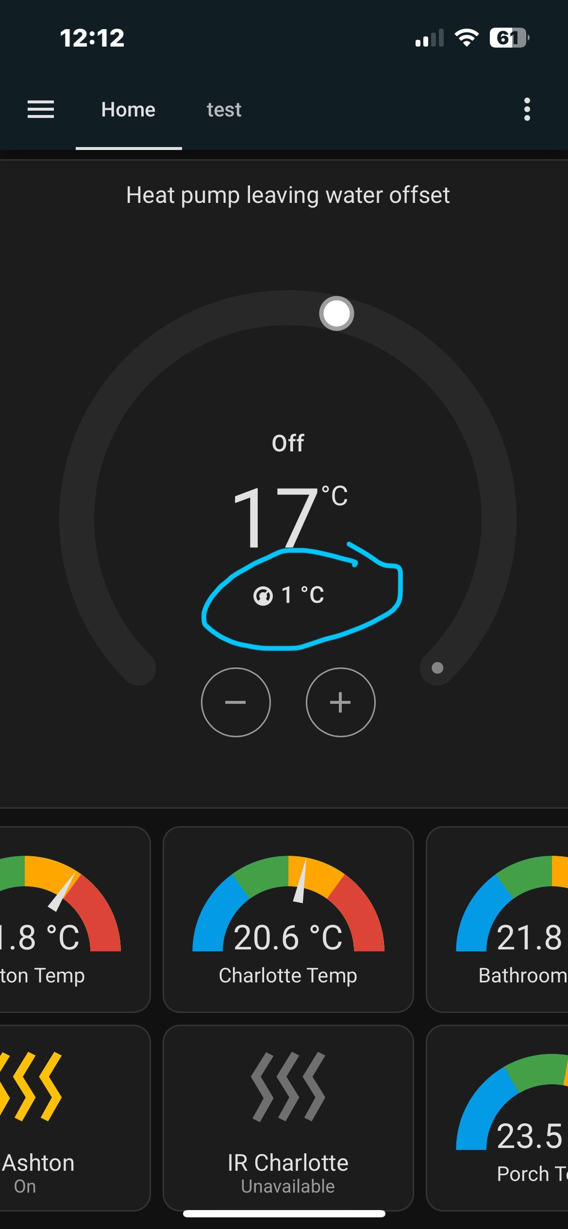

This is how it looks
 ![IMG_9749](https://community.openenergymonitor.org/uploads/default/original/3X/b/2/b226e69cd0cab8950b24a4bfa8d8d78d32022840.jpeg)
Above is direct on weather curve
Below is if the home temp un-expectantly increases and 1 degree LWT below WC
 ![IMG_9747](https://community.openenergymonitor.org/uploads/default/original/3X/7/0/70b1f4222a3b6f798abacda97fae855afd56efe8.jpeg)
Or if it gets to cold below LWT 1 degree above the WC ( below )
 ![IMG_9748](https://community.openenergymonitor.org/uploads/default/original/3X/0/8/08732804016fbb2b0c39b5807cc80e9d46f988c4.jpeg)
These are things which weather comp can not pick up

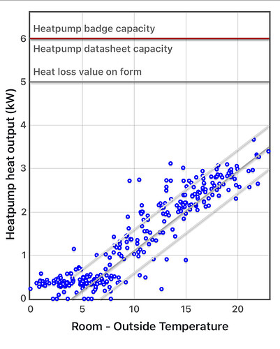

**Author:** ![Chris\_Hill](https://community.openenergymonitor.org/user_avatar/community.openenergymonitor.org/chris_hill/32/27079_2.png) [@Chris\_Hill](https://community.openenergymonitor.org/u/Chris_Hill)\
**Post date:** [25 September 2025 15:19 UTC](https://community.openenergymonitor.org/t/beyond-weather-compensation-daikin/29152/14 "2025-09-25T15:19:54Z")
My heat pump is still oversized but not as oversized as it was 9 kw originally installed
6 kw now installed
Probably should be a 5 kw

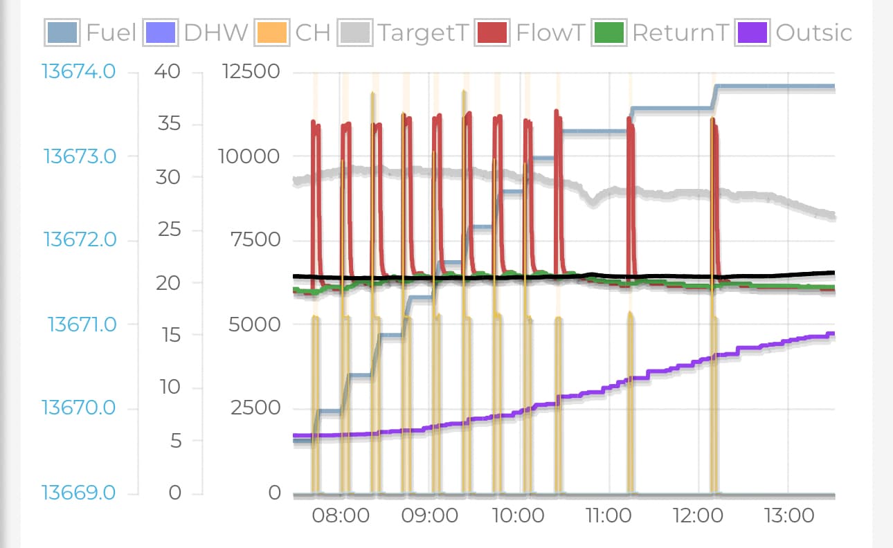

Your heat pump is not oversized. No system is ever oversized. Instead, think of it as a spare capacity that the system is not able to fully control. It simply lacks more advanced capabilities e.g. a low load control. Weather compensation is a great start but not enough. A good controller has weather + load + PID where the system respects the instructions.
 ![IMG_4873](https://community.openenergymonitor.org/uploads/default/original/3X/b/8/b85aeaf019fd70ab6e51bca09124a81be9afd51d.jpeg)
The grey line is the target flow (WC + Load + PID). Cycles are controlled carefully, with error less than 0.4 C on average.
That V shaped dip happened while someone was hoovering 😊

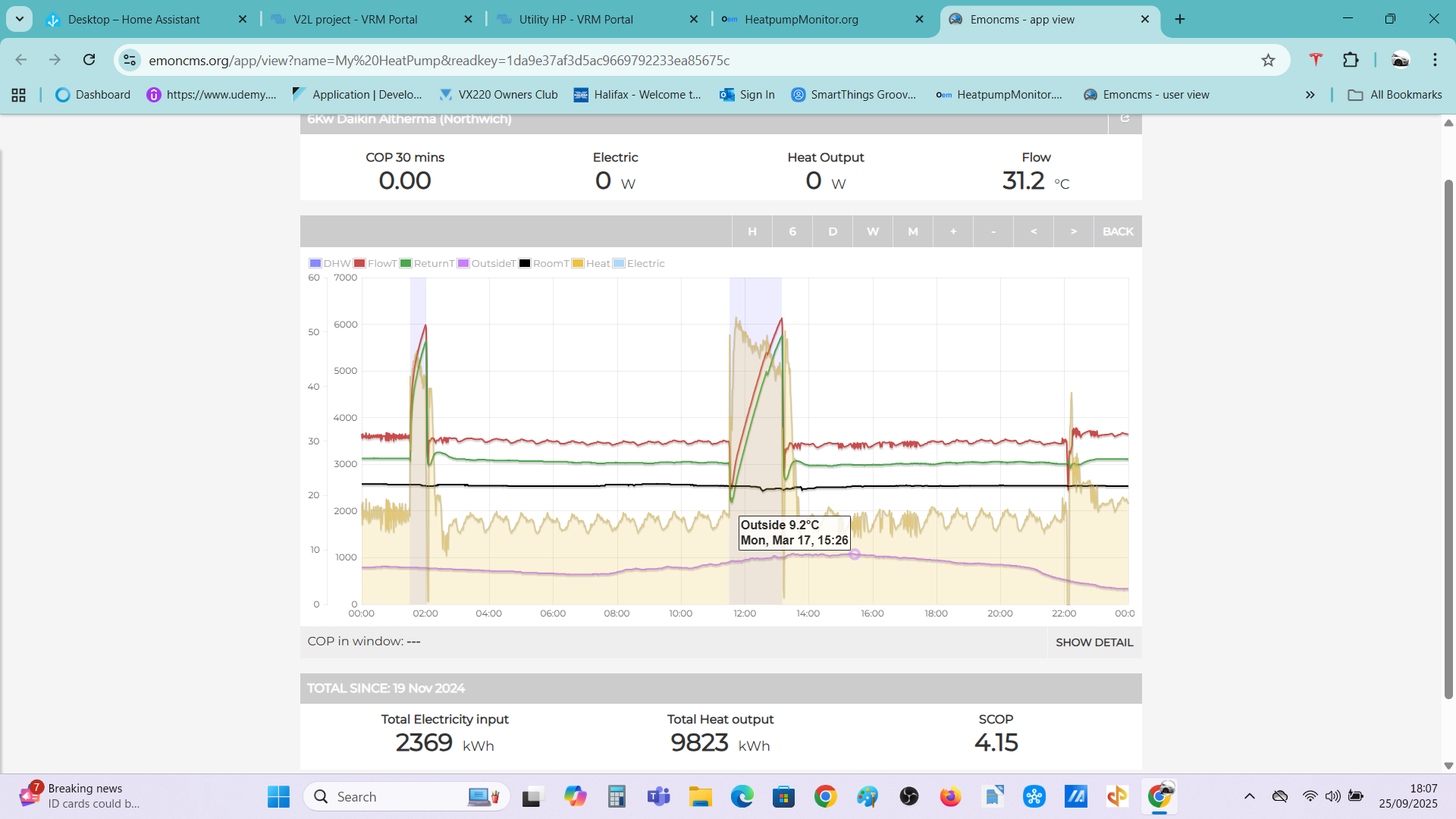

**Post date:** [25 September 2025 17:11 UTC](https://community.openenergymonitor.org/t/beyond-weather-compensation-daikin/29152/16 "2025-09-25T17:11:20Z")
![image](https://community.openenergymonitor.org/uploads/default/original/3X/a/9/a90fcae2f305e00c52adb8d03acc47089923e67e.png)
typical cold day , like i mentioned earlier only have over heating issue if we have lots of people in the home or kids going mad on Xboxes or we get a sudden burst of sun causing solar gain
this offset keeps internal temps where we prefer them , just moving of the WC target by a degree or two either way

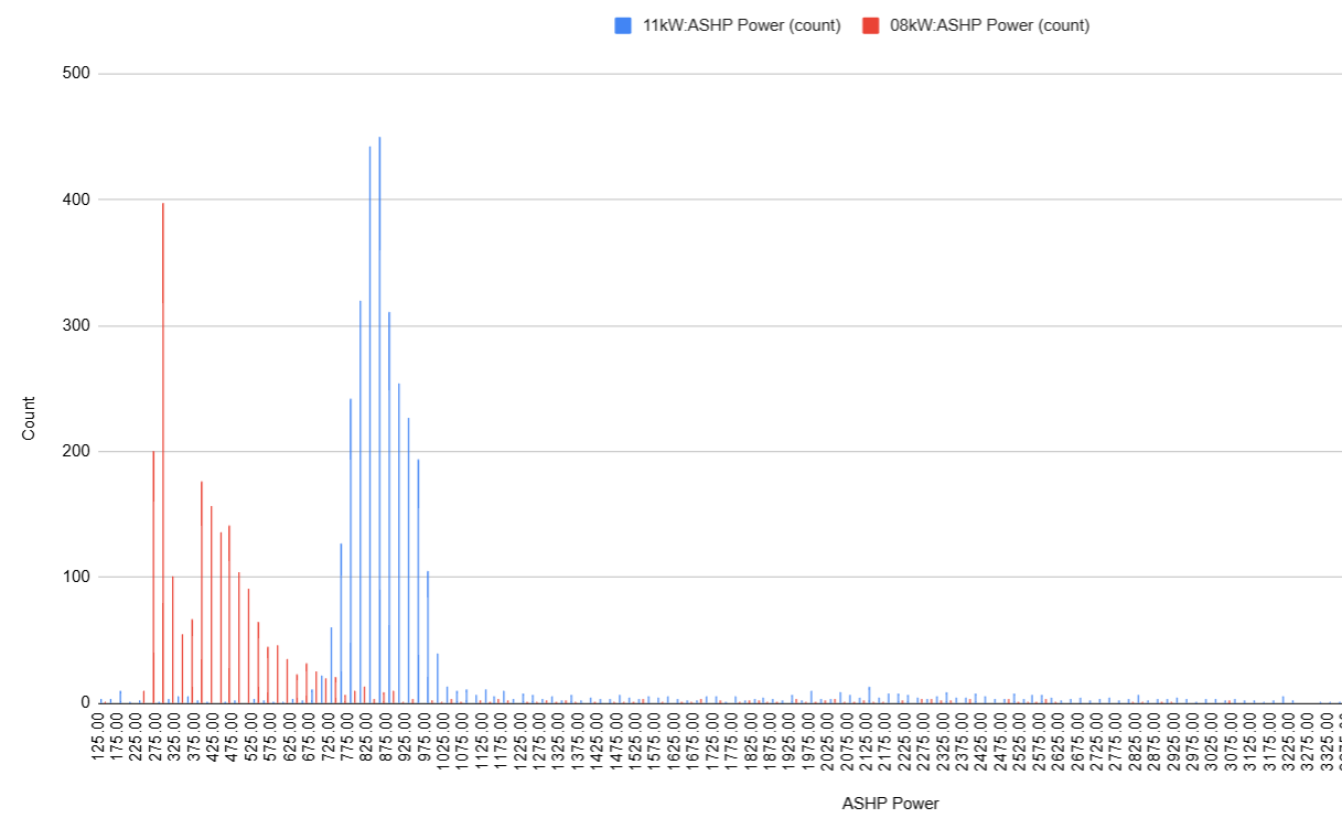

**Author:** ![Mld](https://community.openenergymonitor.org/user_avatar/community.openenergymonitor.org/mld/32/31750_2.png) [@Mld](https://community.openenergymonitor.org/u/Mld)\
**Post date:** [25 September 2025 17:31 UTC](https://community.openenergymonitor.org/t/beyond-weather-compensation-daikin/29152/17 "2025-09-25T17:31:23Z")

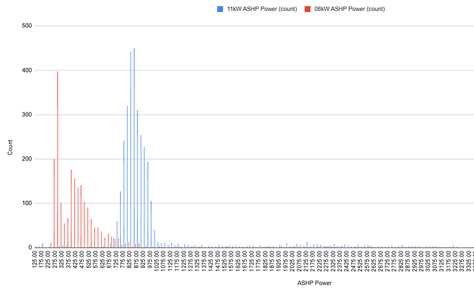

I originally had an 11kW but had it replaced with an 8kW. The 11kW was oversized and produced too much heat for the house as it could not modulate down low enough to match the house heat loss, this made it difficult to manage.
Its most clearly seen in these power consumption charts. Blue is the old 11kW and red is the 8kW that replaced it. The 11kW was pretty much only ever running at its minimum electrical input, meaning it couldn’t vary its heat output by modulating up and down.
 ![image](https://community.openenergymonitor.org/uploads/default/original/3X/5/0/5000d0c8b275a28f55d9b7cced77df55bc7173c4.png)
