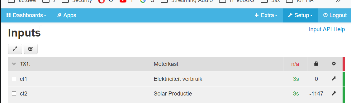

My **Inputs** are:
 ![image](https://community.openenergymonitor.org/uploads/default/original/2X/7/7961b8a44cf36f3a9ce1a2944b14e95a17b663d0.png)

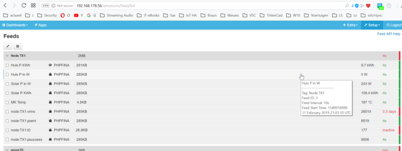

My **Feeds** are:
 ![image](https://community.openenergymonitor.org/uploads/default/original/2X/e/e36c1be9cbd19f4f45c914fe85a4414950d4424c.png)

What i don’t understand is why on this sunny day, and use hardly use any electricity, i get these negative readings. (Watch the last positive peaks are from my oven which i switched on for a Lasagna. 🙂
An other concern ragards the **Inputs** page. I don’t see readings coming in there for mu house usage in W. How can i explain this while the graphs are giving power usage?! Confused!

> [@deltabert](#):
> But in the feeds page i see for t0 = 187.
That is 18,7°C. We only send integer numbers, so multiply by 10 to send the number. You must add a process on the input page to divide by 10 before you send the value to the Feed.

One other question still… In the **Inputs** I only sometimes see a value by ct1 (so just -856), but most of the time there is only the value 0.
Is there an explanation for?
Do you have a programmer? If you have, check that the emonTx is sending valid readings every 10 s. Does the time still update when it shows ‘0’? It appears to do so from your screenshot. If it does, it means that it had received the value zero, and not no value at all.
