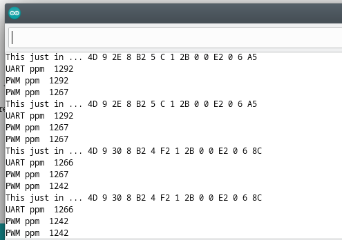

here the basic UART/PWM sketch done on a esp8266 platform

the PWM out put a little faster then the UART but the output are roughly the same
![uartco2](https://community.openenergymonitor.org/uploads/default/original/3X/2/e/2ec4ffbf12a2e56fe4a1a5fe889dccbe89f25066.png)
the CO2 levels are a bit high due to the fact I am basically breathing right next to the device. - next to add in the particulate sensor that should be here in the next couple days for a better home air quality sensor
