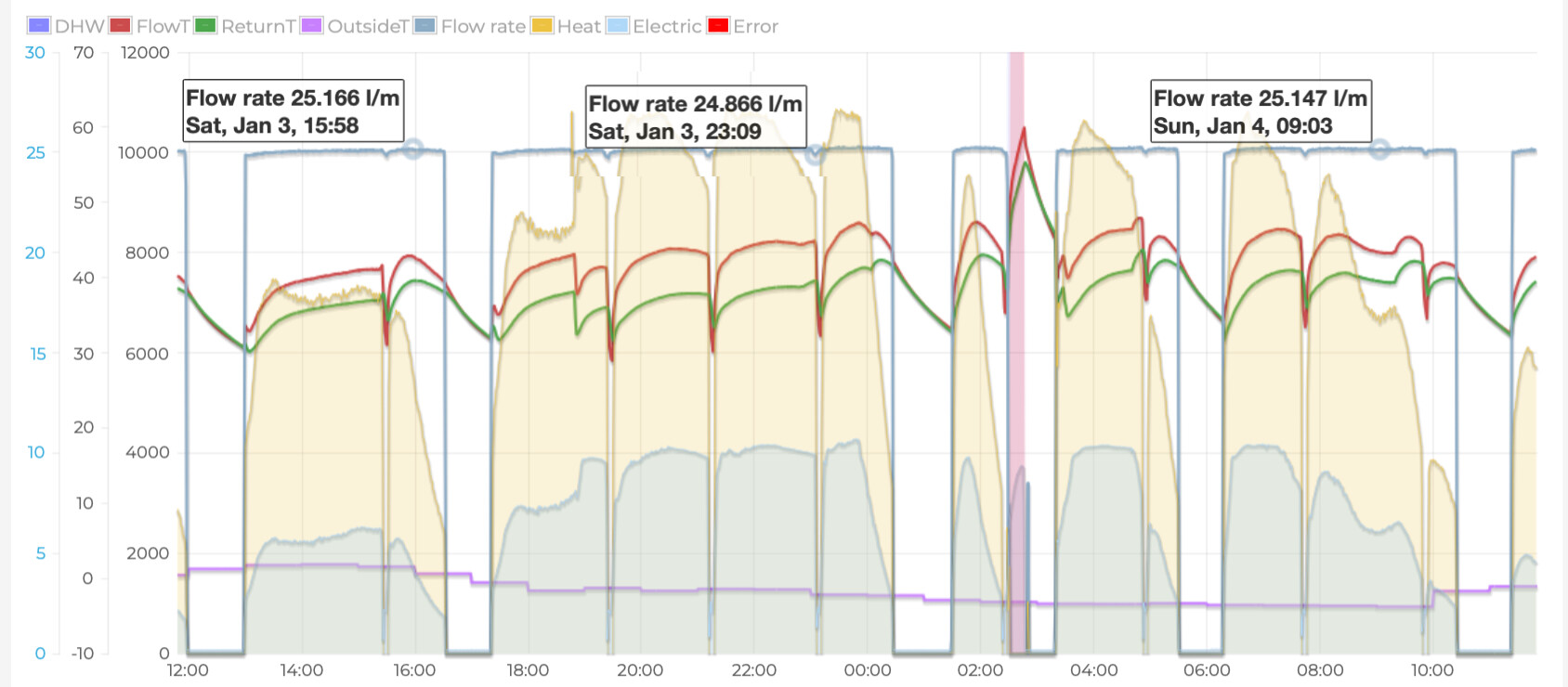

The Axioma Qalcosonic E4 heat flow meter in a newly installed heat pump + EmonHP Level 3 Monitoring kit is providing constant flow rate readings in a pumped variable speed flow.
From time to time the system circulating pump becomes very noisy and in wondering why I noticed that whenever the pump was running the flow meter was reporting a near steady 25 litres per minute flow rate regardless of the pump’s variable running speed. I had expected to see variable flow rates.

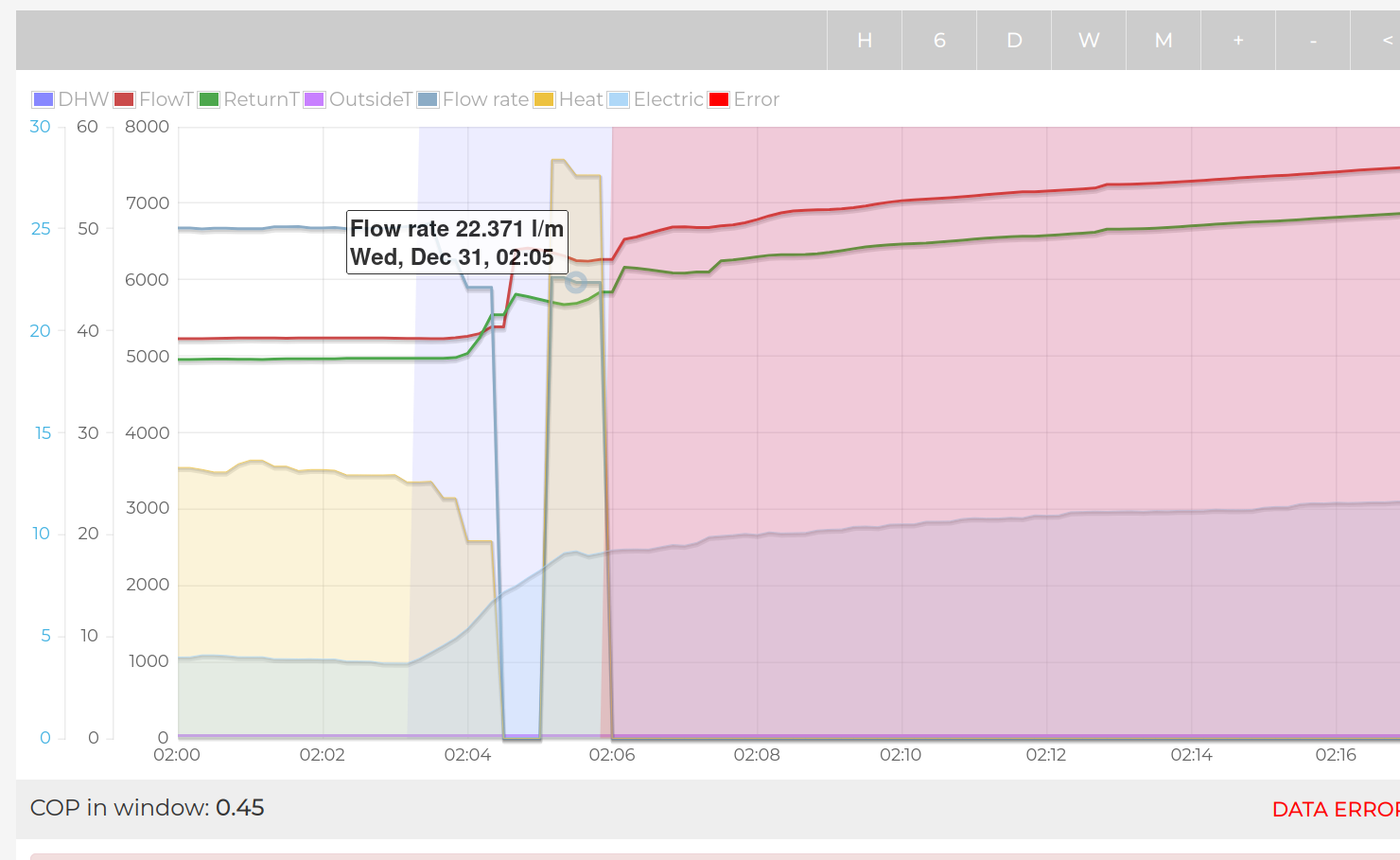

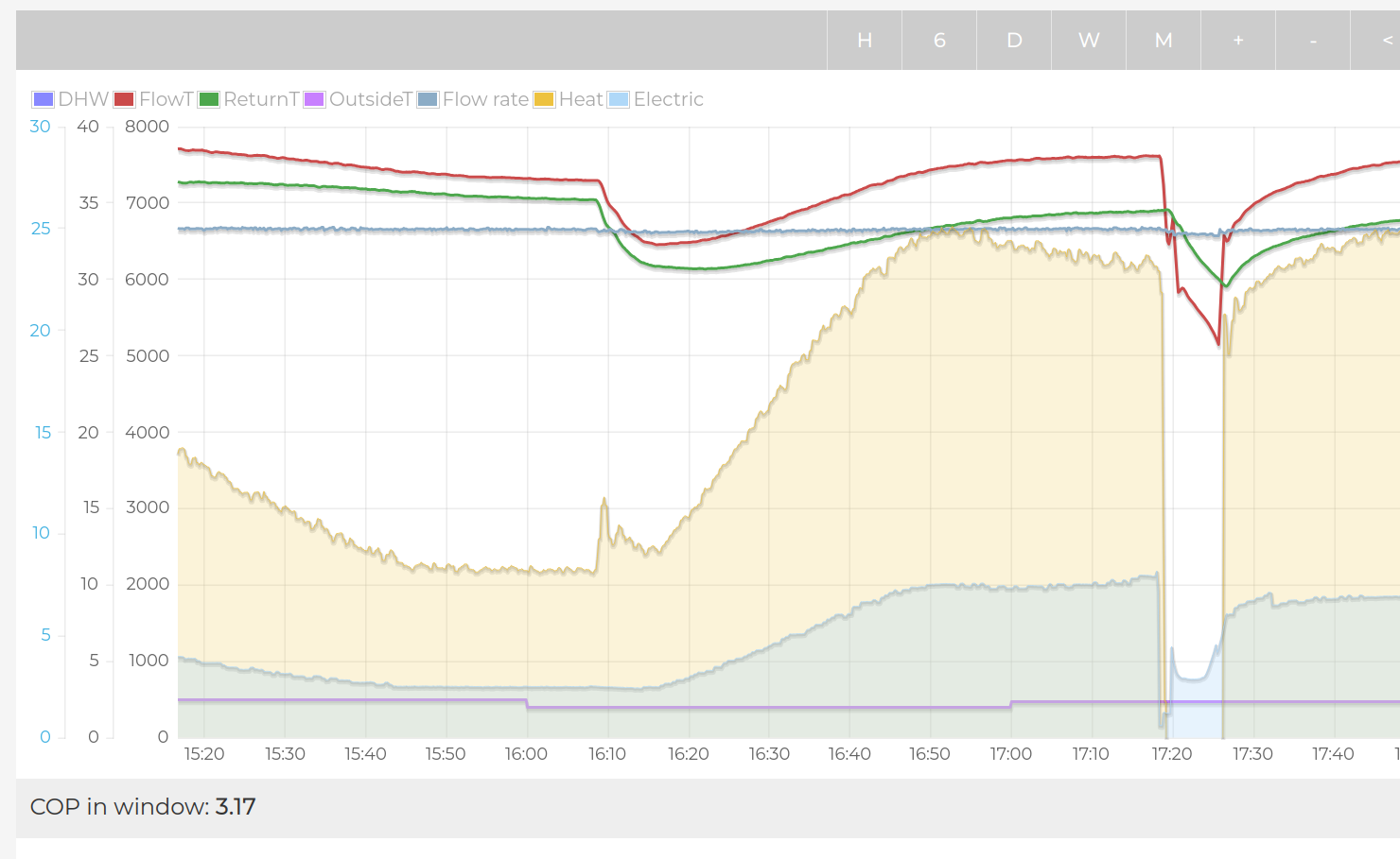

Hello @Showsley the readings look ok to me, perhaps the heat pump is not actually varying the flow rate, hence the stable flow rate.
We also see here DT widen as heat output increases, it all looks consistent with the non varying flow rate your seeing:
also at the start of the DHW cycles there is often a little blip where it registers heat output while on hot water and it’s measuring a different flow rate at this point consistent with different pressure drop across the DHW tank compared to the emitter system, again suggesting the axioma is reading the flow rate correctly - apart from when it’s in air error of course!
Thank you Tristan. That is really helpful as it would seem to rule out an error in the Axiom flow readings.
The Axiom meter is monitoring flows to the pump that’s being controlled by Pulse Width Modulation provided by the Stiebel Eltron controller. Its changing noise level appears to confirm that it does change its speed (I’m trying to cure the problem of its excessive noise at certain times). I’m perplexed why flow rates aren’t changed according to the pump’s noise/speed.
