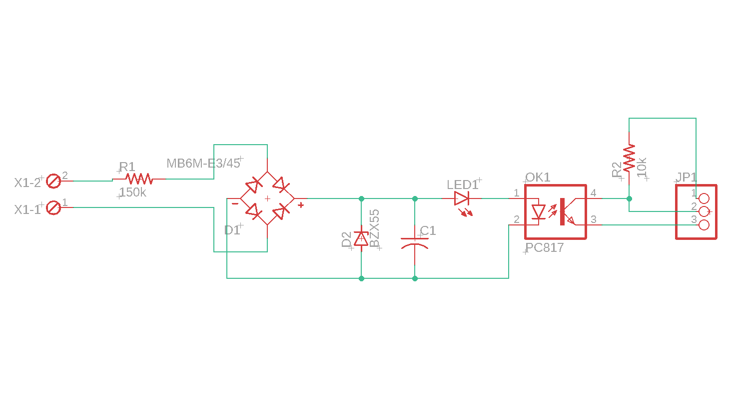

I’ve been logging mains on/off with emonCMS for a while now, monitoring various pumps alongside the temperatures around our thermal store - boiler, solar hot water, UFH, etc..
I am using a Raspberry Pi Pico board (with WiFi) and mains voltage sensing modules connecting to my local emonCMS system using MQTT - it’s been working well for months now. In order to be able to see the various on/off states on the graphs (when they can be on top of one another) I ‘adjust’ the values slightly, so the first displays as -0.15/1.15, the second as -0.10/1.10 and the third as -0.05/0.05.
I’m in the process of taking my experimental version and building one that I can install in the wiring centre - it will use modules that are mounted on the DIN rails, bought from Ali Express:
The code is written in Micropython, I’m happy to let anyone have a copy if it’s of interest.
Yes, the pulse input is available on the emonTH, it’s just a GPIO pin and there’s 3V3 available as well. The emonTH would be suitable if they are spread out, but given they are all close together something cheaper and more compact (like @mcockerell’s nice setup) would be better.
Each mains sensor uses a single GPIO input (plus Vcc & Gnd); if the existing kit has enough unused inputs then you could probably do without the Pico by modifying the emonTX code.
Also, although I’m showing a single channel mains sensor I’ve been using a 3-channel unit while experimenting (I could only find single channel DIN-mounted units). A quick search on eBay for ‘mains sensor arduino’ will show you what’s available (1-channel, 3-channel & 8-channel).
One thing to bear in mind - with a pull-up on the input, the sensor reads low for ‘On’, high for ‘Off’!

Me too, the mains sensors are built from mainstream parts including an optoisolator with 5kV rms isolation - here’s the circuit diagram:
I’m doing a lot more than just digital inputs with the Pico that I am running; it is also reading a number of temperatures in and around the thermal store using DS18B20 One-Wire sensors, and processing the logging data from our solar hot water controller which is received over RS-485.
