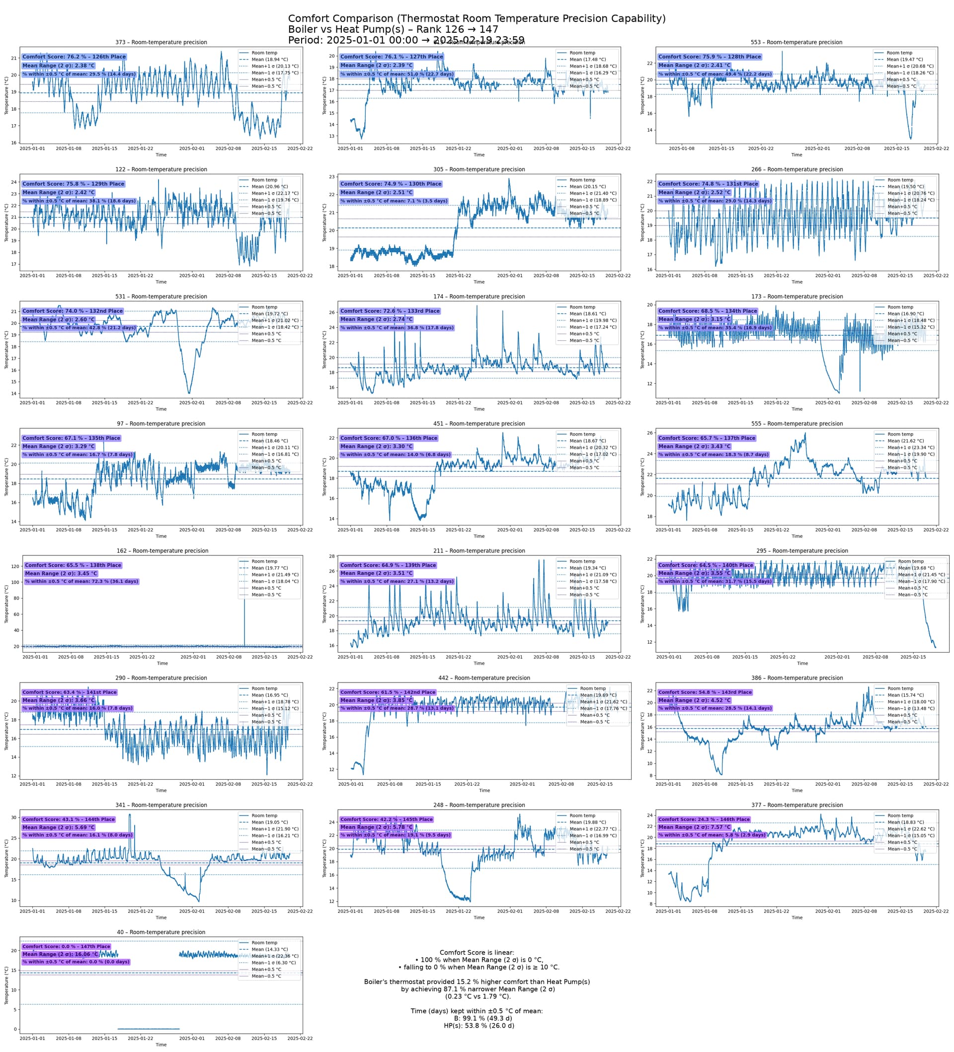

**Author:** ![critictidier](https://community.openenergymonitor.org/user_avatar/community.openenergymonitor.org/critictidier/32/29731_2.png) [@critictidier](https://community.openenergymonitor.org/u/critictidier)\
**Post date:** [16 April 2025 22:43 UTC](https://community.openenergymonitor.org/t/add-new-metric-comfort-score/26976/33 "2025-04-16T22:43:11Z")
@Andre_K @Timbones @TrystanLea
How about using standard deviation to calculate the comfort score for any selected period of time? 2σ as shown in the image gives a way to calculate a value without having to know what the target room temperature is. A value of 2σ = 0°C would be 100%, and let’s say 2σ = 10°C would be 0%. Then, anything between would give us an actual score?
 ![collage](https://community.openenergymonitor.org/uploads/default/original/3X/3/f/3f7d767af9f2262c99c481f4b07a8bbb22b62cb4.png)
**Post date:** [18 April 2025 19:29 UTC](https://community.openenergymonitor.org/t/add-new-metric-comfort-score/26976/34 "2025-04-18T19:29:57Z")
Here’s the full **Comfort Score** ranking. The data below is for the period “ **2025-Jan-01 00:00** ” --end “ **2025-Feb-19 23:59** ” which was the coldest period for many. Some heat pumps are missing as they didn’t have \> 85% roomT data available for the selected period.
@TrystanLea @Zarch @Timbones @Andre_K @UrbanPlumber
