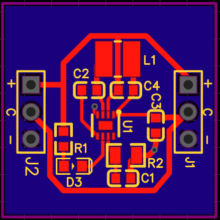

**Author:** ![hitech95](https://community.openenergymonitor.org/user_avatar/community.openenergymonitor.org/hitech95/32/11716_2.png) [@hitech95](https://community.openenergymonitor.org/u/hitech95)\
**Post date:** [8 June 2020 20:11 UTC](https://community.openenergymonitor.org/t/actibms-discussion-about-the-diy-active-balancer-bms/12445/62 "2020-06-08T20:11:25Z")
No, I don’t have it
 ![immagine](https://community.openenergymonitor.org/uploads/default/original/2X/3/3efef1440cf174cf1cfae859548dae82871b9bf7.png)

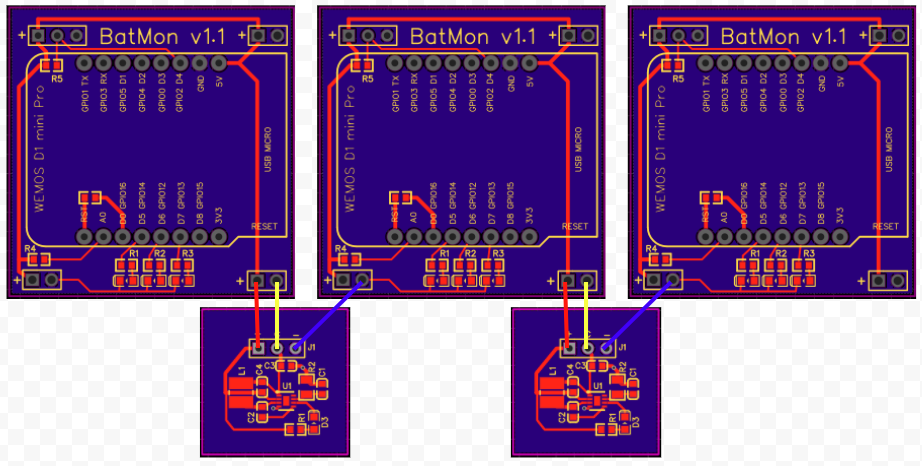

**Post date:** [30 June 2020 11:09 UTC](https://community.openenergymonitor.org/t/actibms-discussion-about-the-diy-active-balancer-bms/12445/66 "2020-06-30T11:09:02Z")
@stuart Can I ask you what are the latest changes on your BMS? I’ve seen that you maede a lot of new revisions. But I was not abel to find what are the improvements you made.
@G33RT @willy I’m working on a new idea/prototype without the ETA3000 but using an Synk buck covnerter instead. with a PWM DAC feedback using the uC. (this is a quite rushed process I have to order some other important boards so I create a single order for all the components, etc.)
It is based around this concept:
> **[Low Cost Active Battery Balancer](https://www.afdhalatifftan.com/2017/06/low-cost-active-battery-balancer.html)**
> Afdhal Atiff Tan. My blog mostly related to my experiments.
@G33RT Thanks fot the NXP document, I had missed that. We will see what we could do.
> **[AN4428.pdf](https://www.nxp.com/docs/en/application-note/AN4428.pdf)**
> 866.65 KB
So far the goal is:
1. Make an working BMS based on the ETA3000 prototype
2. Design an alternative BMS with only discrete parts.
This one must have the following requirements:
- HW cutoff to protect the cells from discharge. (In case only once cell is connected & or HW fail?)
- Monitor the cell at pos N and N+1 to calculate the balance direction (we might need a couple of opamps)
- Use a proper balance profile CC + CV (To be constant current we might have to create a calibration table, measuring pulsing current(bidirectional) is quite hard. We could use the formulas from the NXP application note even if I cannot figure out where they came from. (We must modify them with the parameters of the DC buck controller we choose for the project, so an practical test is a MUST)
\*\* Due to HW limits balancing can start only above a precise voltage, thisis due to the opamp power rail limits
BTW naming suggestions are still open! I just renamed the pject due to a hurry but we could create a pool for that.

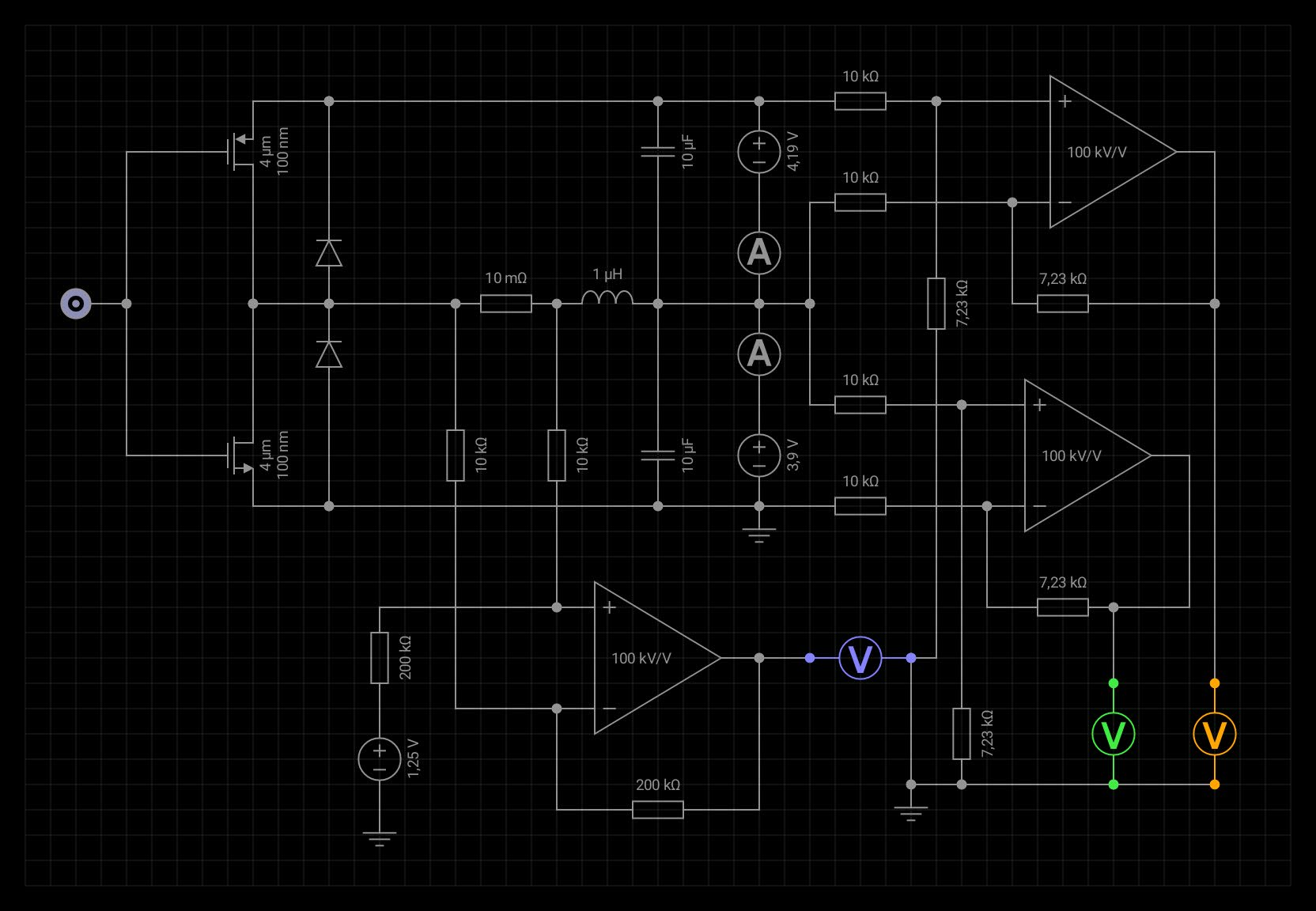

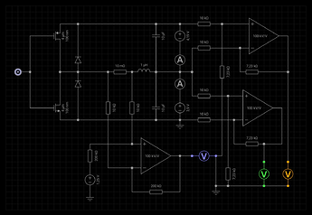

Possible solution? How about a multi phase DC DC converter used to push pull energy from adjacent cells?
 ![immagine](https://community.openenergymonitor.org/uploads/default/original/2X/3/3850f2ef9f838f851291d32403fc16b244010ae0.png)
Lots of feedback is needed for CC/CV phases during balancing.
Anyway, we might have to go with a more strong STM32 chip. We need a higher PWM frequency than the one that an Atmega can make at 8mhz clock. (8mhz is due to the clk vs voltage supply)
Suggestion on how to read the currents and voltages are welcome. I think that a common voltage divider for the cel + 1 is not enough, we might need an diff op amp system. Also current measurements needs a diff op amp with a offset, (current can be bidirectional).
Any ideas are welcome!

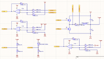

**Post date:** [2 September 2020 20:58 UTC](https://community.openenergymonitor.org/t/actibms-discussion-about-the-diy-active-balancer-bms/12445/70 "2020-09-02T20:58:05Z")

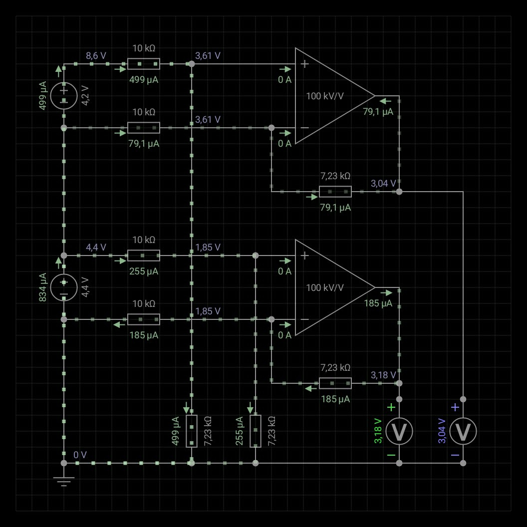

To have an active BMS balancer you have to know the voltages of the cells around the cell n.
This in practice it means having a BMS that monitor all the cells.
So why having 2 system? The protocol has been inplemented to be compatible with the DIY BMS one so you could mix at match DIYbms and the “acti” one. My original board have both active and passive balancer, only SW capability is the limit.
I think that I’ll keep this project for a long/idefinite hold. I’m facing some issues on designing a decent circuit for a complete DIY solution without having to use a specific chip. (ETA3000)
If I will have more time I will try to create some other simulations of the circuit. I’m not an EE, i just used to study electronic at school. Some issue I’m facing are quite hard to trace and I don’t know how to proceed.
The current state of the actiBMS:
 ![immagine](https://community.openenergymonitor.org/uploads/default/original/2X/9/9f9500d0e83cd604ffa2dbd64a821caecaf725f2.jpeg)
 ![immagine](https://community.openenergymonitor.org/uploads/default/original/2X/e/e9ecb65fa6f54f532e145187f8d7526a2ac4297f.jpeg)

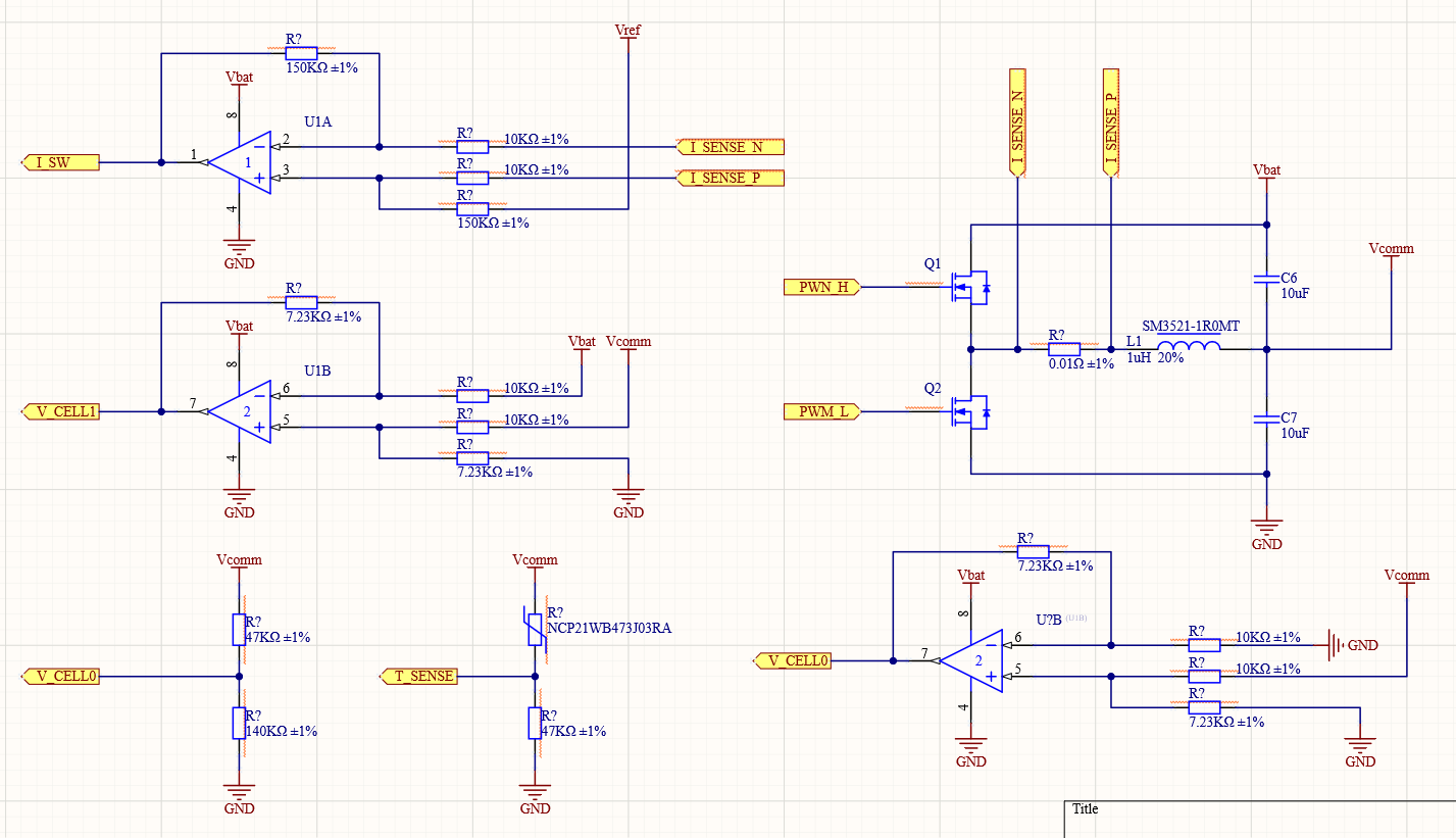

Thoose are the latest design infos I have for the complete DIY version:
 ![immagine](https://community.openenergymonitor.org/uploads/default/original/2X/2/23c32d4955238fd0f65312ab865119c96af63e7c.jpeg)
 ![immagine](https://community.openenergymonitor.org/uploads/default/original/2X/6/6ce173371ec2b17cf369c4523a0e288d169852e4.png)
 ![immagine](https://community.openenergymonitor.org/uploads/default/original/2X/d/d88094a574e58fa01a8ccc0d1a6d7442b608ccf7.png)
For a compact solution the pair NCP81155+NTLLD4901 with a STM32 is still a good solution, the issue is the op amps supply rail limit and the passive network current cosumption.

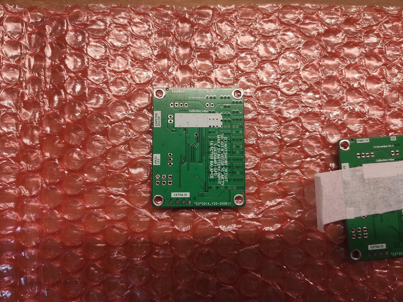

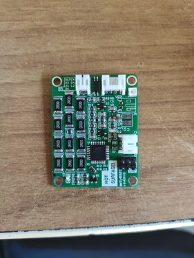

**Post date:** [3 September 2020 18:26 UTC](https://community.openenergymonitor.org/t/actibms-discussion-about-the-diy-active-balancer-bms/12445/71 "2020-09-03T18:26:13Z")

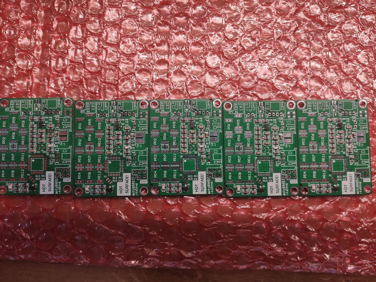

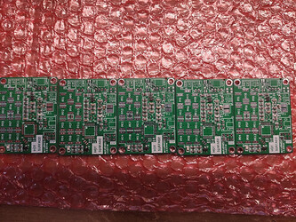

This is the corrent assembled board unfortunately due to a error in the schematic that I’ve missed I had to create a bodge wire.
 ![IMG_20200903_170055](https://community.openenergymonitor.org/uploads/default/original/2X/5/531f9187336a52fbbaf762317b6c13336fc9adc0.jpeg)
Initial sw troubleshooting is ok:
Blink work fine, isp upload also. Fuses burned correctly. External resonator mostly ok.
probably the resonator need rework (looks like that the mcu sometimes get stuck if I touch and press the board)
Next step is check the addressable led and having a debug uart available.
Than I’ll have to wait the ETA chips. I hope they will come in a few weeks.

**Post date:** [3 November 2020 13:44 UTC](https://community.openenergymonitor.org/t/actibms-discussion-about-the-diy-active-balancer-bms/12445/76 "2020-11-03T13:44:52Z")
Hi,
The ETA300 looks like a very simple component to do active balancing,
I’ve build a 2 cell balancer that is yet to be tested and ordered, if you would like to
expand the current system you are using with an active one it might be a good idea
to place this one on top just like @hitech95 proposed.
The project is public on EasyEDA and feel free to comment.
[https://easyeda.com/Gurk/activeballancer](https://easyeda.com/Gurk/activeballancer)
The plan is to build following module per cell and place a balance module between each cell.
[https://easyeda.com/Gurk/celmon](https://easyeda.com/Gurk/celmon)
Like so:
 ![image](https://community.openenergymonitor.org/uploads/default/original/2X/b/be72c44d5a39e55df1c650f5086d5b661b4582e3.png)
The Balancer is configured to be at 2A balance rate.
I will try to stack multiple balancers to go to 4/6/8 A for bigger packs.
Each cell monitoring board has a webserver running that returns a json object with the bank number
cell number, cell temperature and the voltage.
after each data request you send the Wemos to deepsleep.
The wemos will know when to wakeup because you give the read interval with the data request.

The build with the ETA300 is based on an example to integrate the chip on the ETA datasheet.
And the scematics of @hitech95
![image](https://community.openenergymonitor.org/uploads/default/original/2X/5/545f5700608d2a0c1feb3c441a77a93a638c99cb.png)
The result is this:
![image](https://community.openenergymonitor.org/uploads/default/original/2X/6/637ee597e55bd07990a167ed5f1b8b382f21b612.png)
Based on the datasheet the balance voltage is quite accurate
![image](https://community.openenergymonitor.org/uploads/default/original/2X/7/7abd57cc692ff3090abf6b307014930feb9fd2c0.png)
