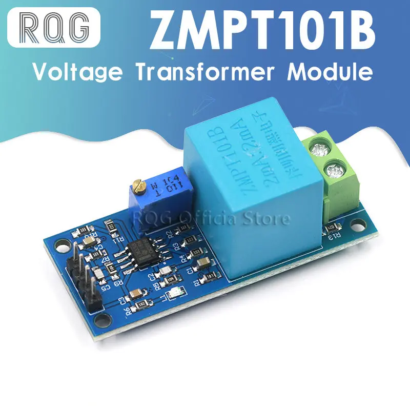

Thanks. I am using EmonLib and the voltage values seem to fluctuate a bit more than expected. For measurement of the voltage, I have installed these devices:
> **[0.78￡ 5% OFF|Active Single Phase Voltage Transformer Module Ac Output Voltage...](https://www.aliexpress.com/item/1005001499454445.html)**
> Smarter Shopping, Better Living! Aliexpress.com
In my other module which measures single phase PV power output with hard coded voltage value of 238V everything seems more stable and inline with my AC meter.
**Post date:** [16 October 2022 20:26 UTC](https://community.openenergymonitor.org/t/3-phase-3-wire-monitor-using-esp32/21493/12 "2022-10-16T20:26:07Z")
If that ZMPT101B uses the same circuit diagram and the same components that I saw and analysed - and it appears to be the same, it is not suitable for measuring real power. It introduces a very large phase shift into the voltage measurement, which emonLib cannot compensate for. Your power reading will be incorrect, possibly by a very large amount, depending on the overall power factor of your loads.
The ZMPT101 transformer **on its own** with only the correct voltage multiplier resistors in the primary circuit and the burden resistor in the secondary is fine, and it is what we are using with the new emonTx V4. The problem is someone thought it was a good idea to include an op.amp and filter; it is the filter that causes the phase shift, making it useless for real power measurements. I have written about this before, it is not something new.

Thanks Robert, that should be an easy mod - remove everything from secondary circuit except the burden resistor:) Which value should I use?
**Post date:** [16 October 2022 22:01 UTC](https://community.openenergymonitor.org/t/3-phase-3-wire-monitor-using-esp32/21493/14 "2022-10-16T22:01:39Z")
You need to calculate everything. The ratio of the ZMPT itself is 2 mA : 2 mA according to the data sheet, however the data sheet also gives the operating range as going up to 10 mA, with a 100 Ω burden. You need to look at the data sheet and what you have, and find out the voltage swing that your ESP32 expects, and choose the appropriate values for the multiplier resistor (to set the primary current) and the burden (to set the input voltage to the ADC). However, the phase error curves stop at 8 mA, so I’d suggest running at about 6 - 7 mA at your nominal mains voltage, which should keep you within the ZMPT101’s VA rating (which you get from 10 mA & 100 Ω = 10 mVA). Beware the power rating of the multiplier resistor - it’s likely to be at least 2 W.
