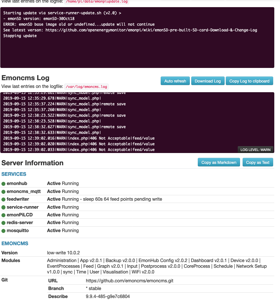

Hi All,
I have currently 2 issues:
1. I can’t update my emoncms. See screenshot attached.
2. I cannot send feeds to [emoncms.org](http://emoncms.org)
Can someone help me? I can send logs if needed, just tell me how to do so.
Thanks in advance.

On the update issue, could this be the problem
> [@emonPi Image update?](https://community.openenergymonitor.org/t/emonpi-image-update/11691/4):
> … it was my pihole blocking [raw.githubusercontent.com](http://raw.githubusercontent.com) slight_smile Edit - deleted duplicate post. BT - Moderator
Always worth trying to search the Forum using the error message in quotes e.g. “old or undefined” and checking the ‘latest’ posts (Discourse doesn,t seem to good on the ‘relevance’ IME).
**Post date:** [16 September 2019 17:17 UTC](https://community.openenergymonitor.org/t/2-issues-cant-update-emoncms-nor-send-feeds-to-emoncms-org/11940/3 "2019-09-16T17:17:17Z")
> [@jneves](#):
To help debug this issue, please attach a copy of your emonhub log file. You should be able to download from the emonhub tab in emoncms. Assuming you have followed: [emonCMS: Getting started emoncms.org — OpenEnergyMonitor 0.0.1 documentation](http://guide.openenergymonitor.org/setup/remote)

**Post date:** [1 January 2020 17:13 UTC](https://community.openenergymonitor.org/t/2-issues-cant-update-emoncms-nor-send-feeds-to-emoncms-org/11940/5 "2020-01-01T17:13:16Z")
Sorry for the very late reply. I was having an issue with the DNS.
